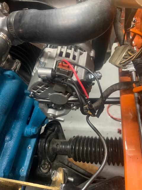

1) In image one, can someone confirm my hookups on alternator. These are the way it was on old one when i removed. However, new alternator
has bolts on side for something but i dont see anything to connect. Is it just an extra i dont need?

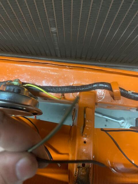

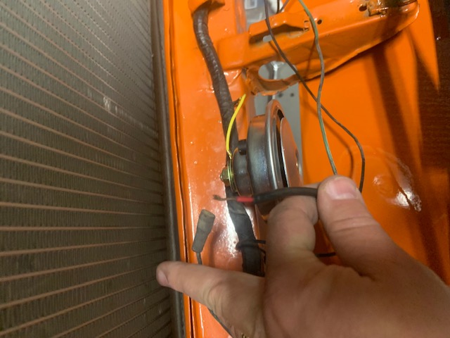

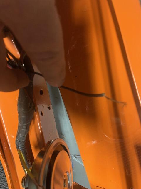

2) My new horn hookups. I have two spade connector on bottom of each horn and one yellow wire coming from each horn. So i am assuming 3 wires go to each. Not sure what wire
goes where though. Tried to take some images to show wires i have. In the middle image is a green and black wire that are long enough to go to either horn. In driver image one wire appears
to be green and other black.
any help on the horns is appreciated

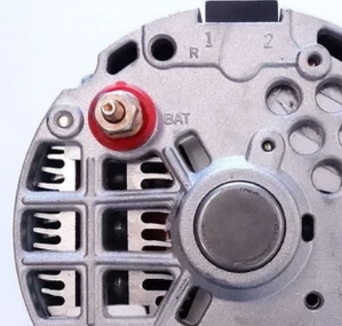

Looks like a late model alternator that he swapped pulleys on.  That extra bolt could be a mounting lug that fits a slotted bracket on a different model of car.
Here's an example of a "B" molded in to the case showing where the battery charging cable connects.  Look for those.  "E" is Earth, meaning ground.
You can also use a meter and see if the lug is grounded to the case or not.  The lug looks insulated though, more like it is the battery connection.  Better get that right before you go too far.

Thanks all. The voltage connector is connected with no problem. already had the connectors for it ready. I just looked with a flashlight and that side lug has a B, for battery
i am guessing which mean i move the white&red wire over there. The original connector is too small for that bolt so will need to
put bigger connector on. shouldnt be an issue i wouldnt think.  Didnt see any other letters like E (ground) just gonna use the one i have it
hooked up to in image.
