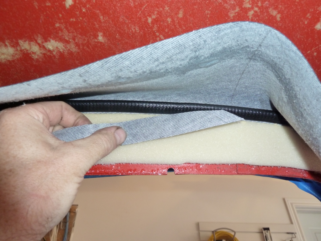

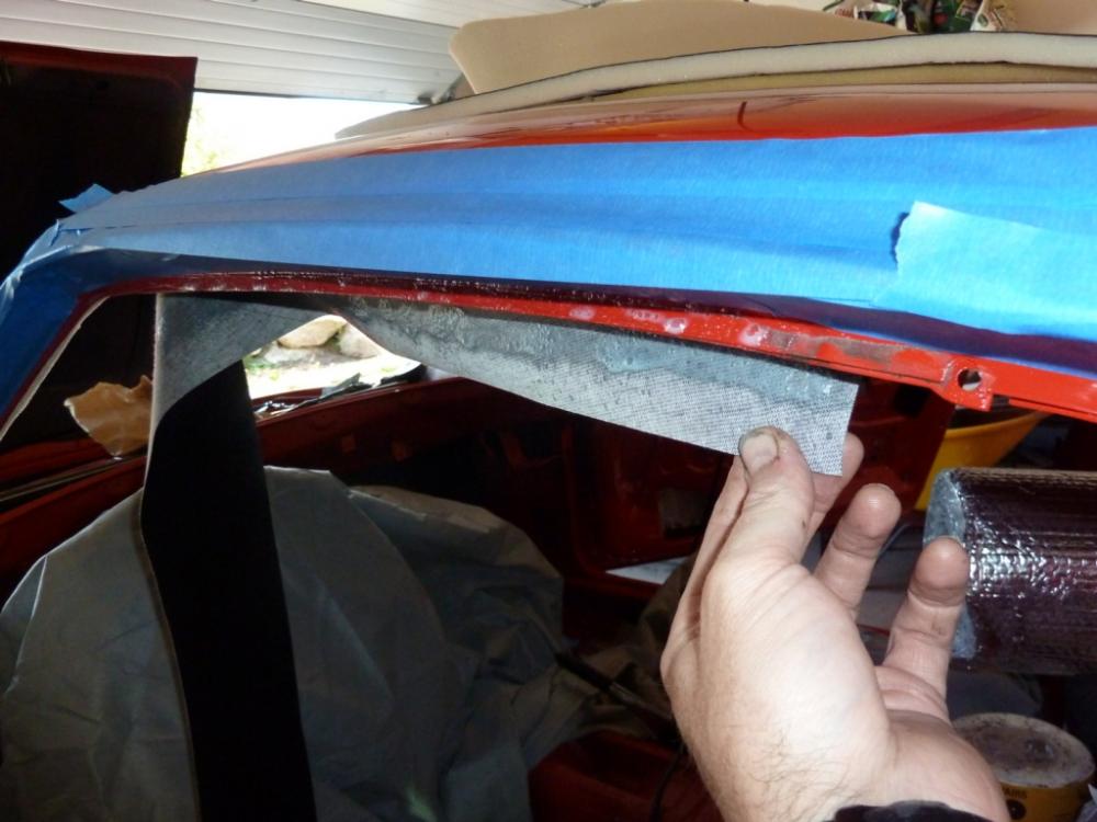

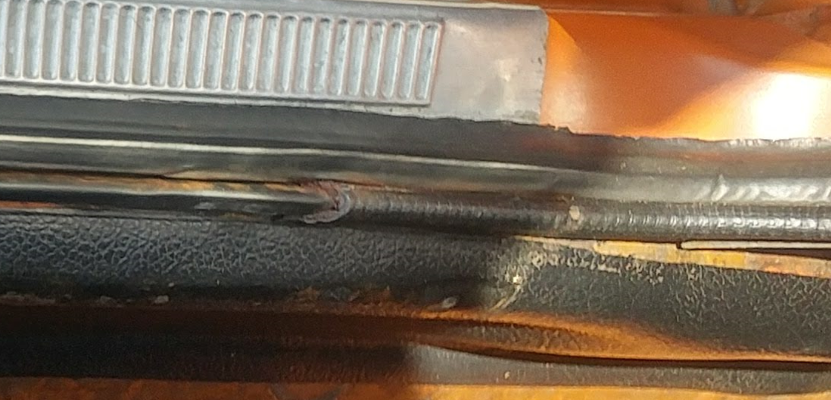

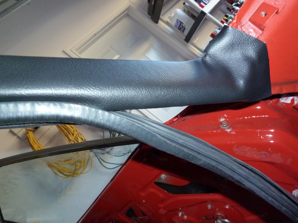

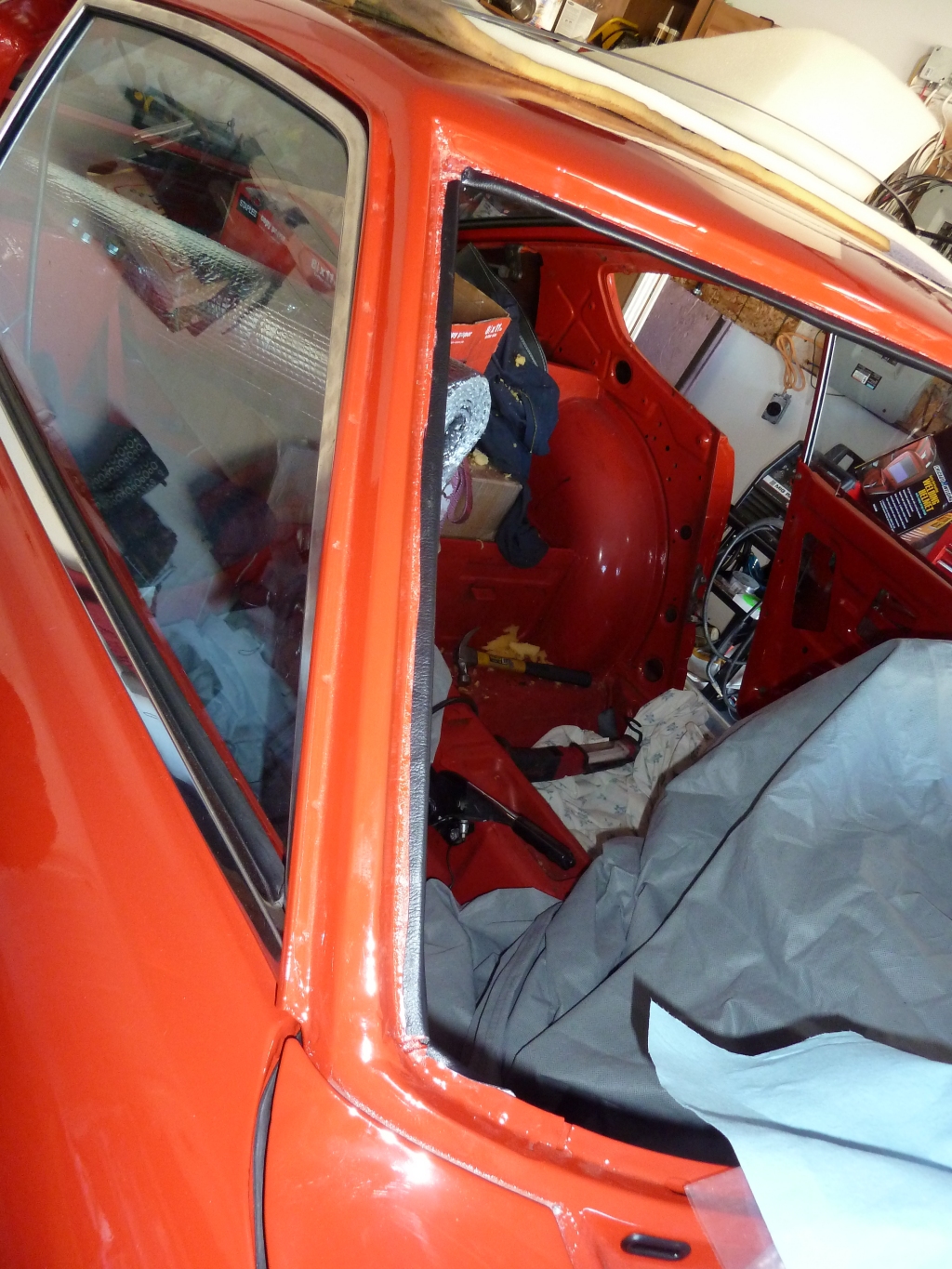

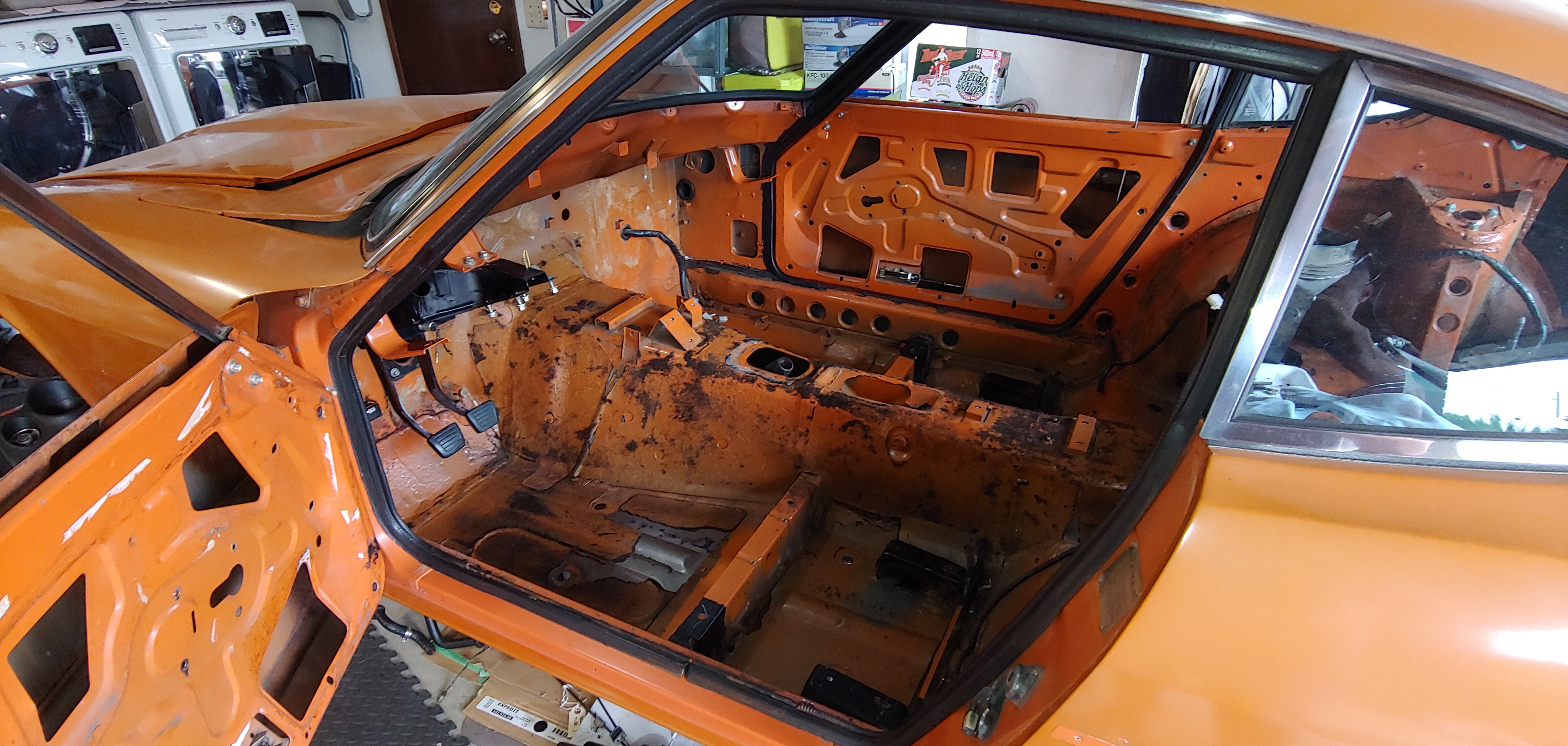

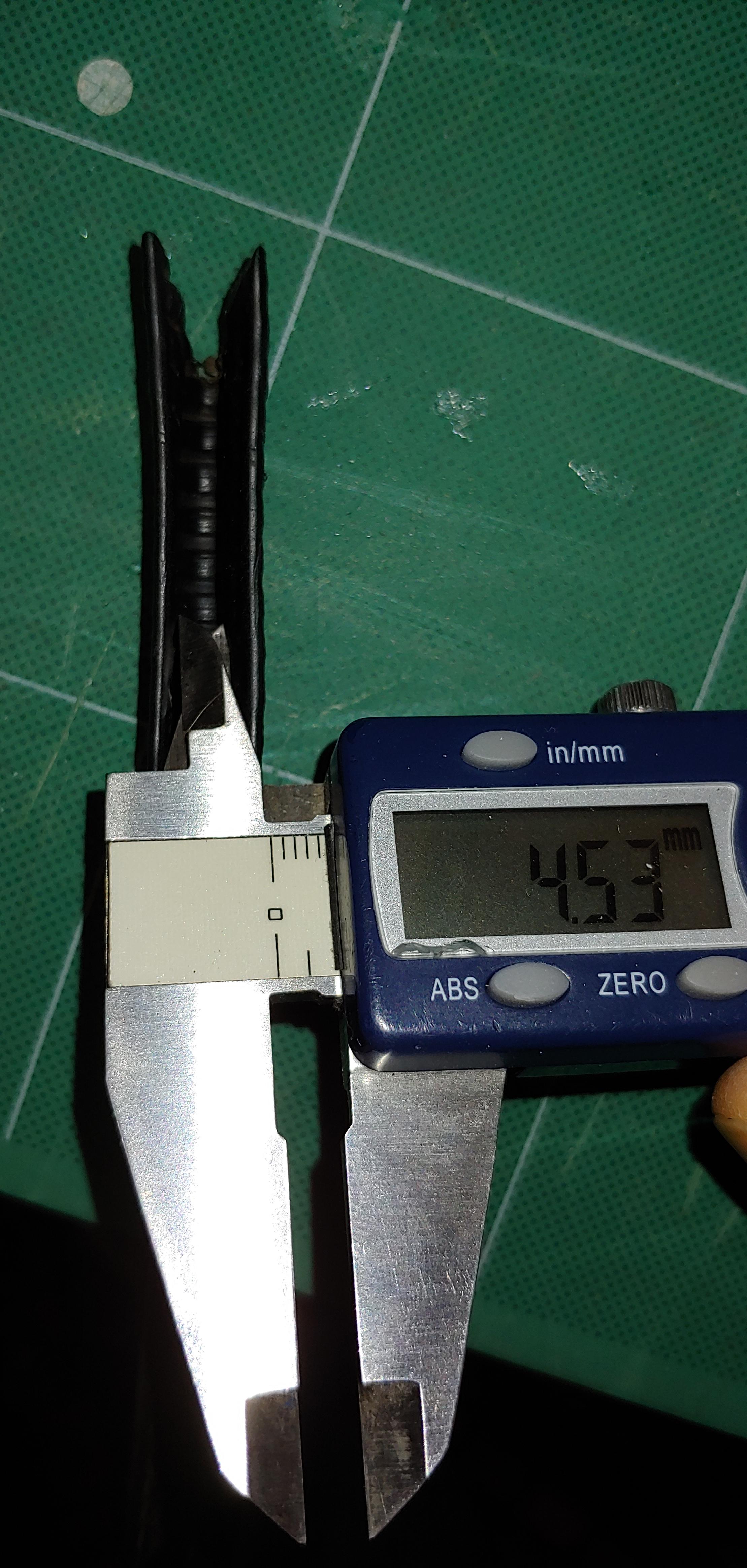

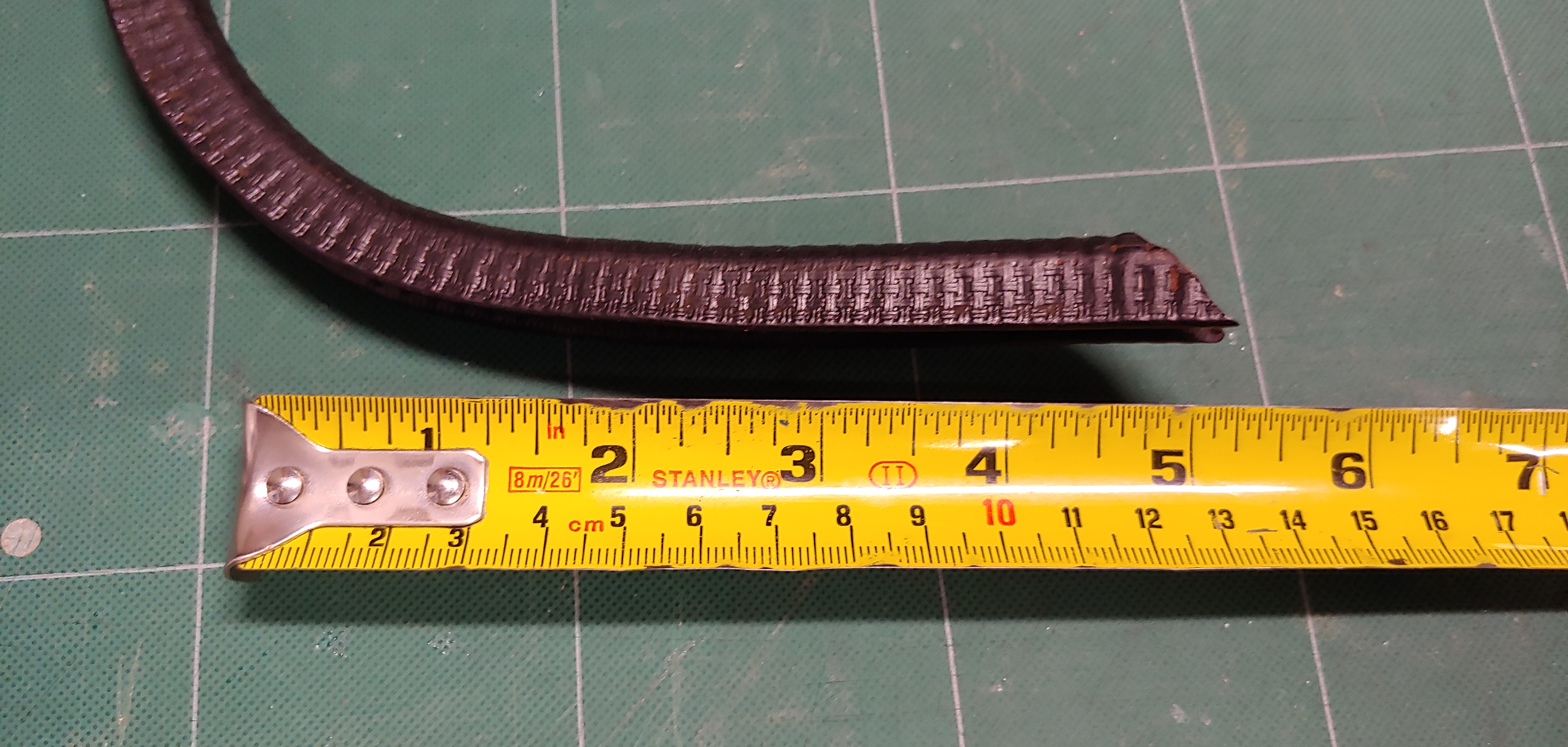

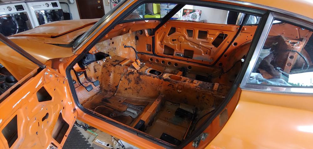

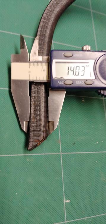

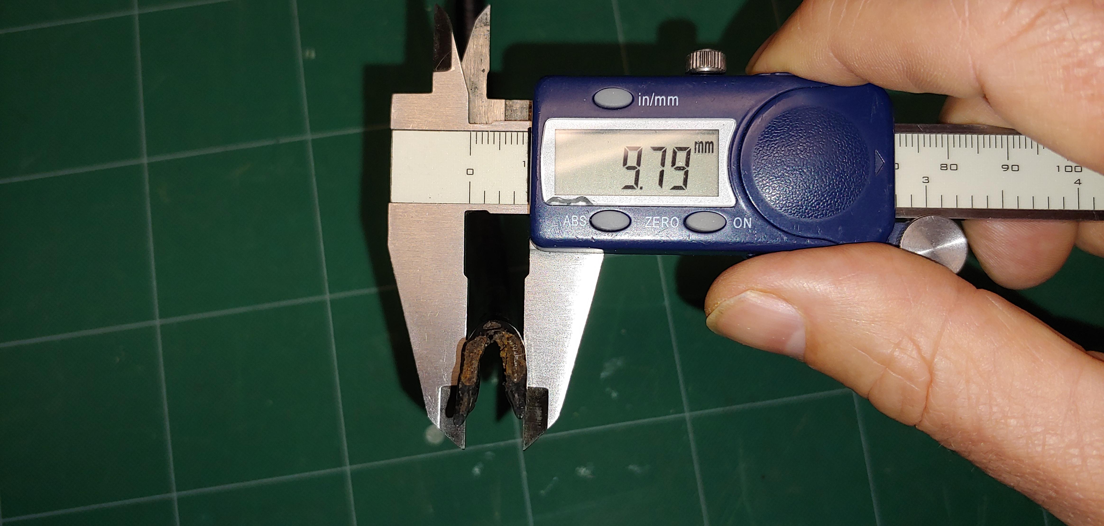

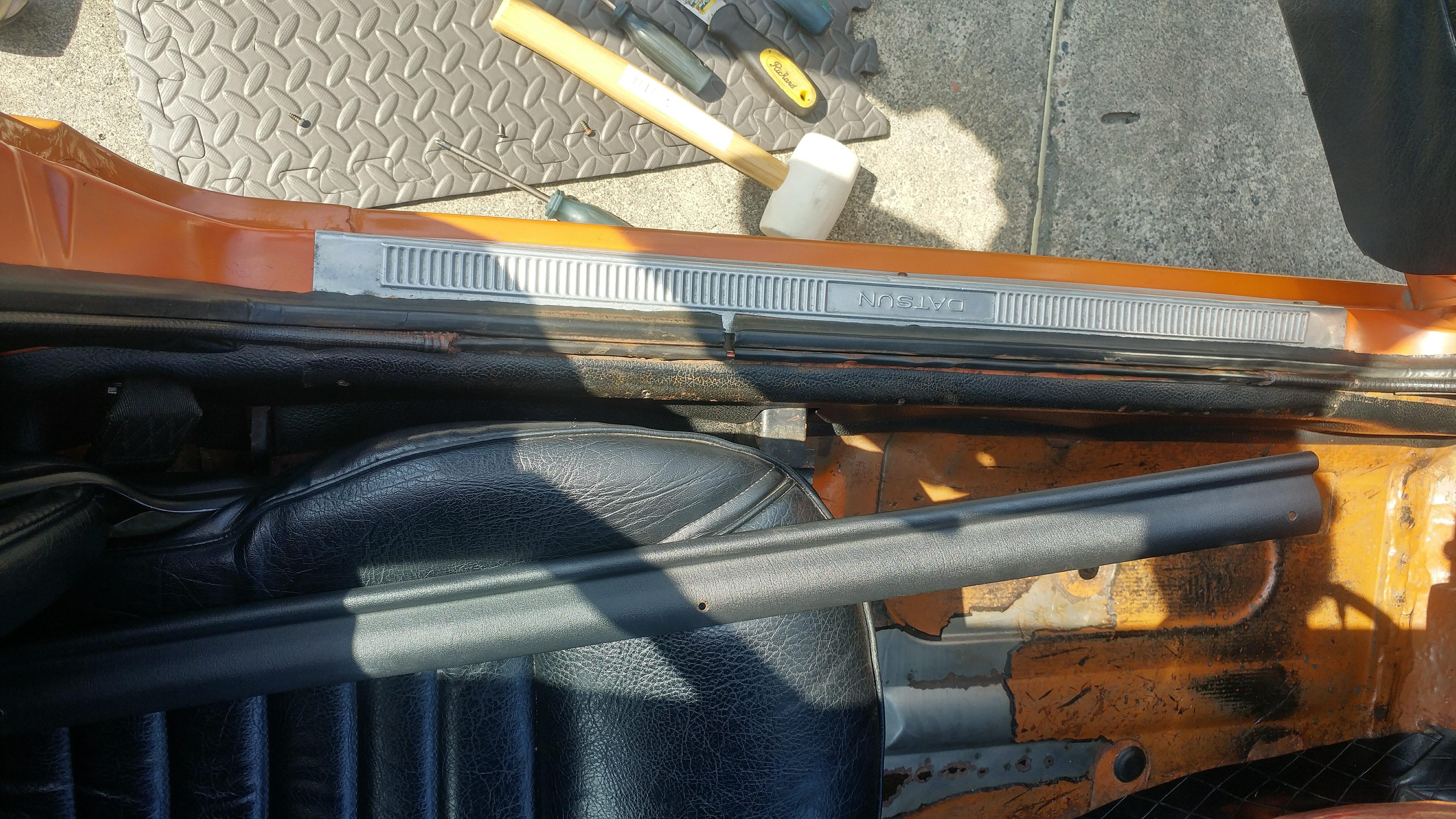

That welting trim is just pressed on. First the weather strip is glued on and has a thin rubber layer that goes over the pinch welded joint. Then the welting is pressed on over that rubber with the working part of the weather strip adjacent on the outer side. Here's a picture 0f my 7/70 car as I was disassembling it, and a few pictures of the welting.

The A Pillar vinyl is just glued on. The vinyl should wrap around each flange at it's sides. On one side, that will be the windshield flange - on the other the door flange. When the windshield is installed it's weatherstrip will lap over the vinyl on the A Pillar. Likewise with the door weatherstrip - it's welt will go over the A Pillar vinyl. You can use contact adhesive on both sides of the flanges but it's really only needed on the outside of the flange in each case - the weatherstrip holds the inside of the flange in each case.
The vinyl above the doors and above the windshield is a different story. That's where you use that welt you have pictured.
