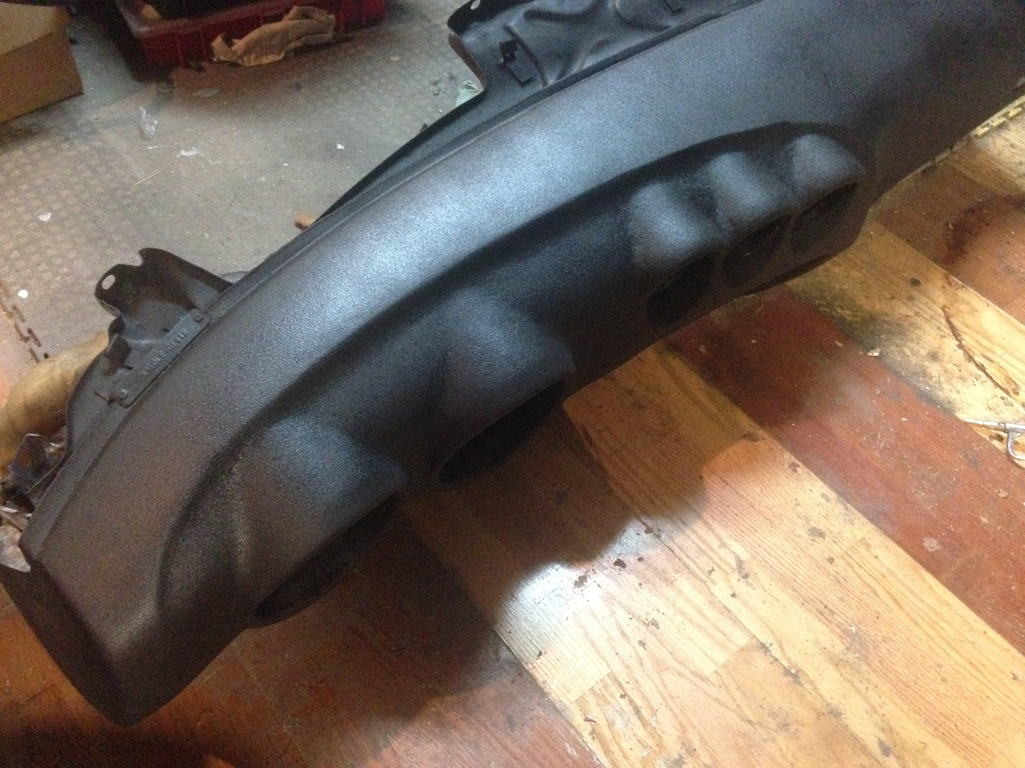

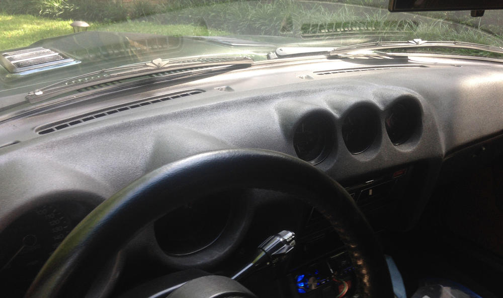

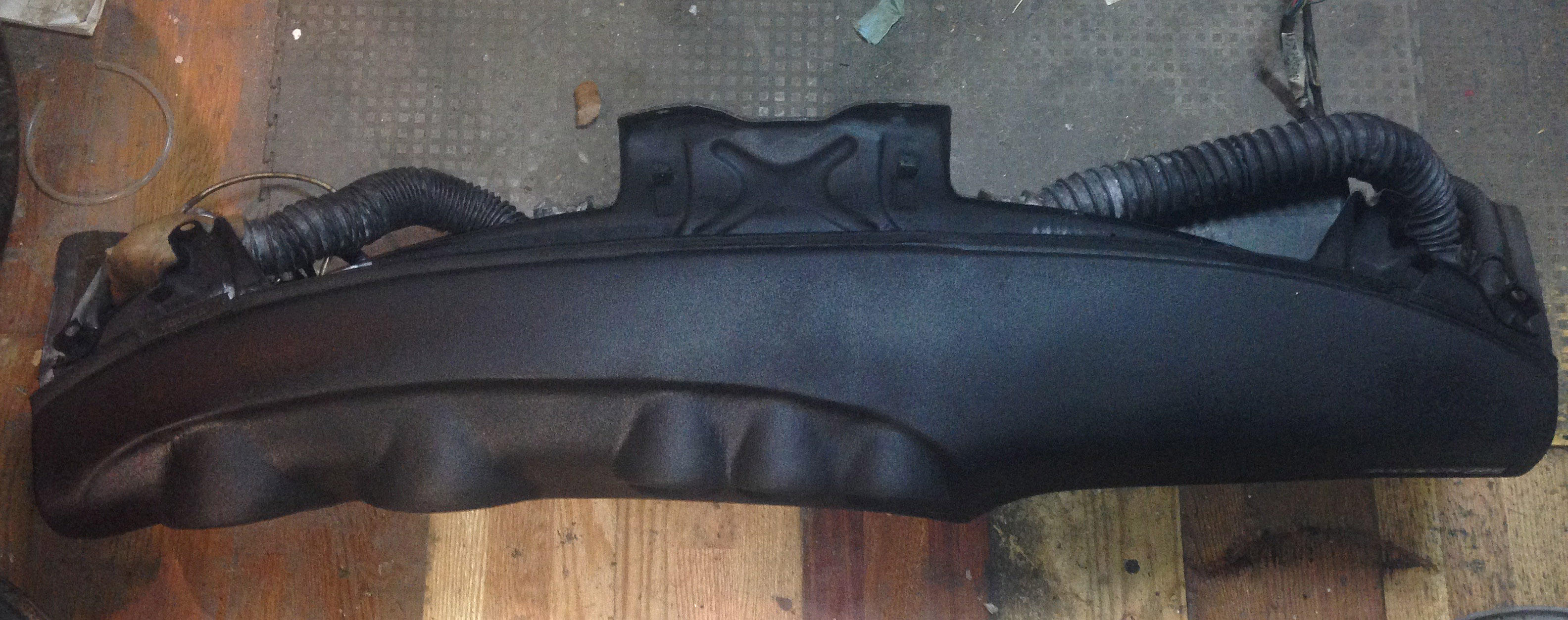

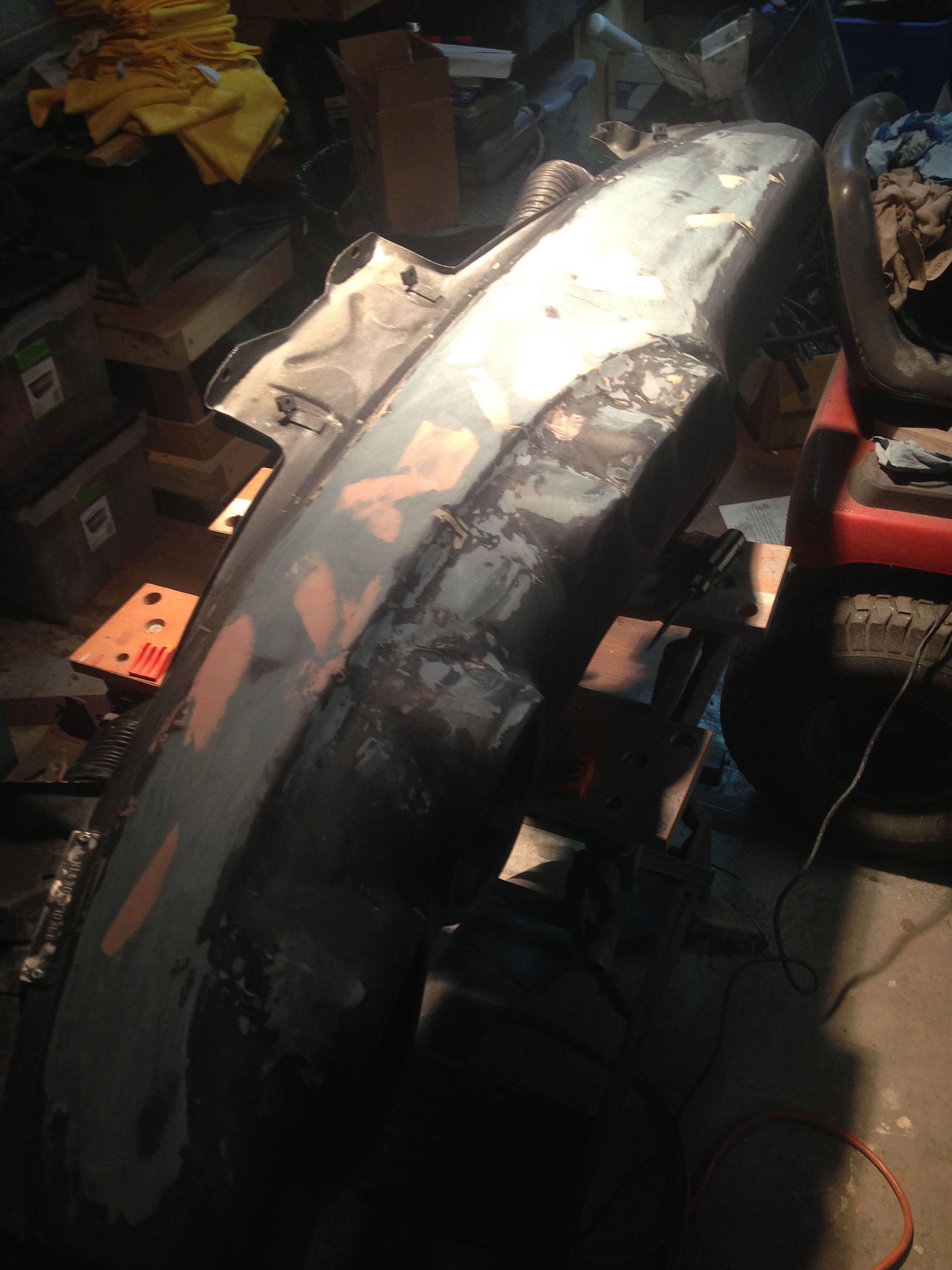

Well I finally got my hands on the Polyvance dash pad filler. As mentioned earlier in this thread, I found there is not a consistent price point on this product, so shop around and you will probably find better and worse deals,  even directly from the manufacturer.  I liked this better than the SEM bumper repair because it has a little  longer work time and I could make more of it at a time to spread it over more area quicker.  I needed to basically re-coat the whole top surface of the dash , I think because with the previous dash refinish I used the SEM bumper repair sparingly.  Upon examination, the SEM product held quite well in the filled cracks but new small stress cracks had formed all over the top.  I suppose just from age and the tussle of work from sanding/handling at the first go around.  At any rate, I achieved satisfactory to me results for less than the cost of a new full dash cover.  We'll see if it holds up for Zcon in Oct.
