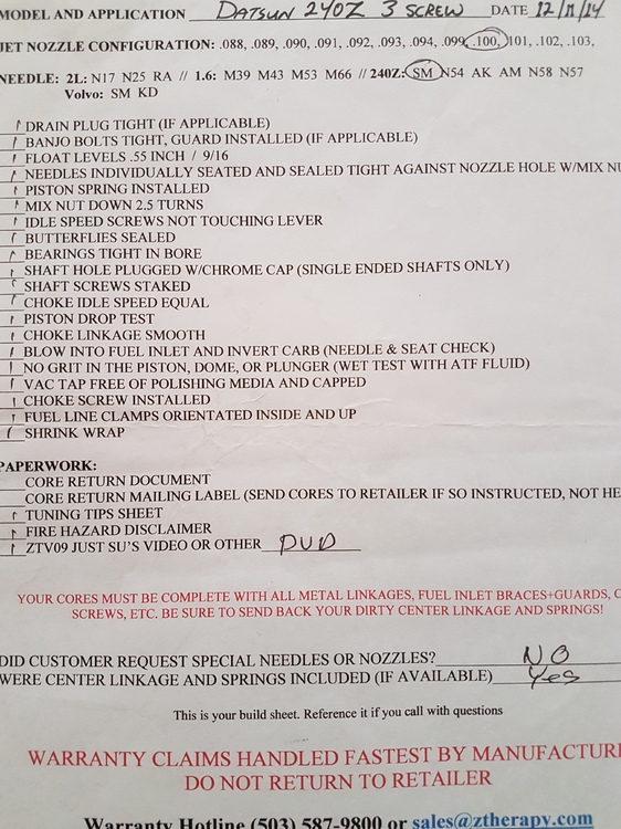

Just received a couple of the su float level adjustment hoses that ztherapy is selling. They do look different than the ones Radalla sells. Anyway i am hereby attaching the sheet provided by Ztherapy which states the gap between the top of the float bowl lid and the float is .055". 2 questions:
1. How do i measure if the level is correct? Just plug these hoses  to both of the drains with the car engine on?
2. the correct gap is .55" or other measurement? My car is a 1972 240z with dual roundtop 3 screws su carbs and SM needles fully rebuilt by ztherapy on november 2014.ztherapy sheet.jpg

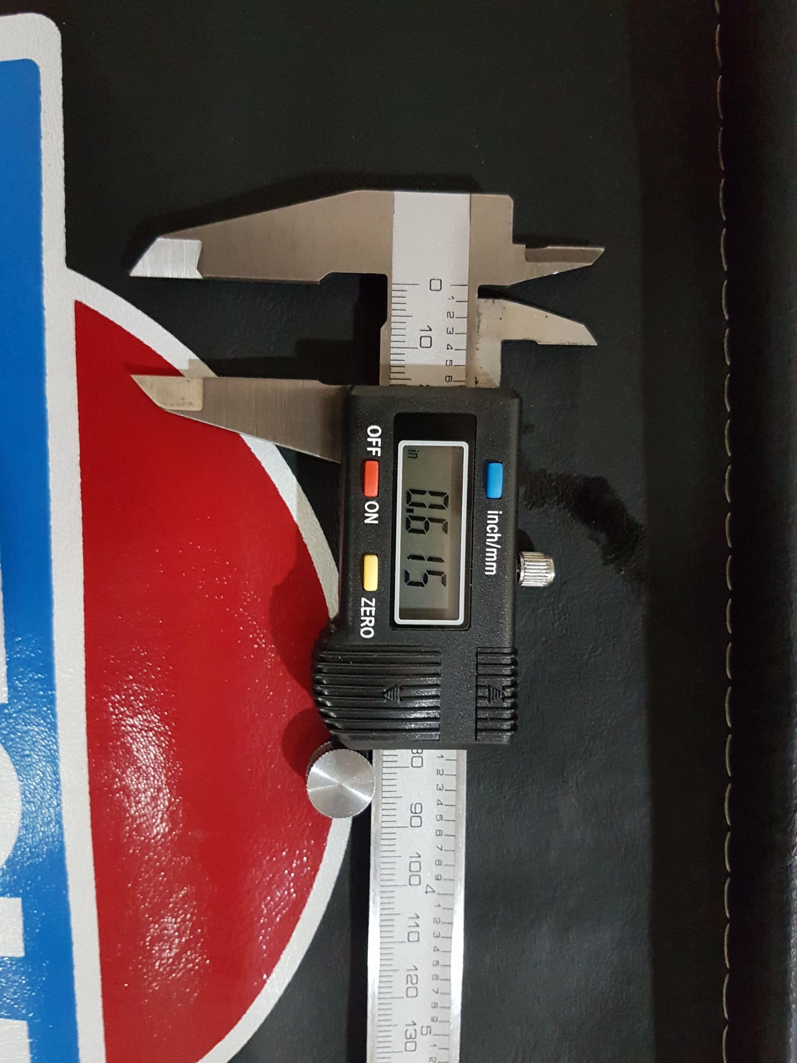

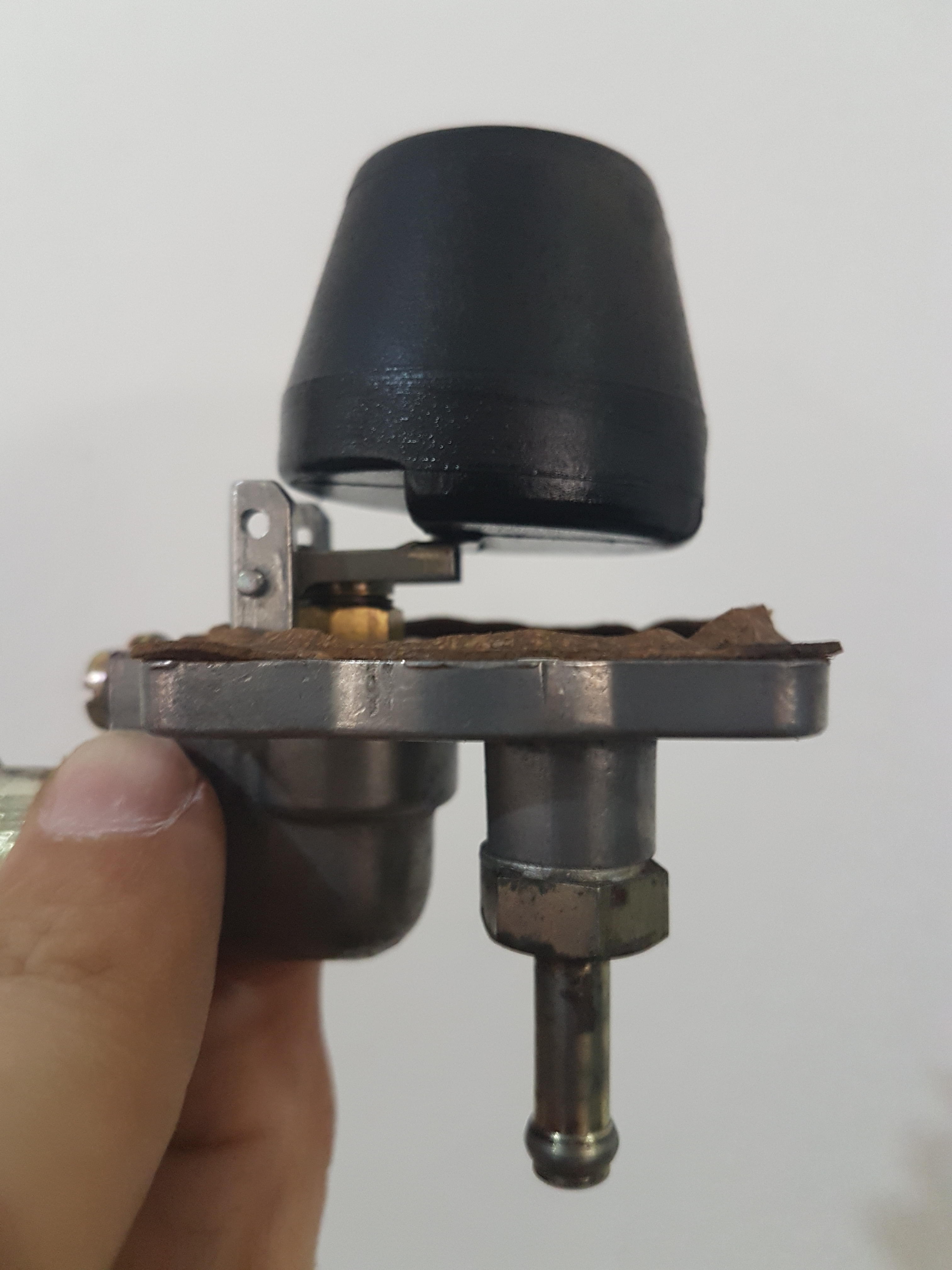

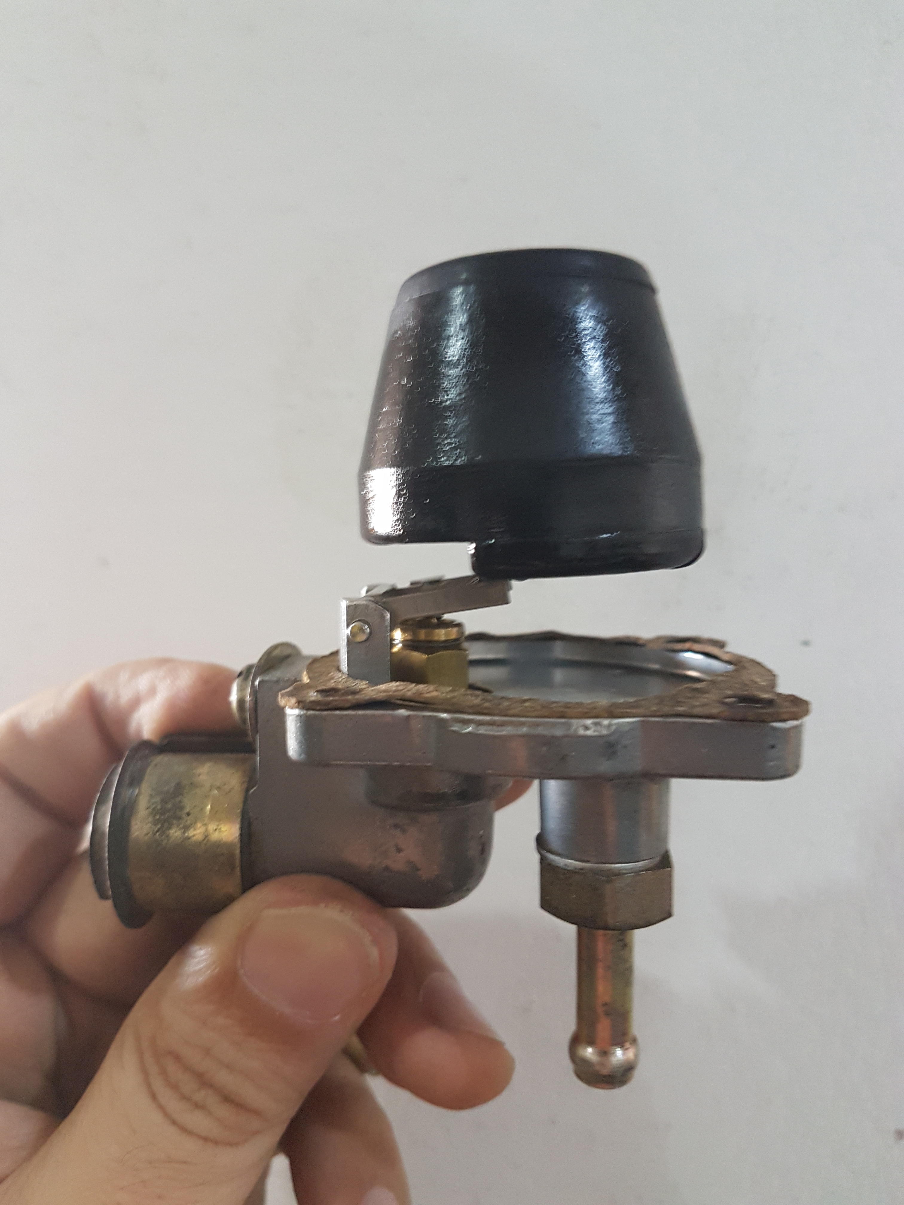

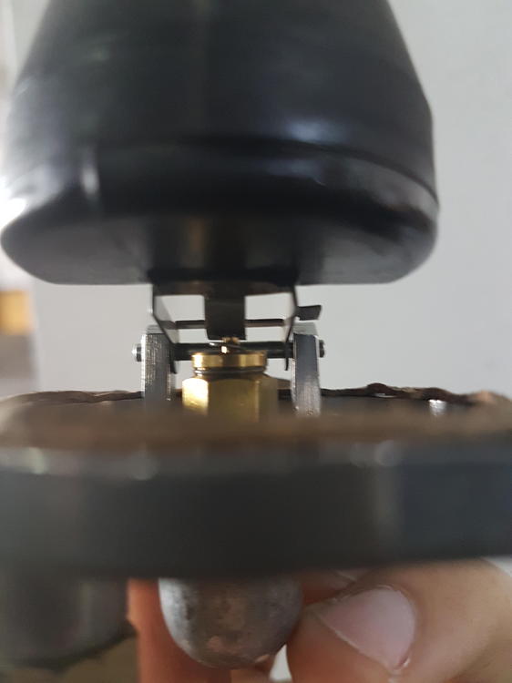

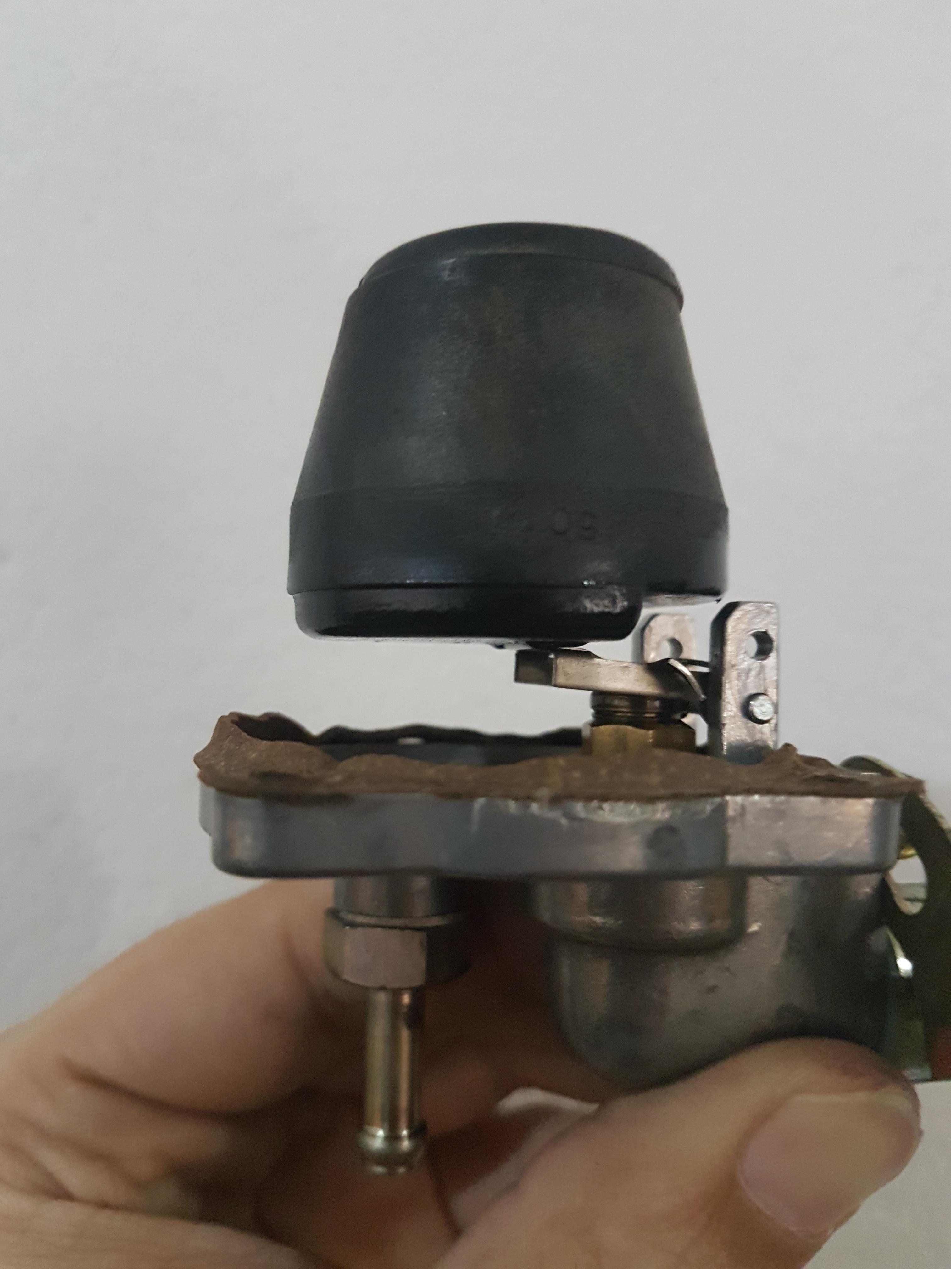

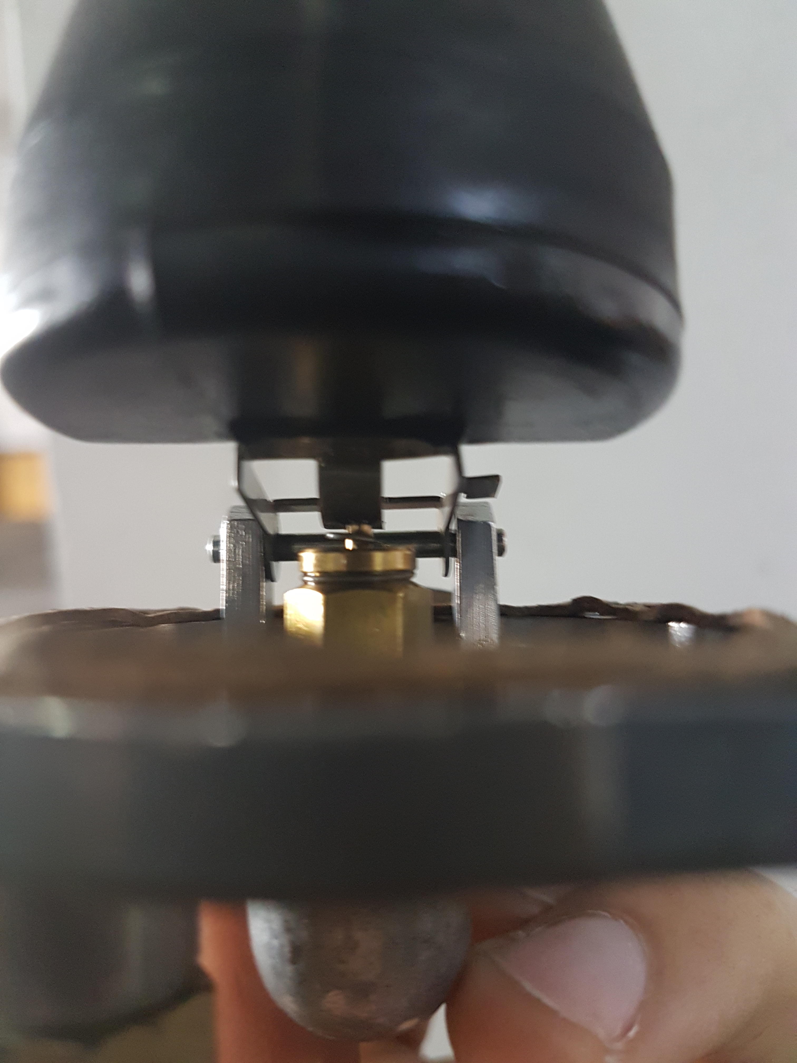

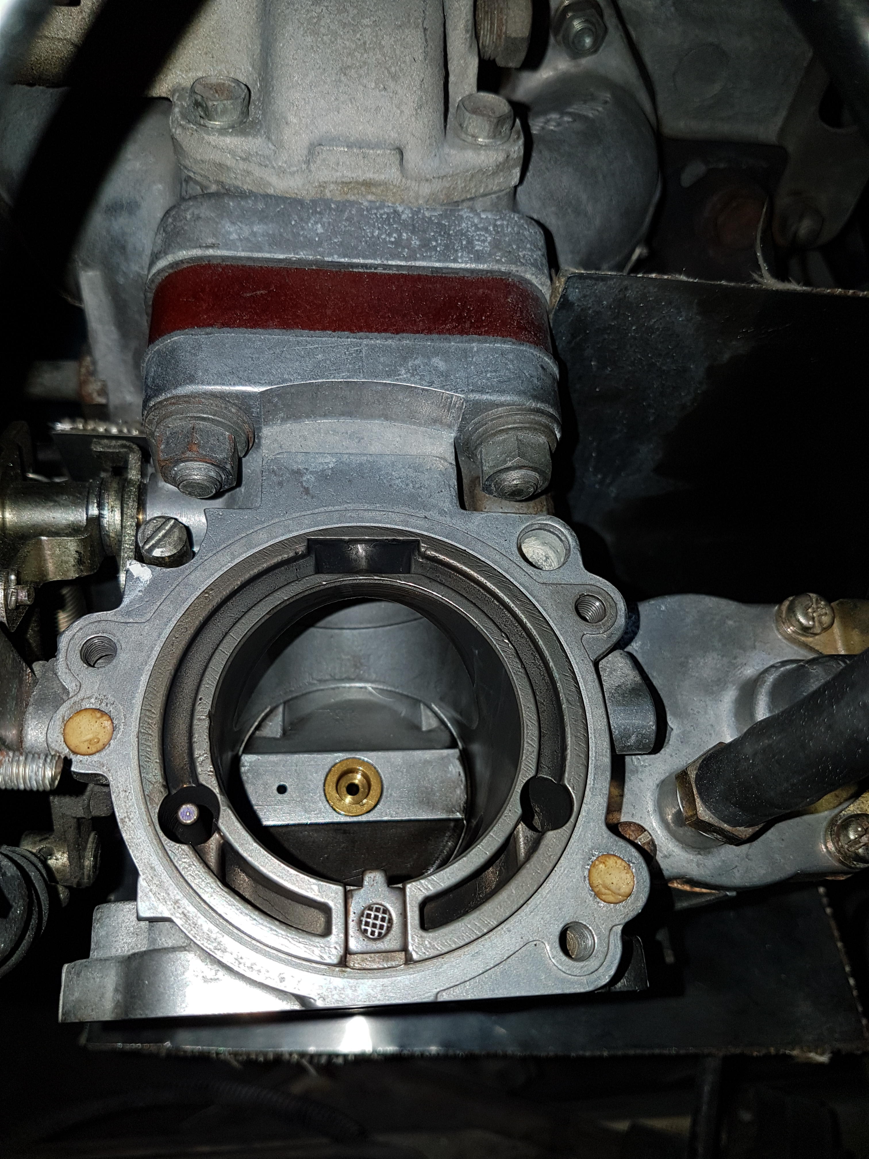

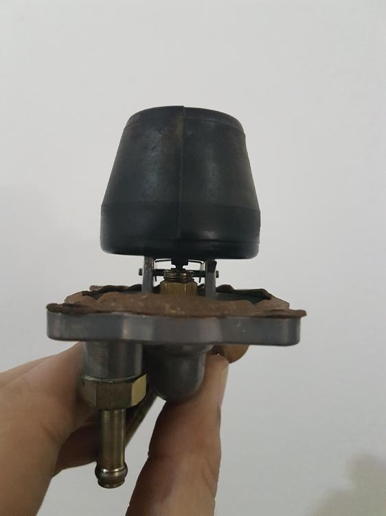

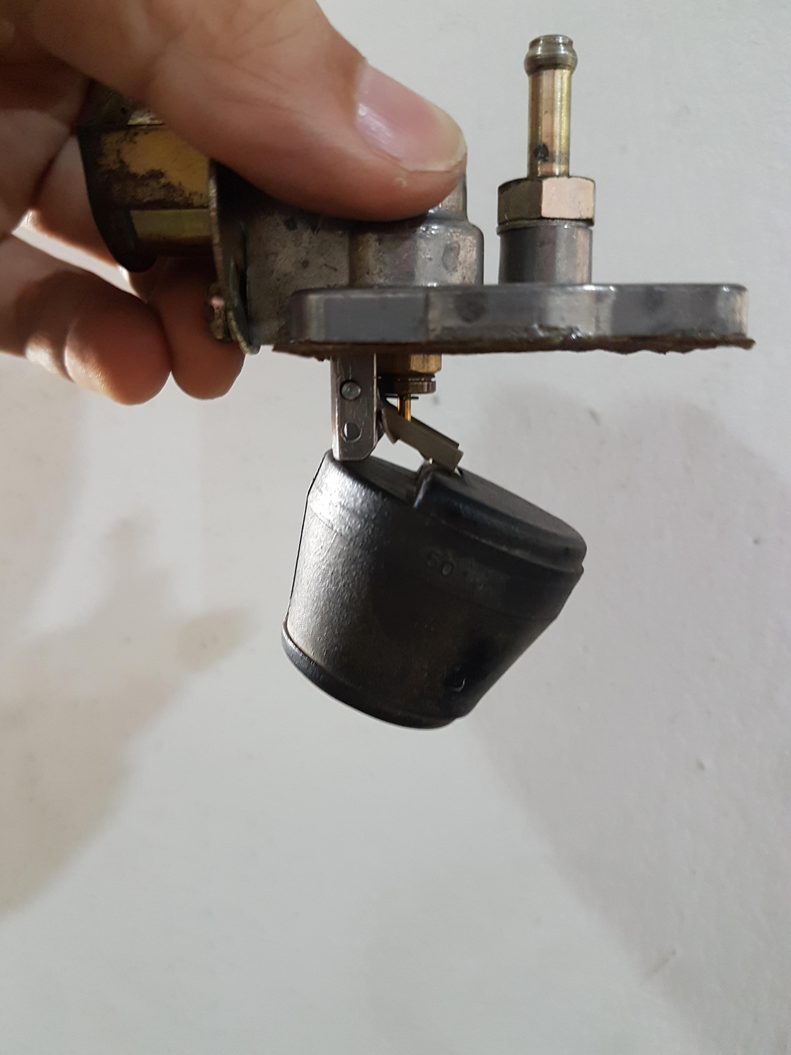

Well at the end i decided to drain both float bowls removing the drain screw and open the box of surprises:
1. Mechanic drill a lower hole to Front float lid ears to compensate i dont know what maybe the size of the needle valve that ztherapy installed in that lid which should have been the larger one. Front and rear carb have the same size of needle. The .55 gap was also wrong it measure .61 inch.
2. There is a disadvantage on drilling those holes as the float gets to a point where it cannot move any further.
3. The rear float was also out of gap if you measure the gap from the top of the lid to the bottom of the float.
4. Setting the carbs at 2.5 shows the same depth as per the pictures.
Now what else should i do? Install the correct height needle valve, move back to the original holes in the front lid and get a gap of .55?
@siteunseen Cliff, When you shimmed? the needle and seat in one of your carbs, did you have equal length needles and seats in unequal pivot ears? I'm kinda in uncharted territory. My experience is with 4 screw SU's where all things are equal. It seems to me that it would be best to get the different length needles and seats and go back to the stock pivot point. Opinions are needed.
Yes, use the long valve in the front bowl and put the float back in the original holes like Nissan intended. The fuel level needs to be lower in the front bowl and that makes it easy. What happened with the ztherapy plastic sightglasses in the first post ? That's what I use. Or the ones by Randalla. Or use the "both nozzles at same height, same fuel level in the nozzle" method. If you can use either of those methods why bother measuring .55 inch or whatever ? That method is a little iffy, even if it's in the FSM.
