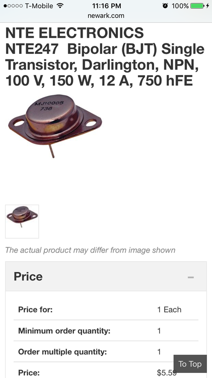

Part # for the transistor is "NTE247", for the convenience of any readers out there with a similar situation as myself.
Now I know what it looks like, I'm actually exited to take out the ECU tomorrow and see what is going on in there.
Attachted picture for reference.

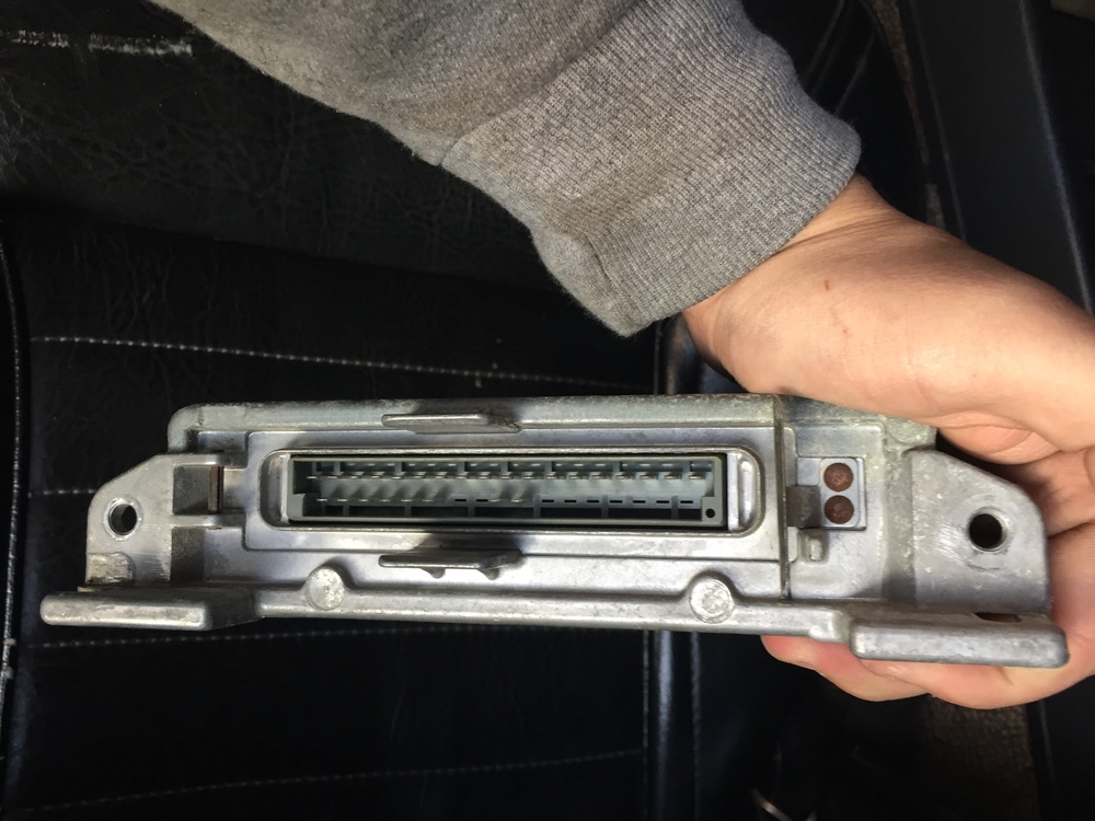

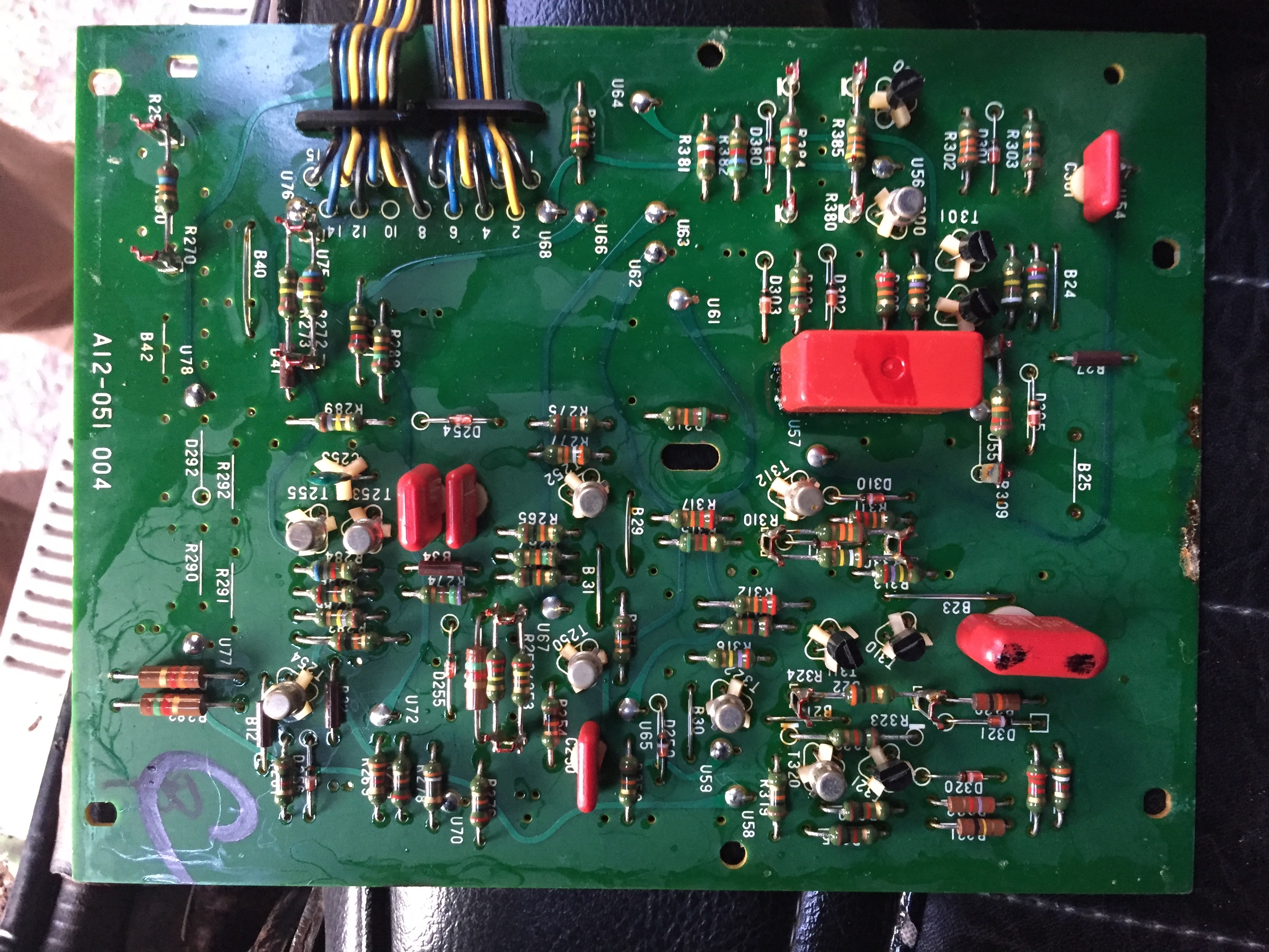

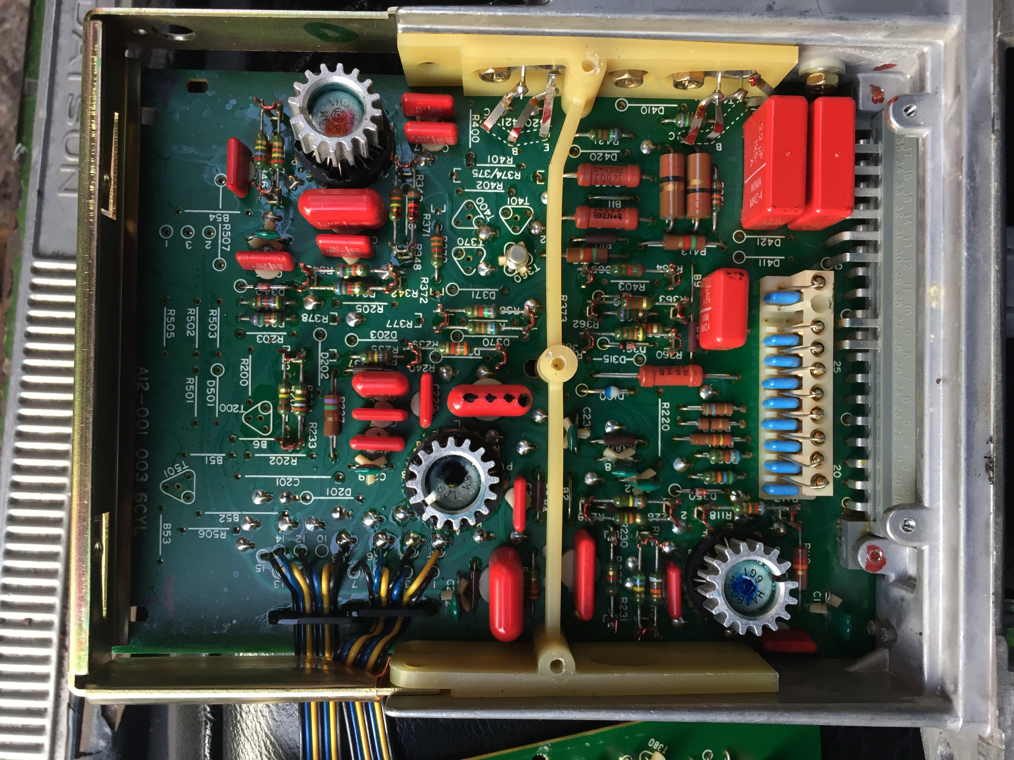

Took the ECU out to get some photos and take a peak. I don't know what I was expecting but I popped it off and instantly realized I have no idea wth I'm looking at haha.
Nothing seemed loose or disconnected. Maybe some dirty stuff that built up by nothing stuck out. The transistor connections looked ok but they still may be at fault for all I know.

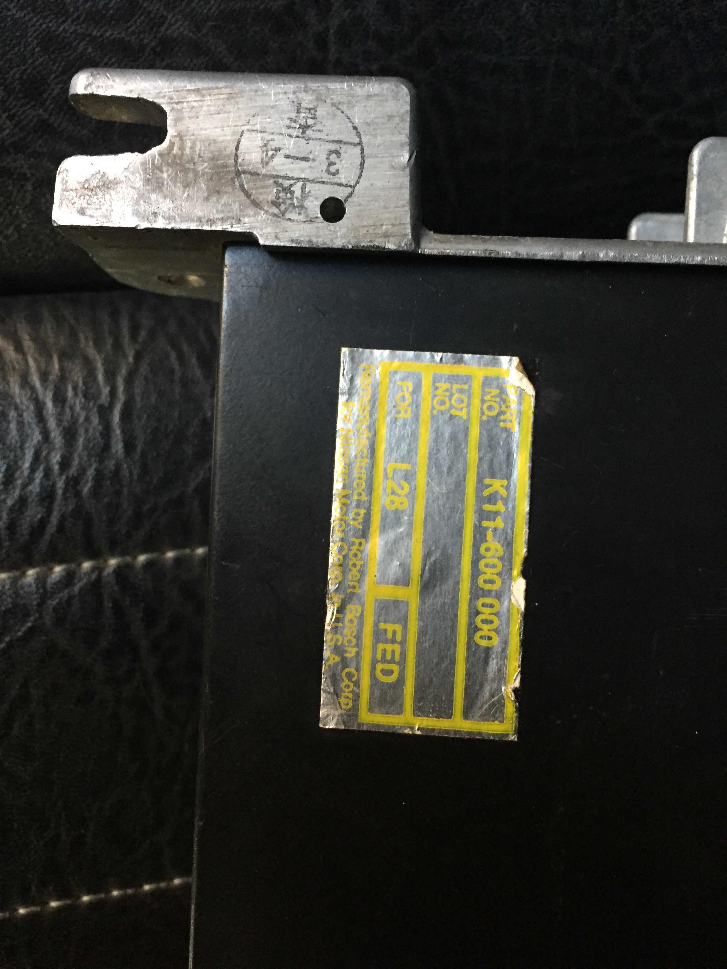

ECU Part # K11-600 000
