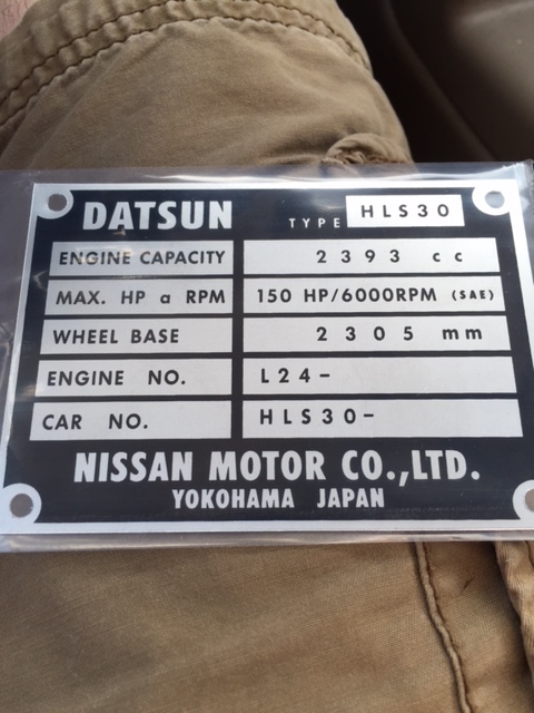

The plate in the doorjam is legible but completely unusable.  So I decided to replace it.
The plate in the engine compartment is missing all together.

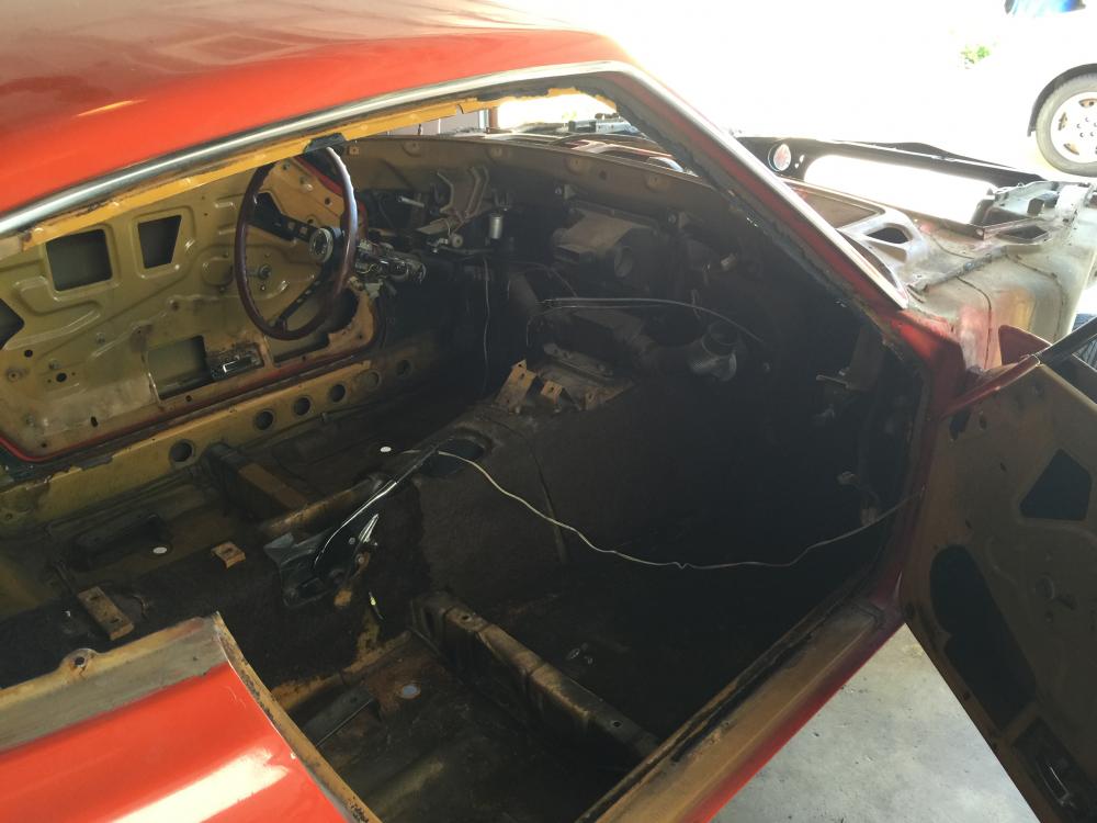

My buddy came into town and we got the engine out was not as hard as I thought it was going to be.  This was my first engine pull and felt it went smoothly.
We also got the dash out, that was a different story.  I can honestly say that it was not that fun and I am fearing putting it back in.

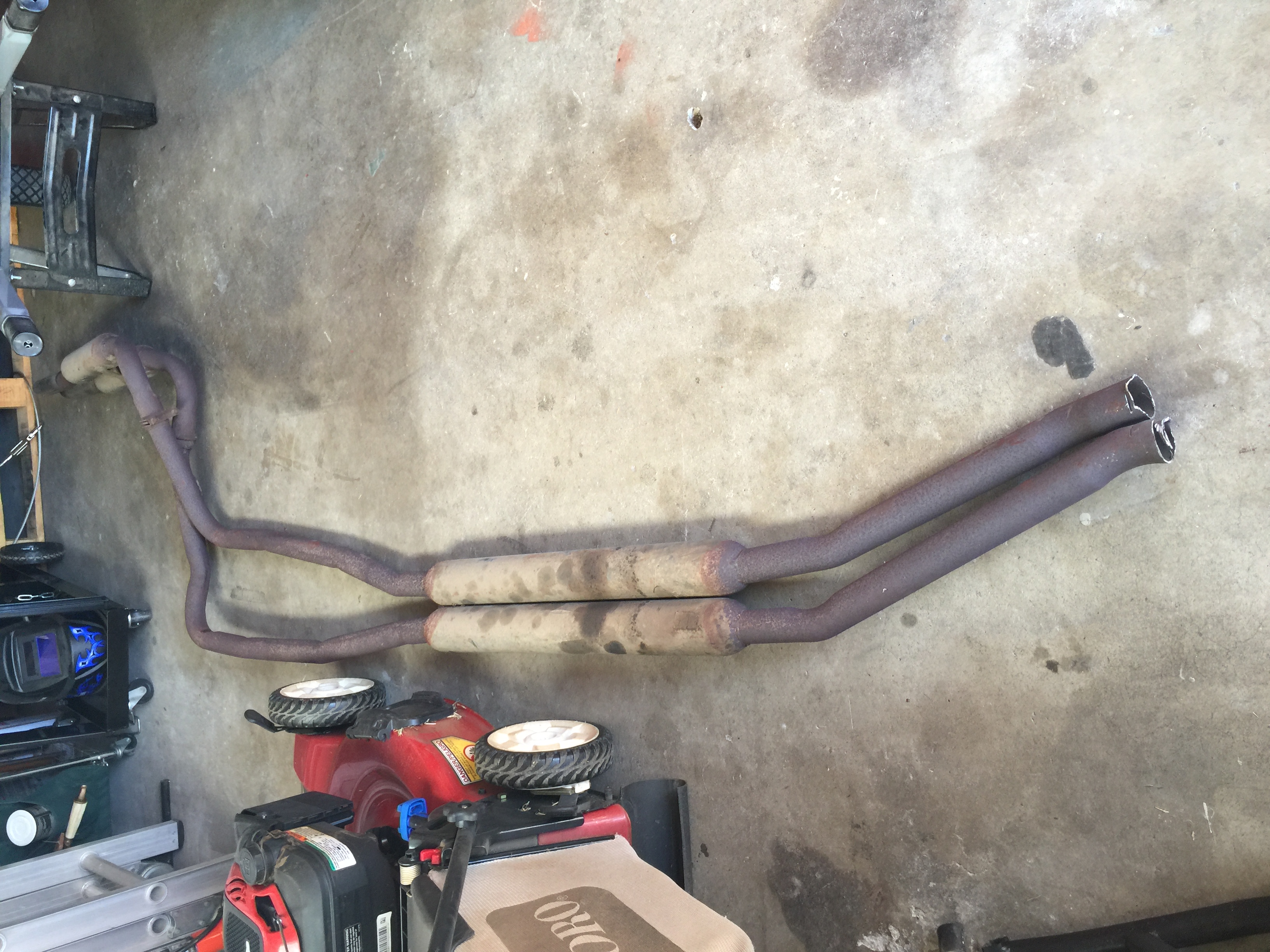

Taking the exhaust out was fun, I got to play with my cutting tool.  After about 20 minutes it dropped right out.

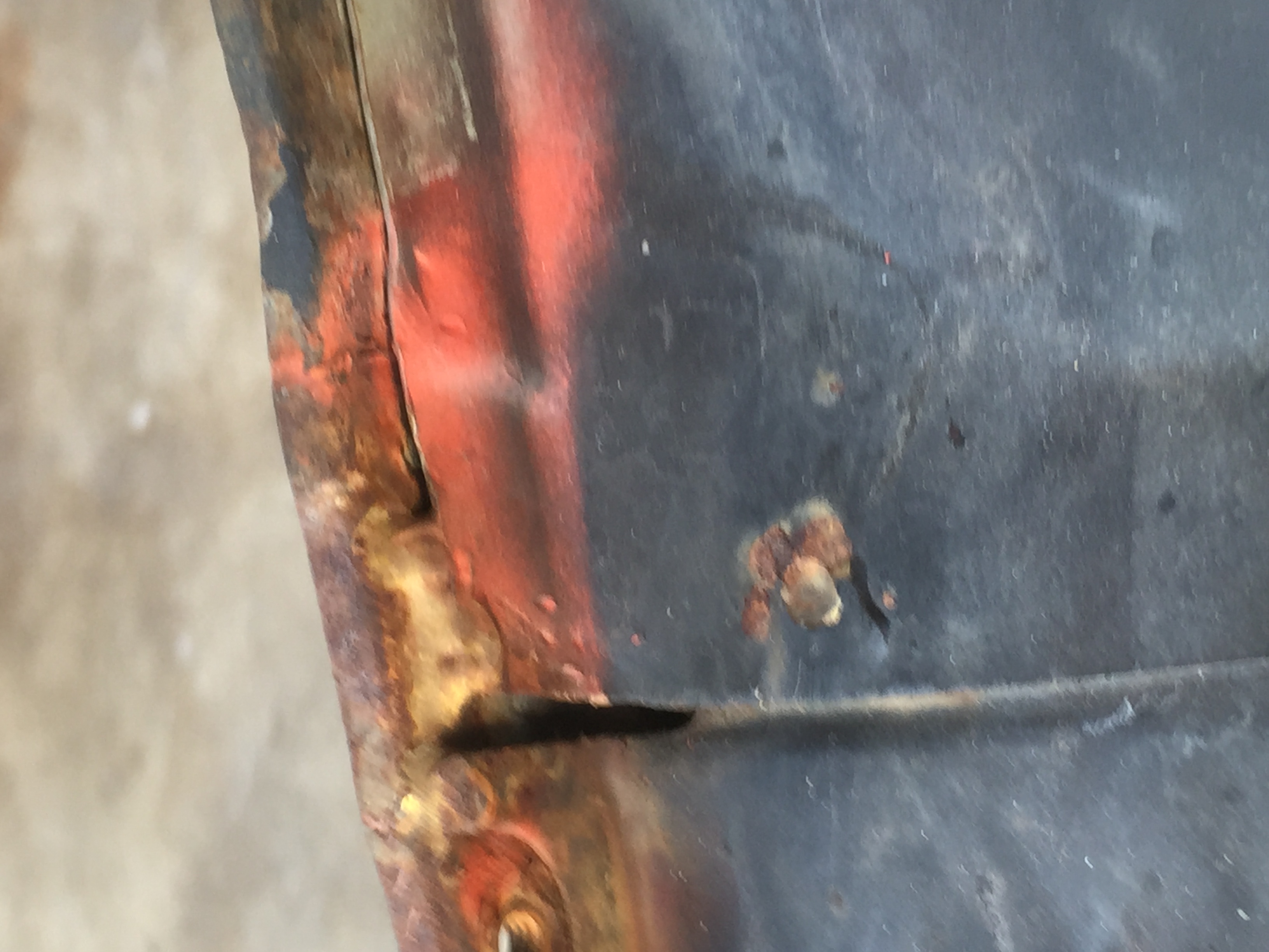

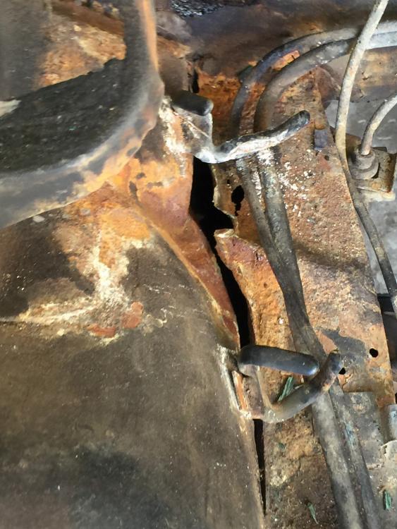

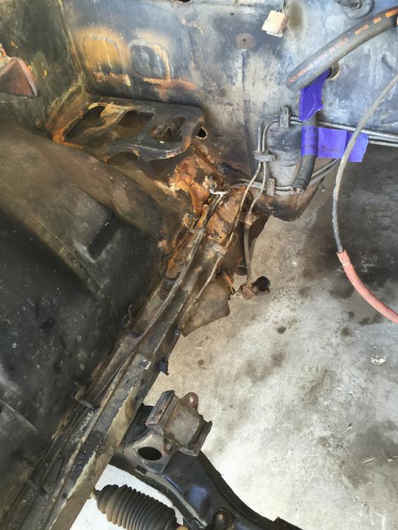

Now for some of the bad I found.  This car tells a story once allot of stuff is out of the way.  It had to have been in a front end collision of some kind because there is evidence of a hatchet job repair.  I am glad really because the after pictures are going to show what level of detail this restoration went through.
Passenger side under the battery tray.
A closer look at the separation of the frame rail.  I am really glad I did not drive this car while waiting to start the restoration.

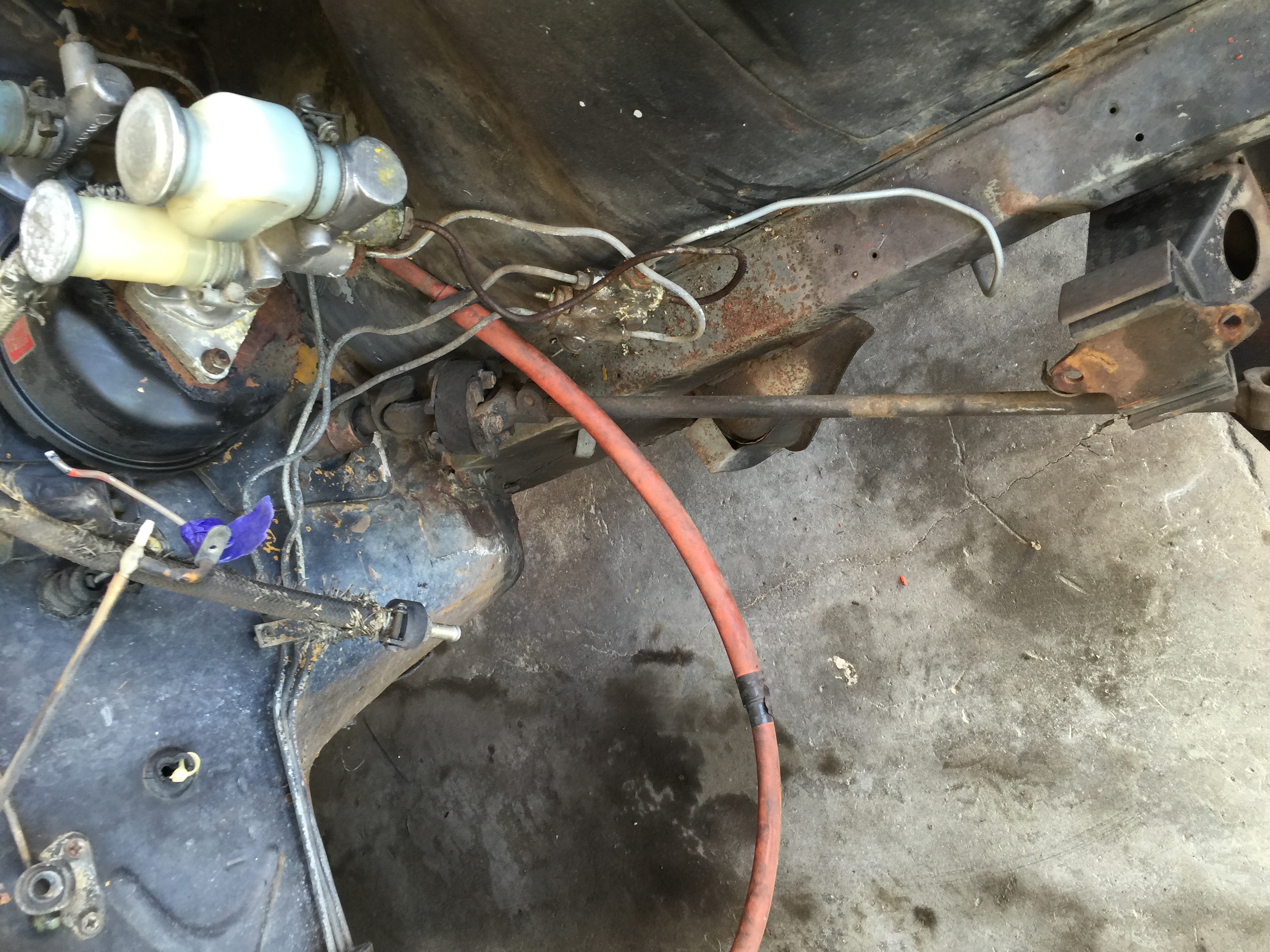

I think i could have done a better braze job than this.  this is the inner wheel well at the front on the passenger side.

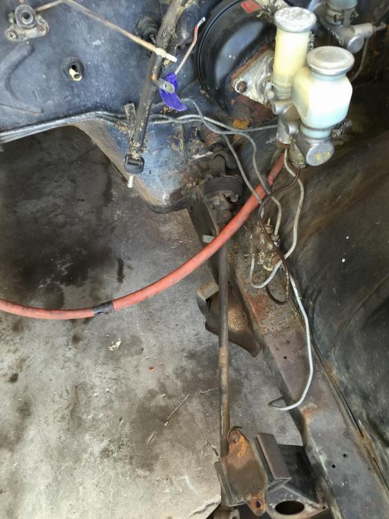

Not as bad as the passenger side but there are still some issues that need to be addressed.

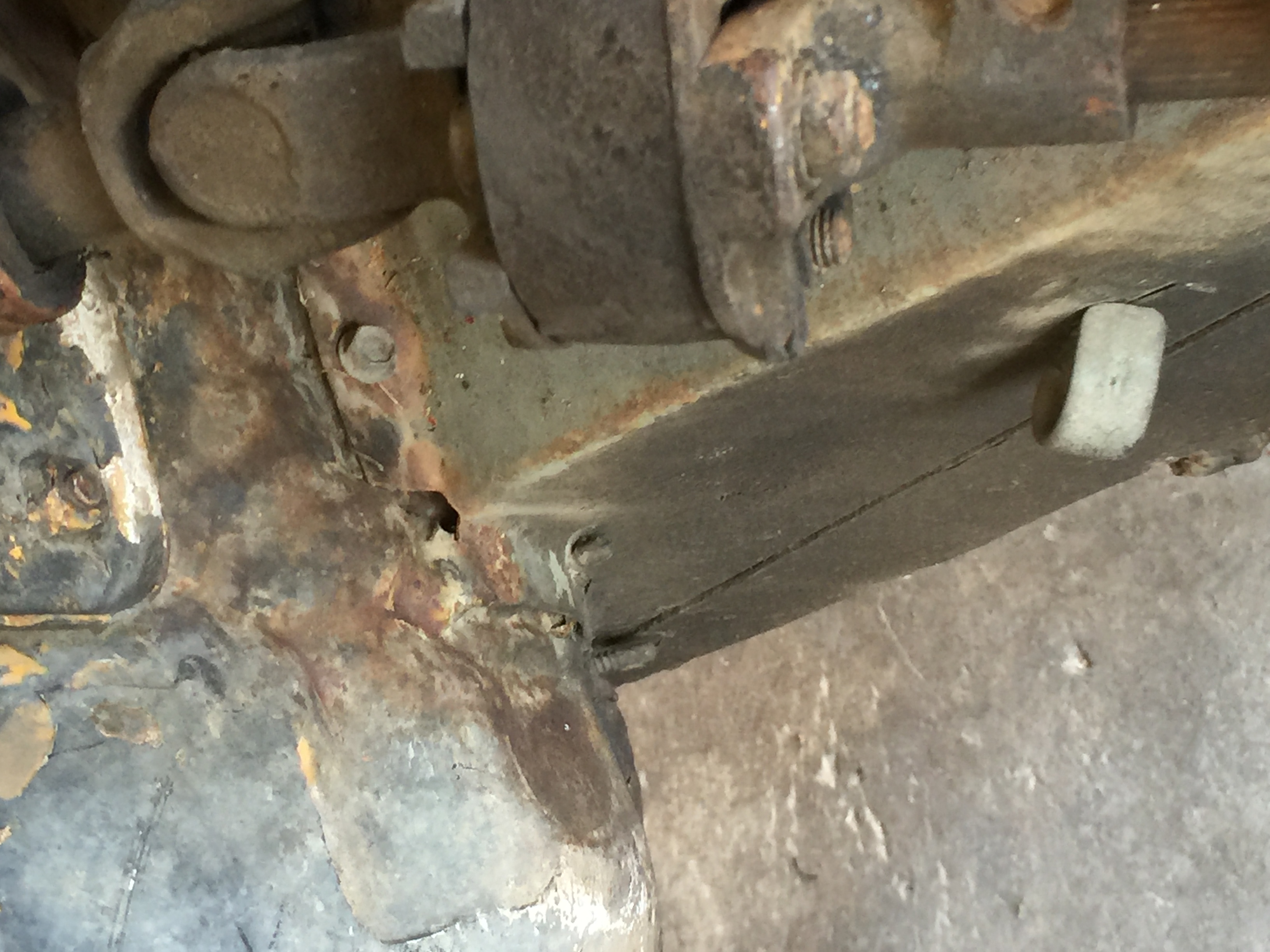

Looks like a new frame rail was added but they didn't take the alignment bolts out after the non existent weld job.  Correct me if I'm wrong but they should have put the screws in welded the seem taken the screws out and spot welded the holes?.?.?  Well thats what I think I would have done.

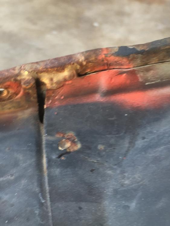

Driver side frame rail has been crunched and needs replacement.
The weld brok on the front end replacement that holds the radiator.

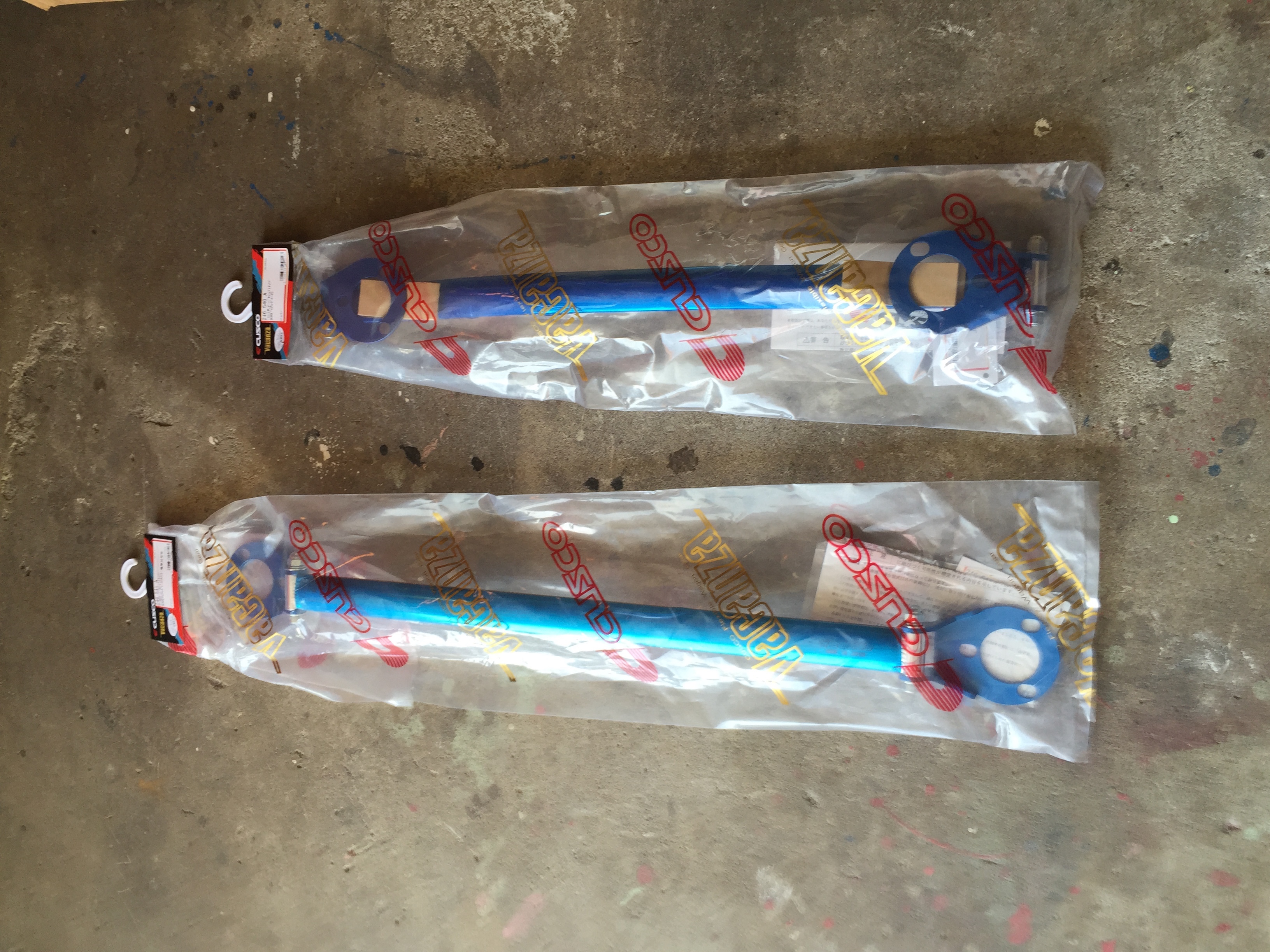

I also bought Front and Rear Strut Bars from CUSCO.  I am going to get the rear strut bar painted at the bodyshop to match the safari gold of the car.  I think it will look good.
