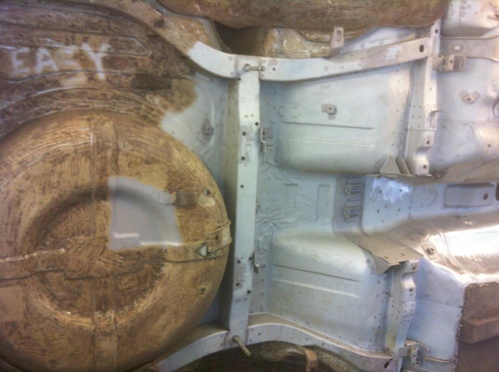

Yes, it is right to the metal. A somewhat rough finish that will bond well with the POR15 when I get to that stage....
It looks dull compared to the section of tunnel that I did with the EZ Strip wheel...
Edited by wheee!
I am actually quite pleased with the minimal amount of dust being generated. I use a face mask of course, but I would not want to use sand under any circumstance! Plus, I am glad I am not using the crushed glass as it is so fine, I would be worried about breathing any of that in!

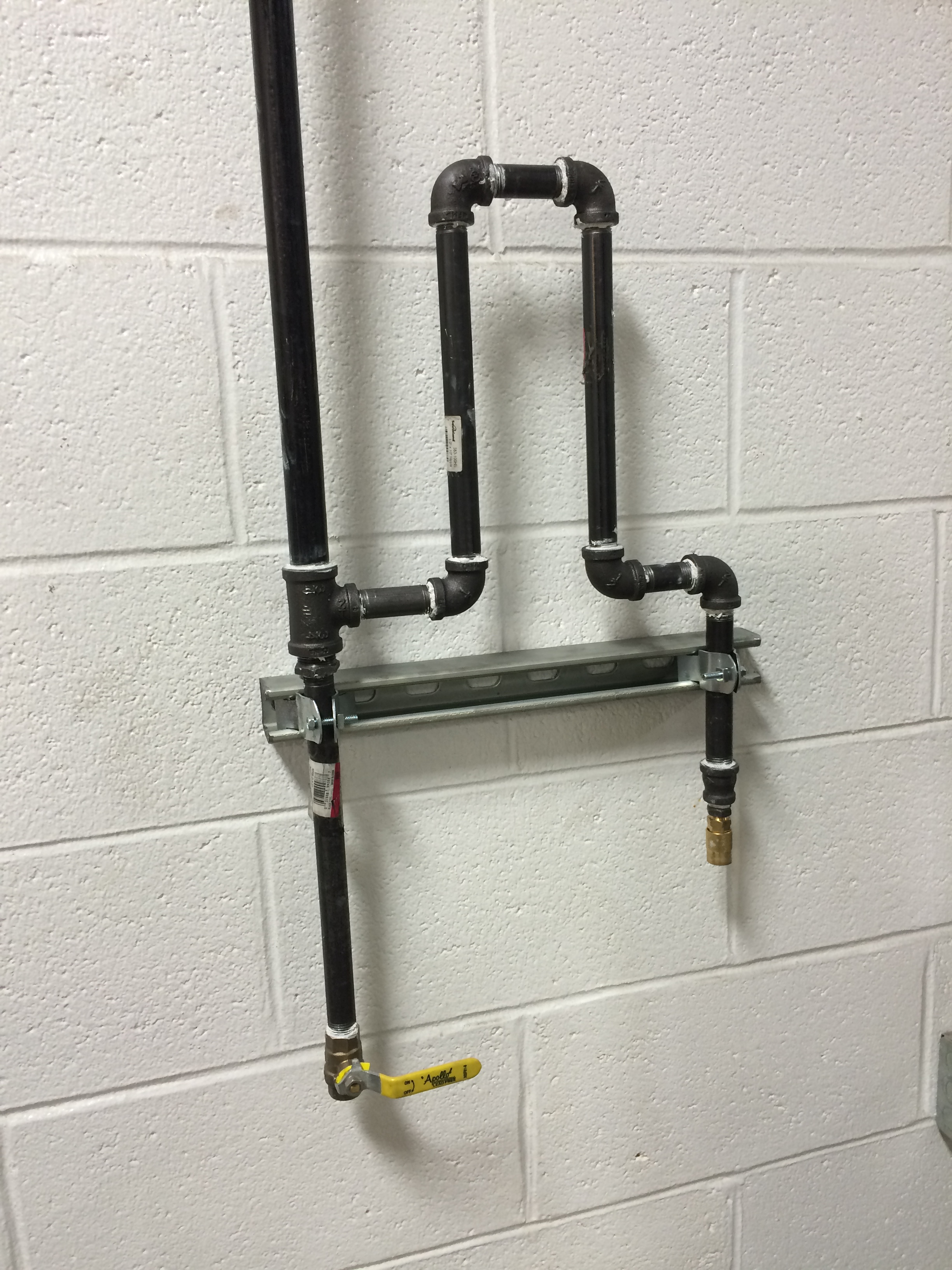

If you have your shop plumbed for air, it is important to give yourself a water trap and drain.  Here is an example that we use at our local workshop.  The ball valve can be cracked to drain the water from the line without removing the air hose.  The trap also keeps water from accumulating when not in use.  Sorry for the sideways pic.  It is correct on my computer.  The forum is turning it for some reason.
True. That is why my air dryer has the big ball valve at the low point of my system. It allows me to close the ball valve at the compressor, then open the ball valve on the drain every night. Several times a day while sandblasting too...
