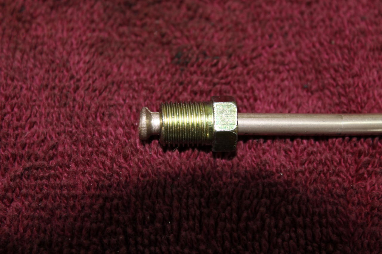

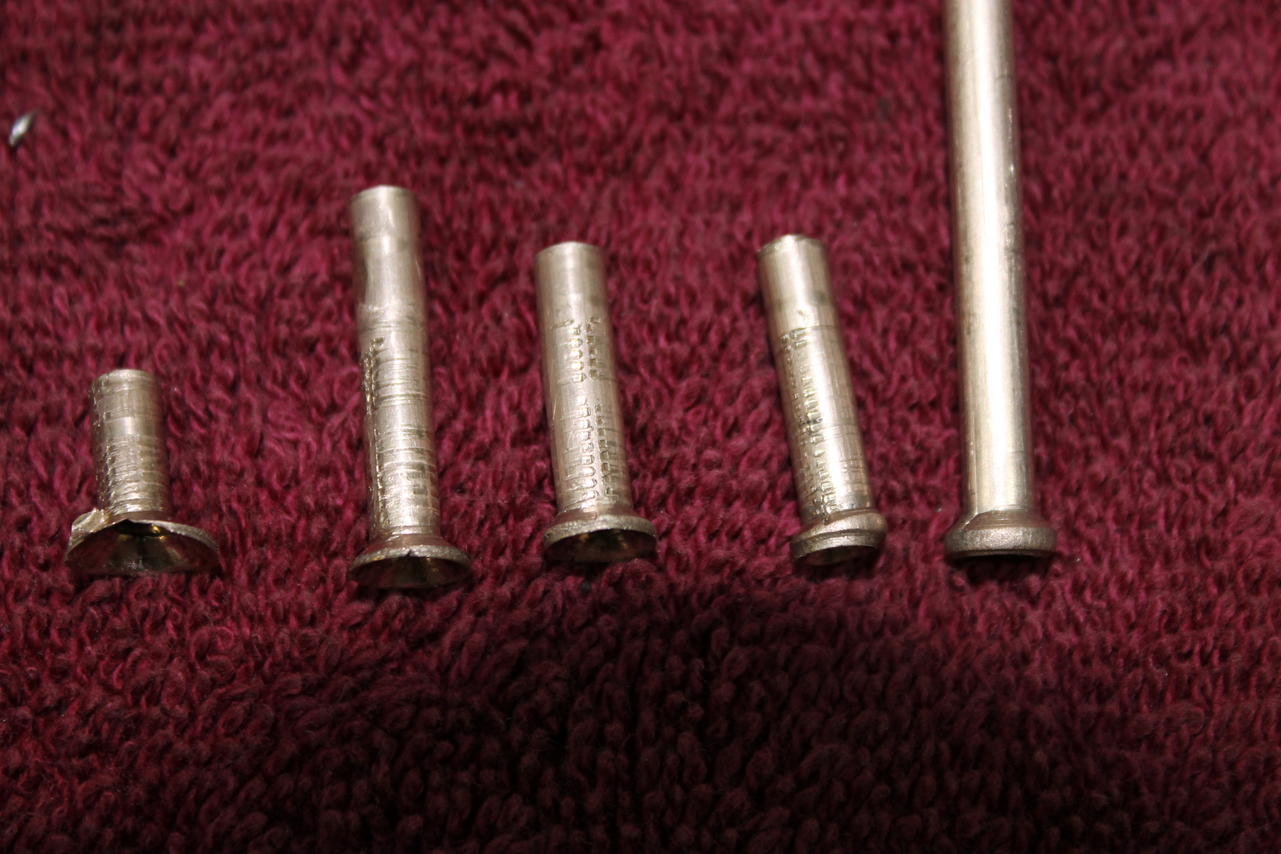

This is how to flare - dead perfect every time with the flaring press!
1st pic is with flaring press
2nd pic is with hand flaring tool - and flaring press
