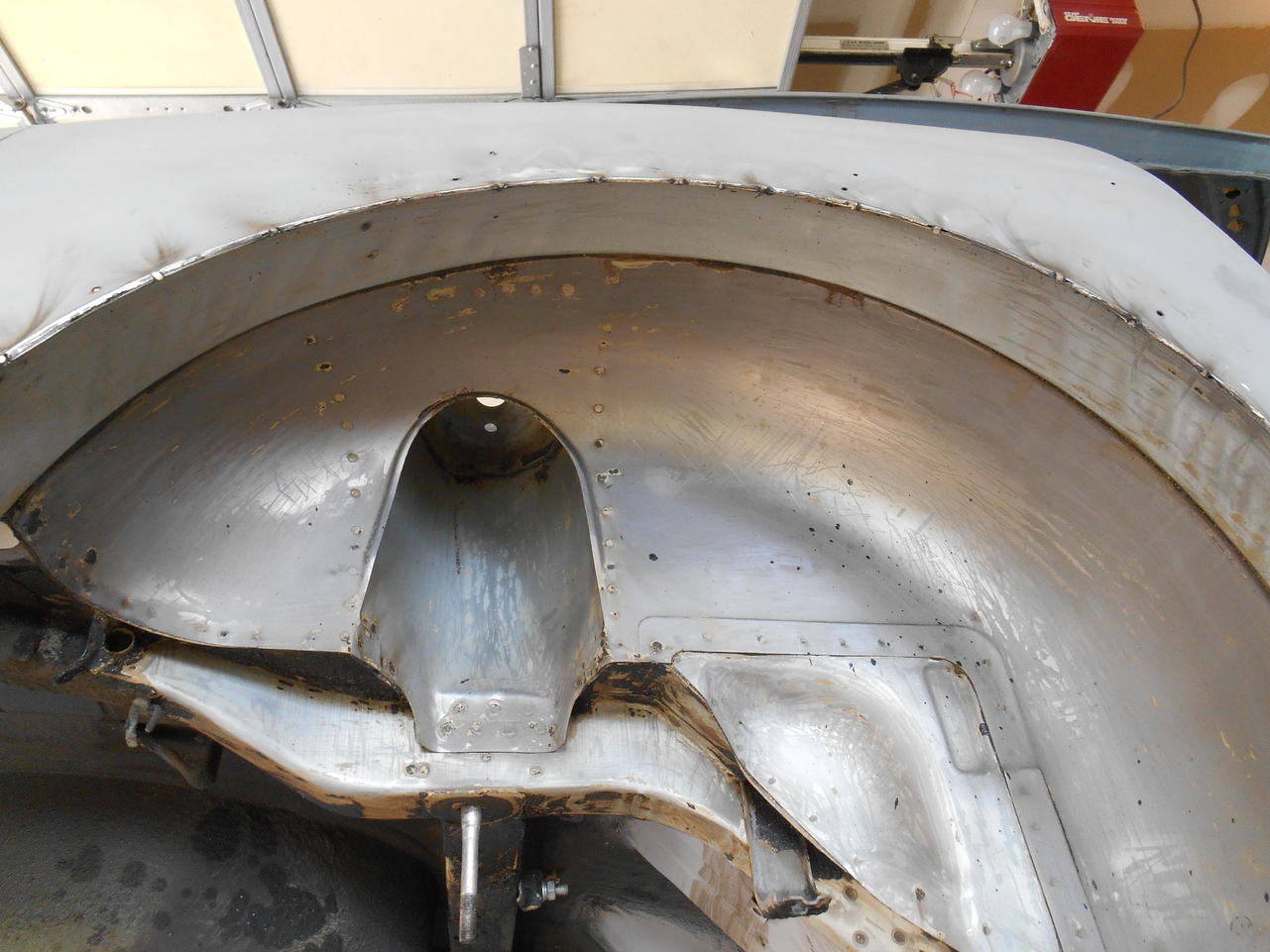

ZCurves Posted October 18, 2013 Share #17 Posted October 18, 2013 No criticism here. When I did mine there was only a fraction of what you have undertaken. Outstanding work! I have to ask though, are going to treat the insides of the Rockers and Frame Rails (Upper and Lower)? I treated mine by drilling access holes and spraying Phosphoric Acid with a wand, followed up with Heavy Duty Rust Preventative from Eastwood. Kinda like the old Ziebart system - except DIY. Post more Pics!! Link to comment Share on other sites More sharing options...
ksechler Posted November 2, 2013 Author Share #18 Posted November 2, 2013 No criticism here. When I did mine there was only a fraction of what you have undertaken. Outstanding work! I have to ask though, are going to treat the insides of the Rockers and Frame Rails (Upper and Lower)? I treated mine by drilling access holes and spraying Phosphoric Acid with a wand, followed up with Heavy Duty Rust Preventative from Eastwood. Kinda like the old Ziebart system - except DIY. Post more Pics!!Yes, thanks for bringing that up. I bought a wand and have the rust inhibitor. I have removed all of the rust I could reach and sealed those areas. I will drill and treat the rockers once I get all of the blasting media out of there. It would be a shame to go through this just to have it rust out again.Thanks all for the comments. Link to comment Share on other sites More sharing options...

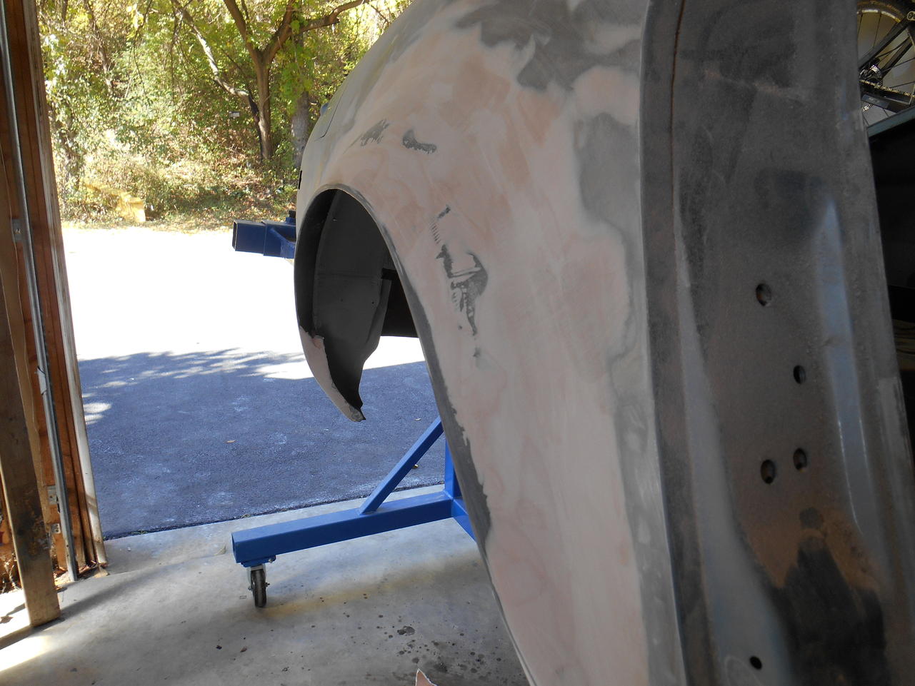

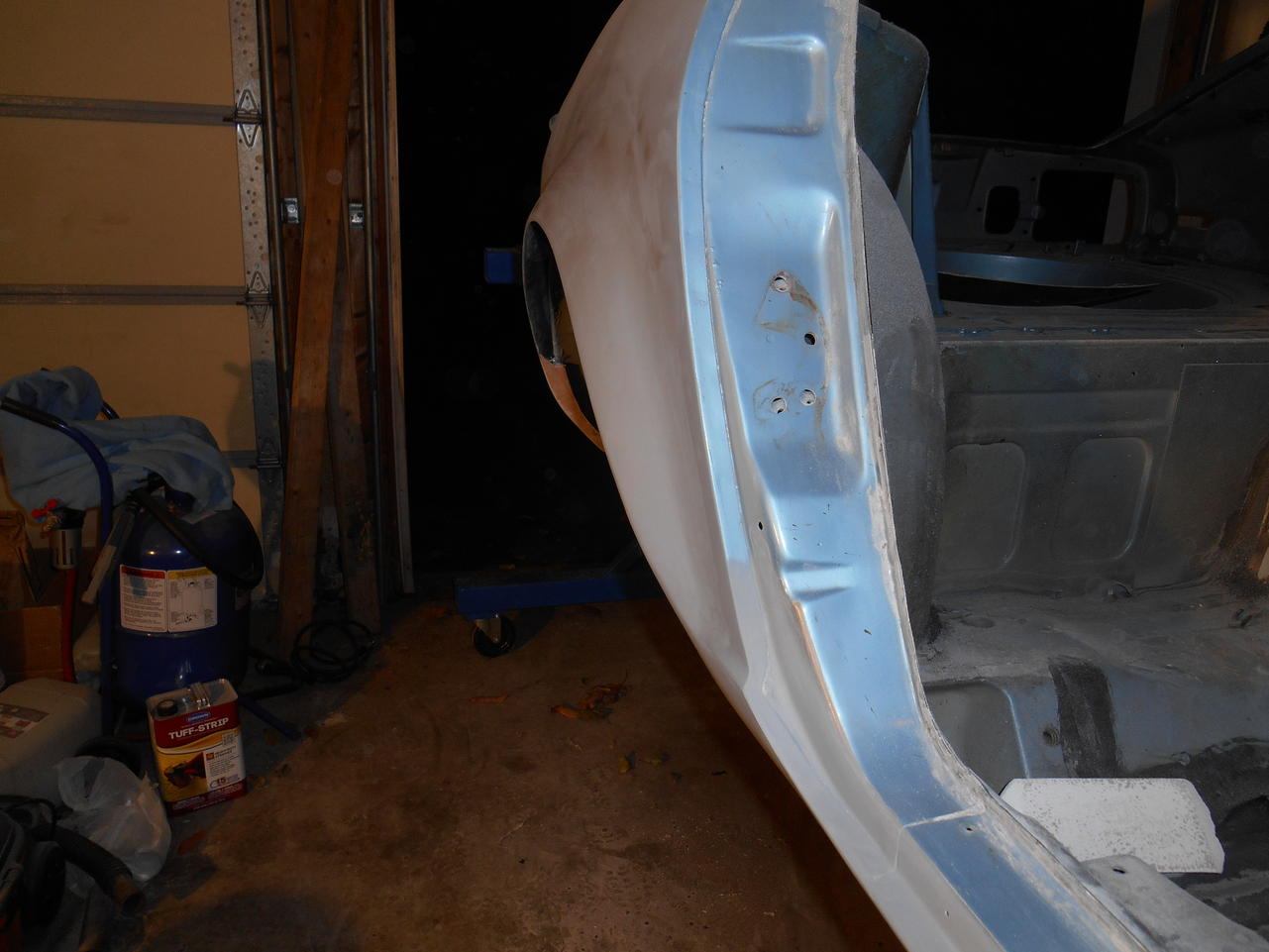

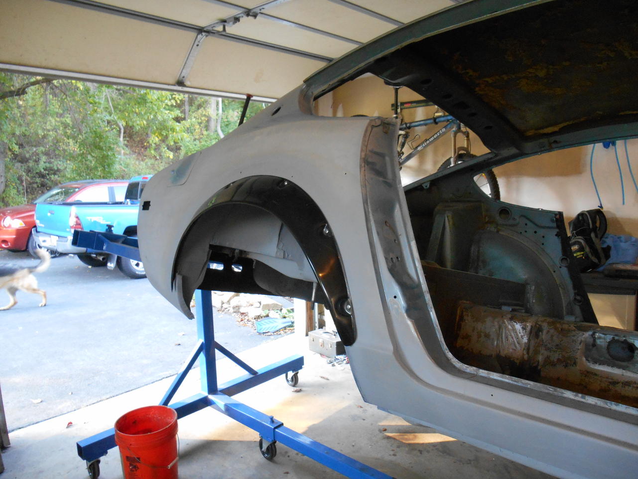

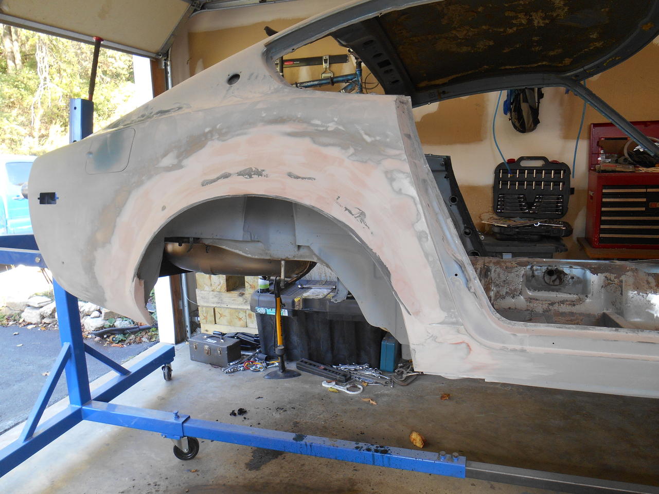

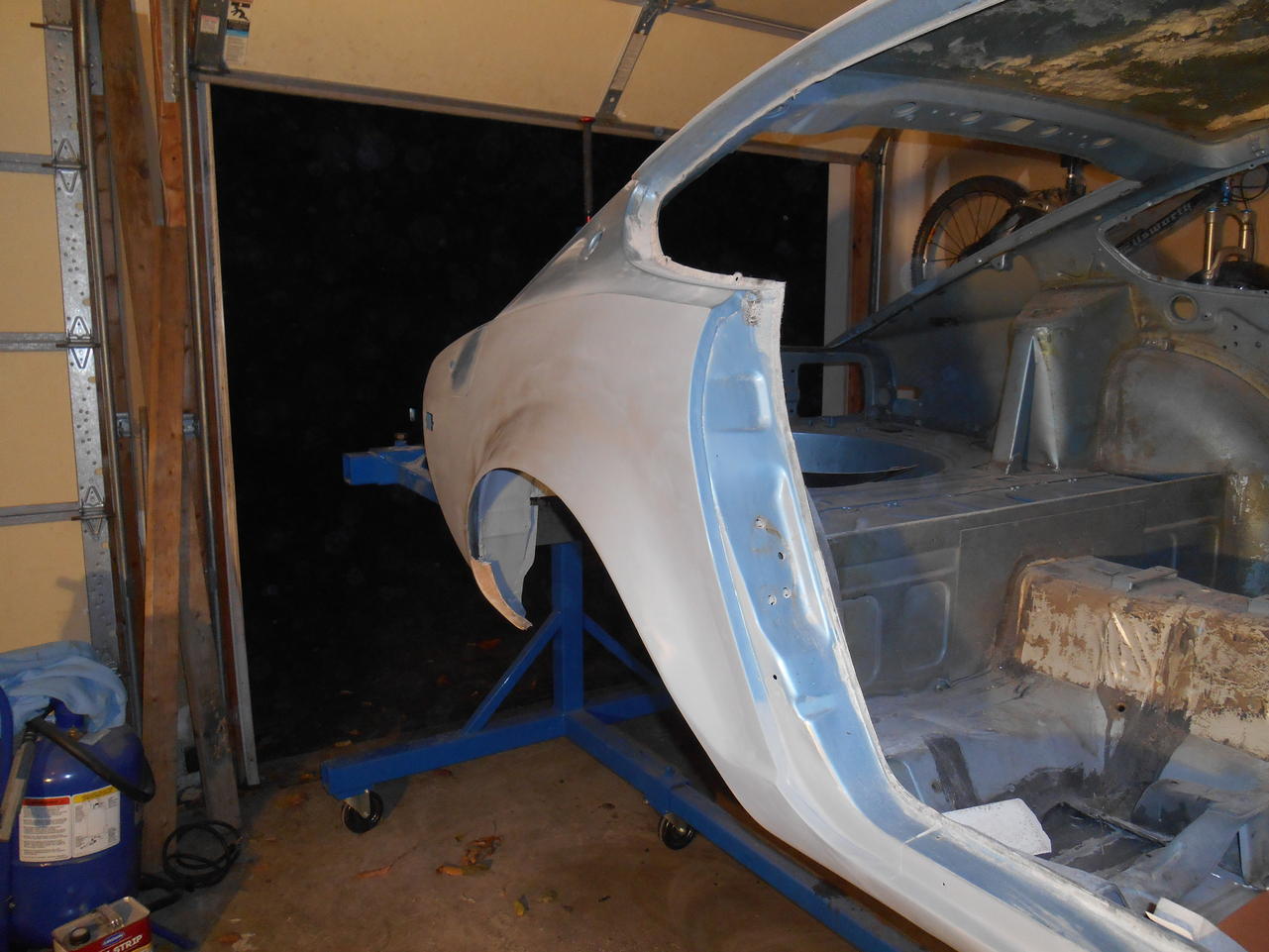

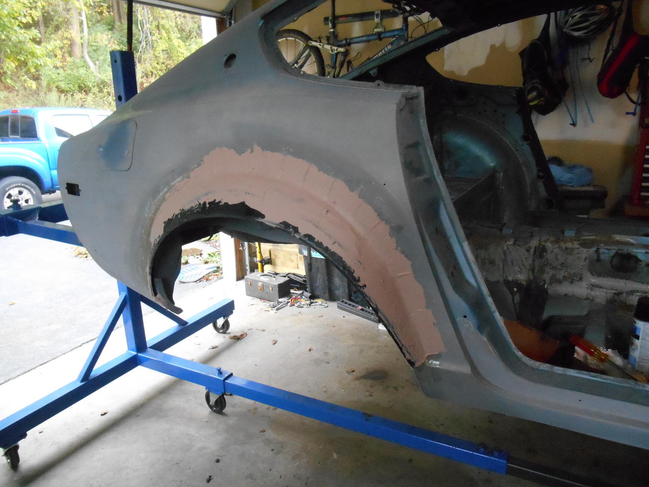

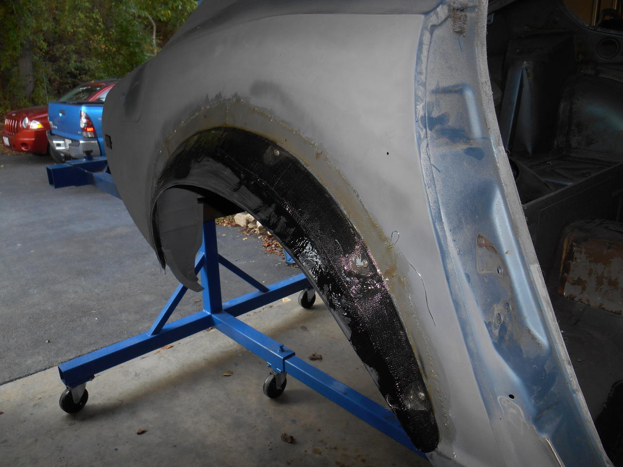

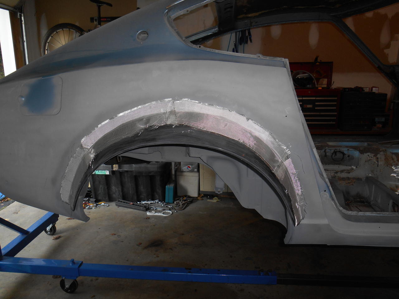

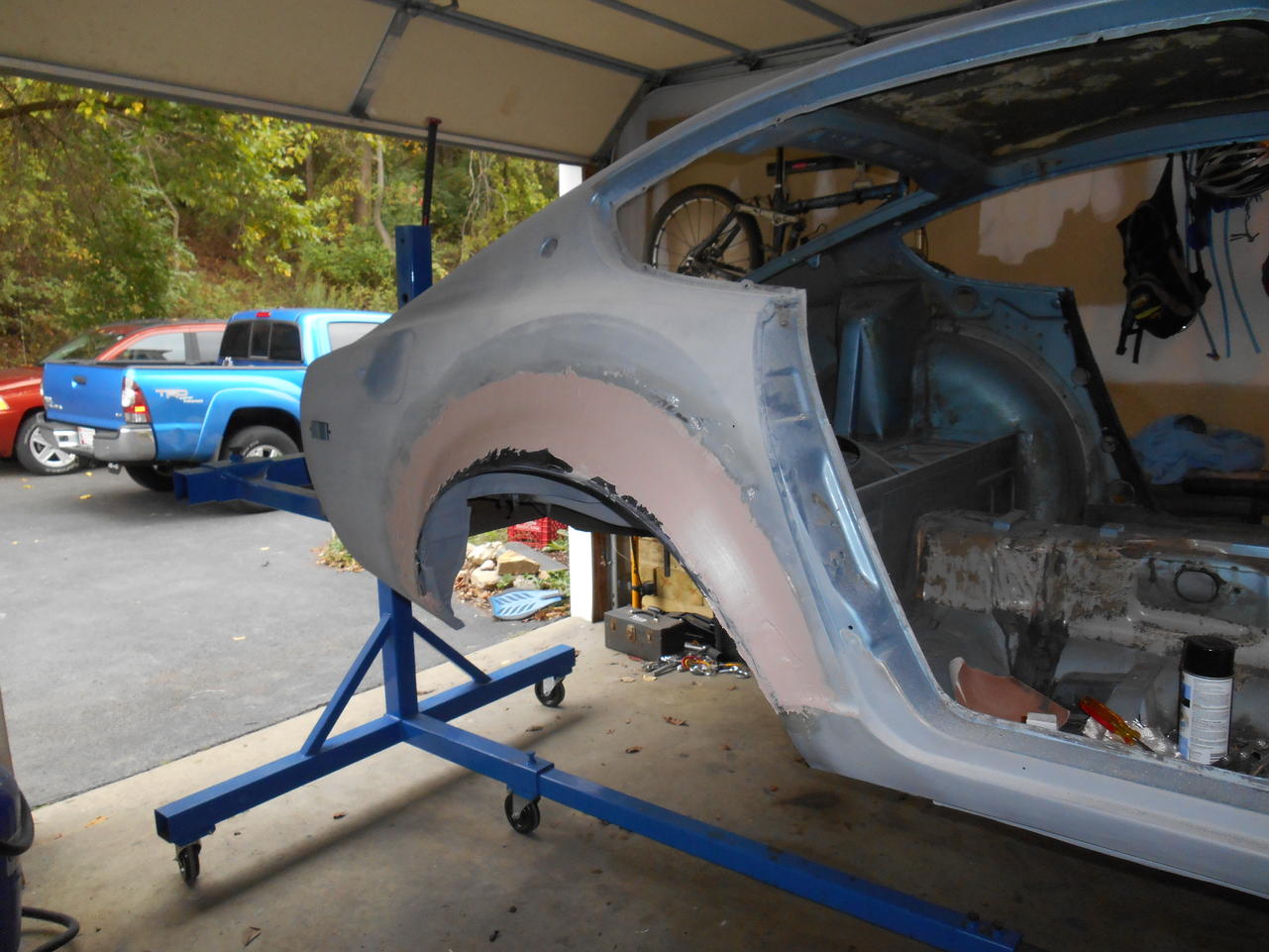

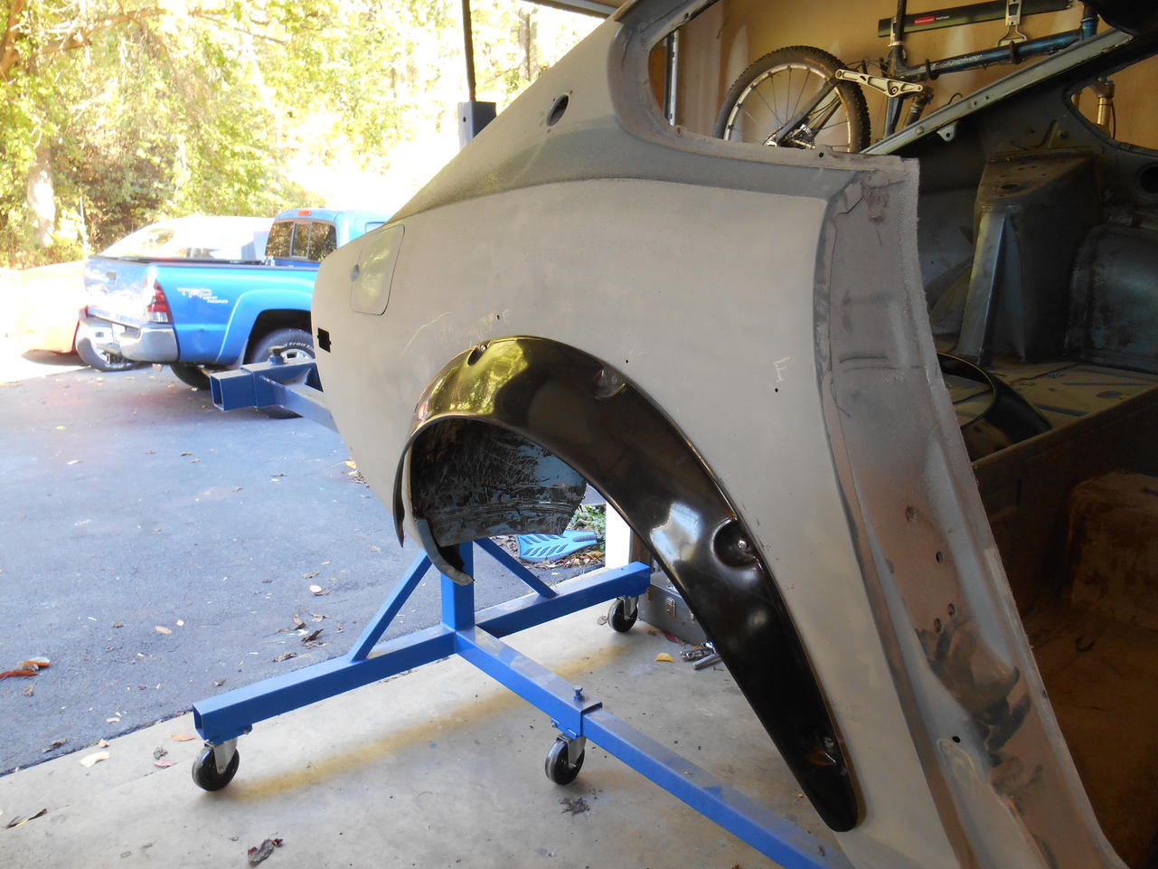

ksechler Posted November 2, 2013 Author Share #19 Posted November 2, 2013 More pictures. I am flaring the fenders. The 225's I'm using rub. Might as well fix it now. I cut away some of the fender lip. Added a flare, but I don't want the bolt on look. Since this is a full restoration this is the perfect time to do this work. Link to comment Share on other sites More sharing options...
ksechler Posted November 2, 2013 Author Share #20 Posted November 2, 2013 I'm not quite done. I sprayed it as a flaw detector. There is a little more filling and sanding needed at the back of the flare. I'm not quite satisfied with the contour. Thanks for viewing! Link to comment Share on other sites More sharing options...

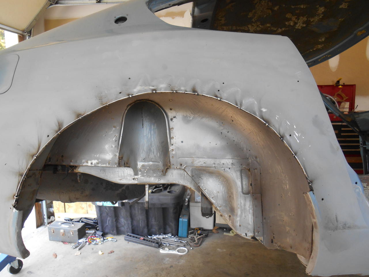

wheee! Posted November 23, 2015 Share #22 Posted November 23, 2015 What did you use for seam sealer in these pics? Link to comment Share on other sites More sharing options...
ksechler Posted November 23, 2015 Author Share #23 Posted November 23, 2015 I forgot about this post. Wow! I've done a lot since then, and I need to update this. Maybe later tonight I'll start. Funny, I actually reworked a lot of stuff shown here. For example, the home fabbed rocker front section I cut off and replaced with the front of a formed rocker repair panel. The flares... didn't like how I had done them. Took them off and started over (still in progress). The pink bondo on the dogleg? Stripped it off and redid it (right this time). The seam sealer is Eastwood's brushable seam sealer.http://www.eastwood.com/ew-brush-on-seam-sealer-quart.html I'm a big fan of Eastwood. They have some real nice stuff. Here are a few favorites: Their body filler is awesome. Sands really nicely:http://www.eastwood.com/eastwood-contour-premium-body-filler.html These are worth every penny!http://www.eastwood.com/quick-mix-board.html Use this for places you can't reachhttp://www.eastwood.com/internal-frame-coating-w-spray-nozzle.html 1 Link to comment Share on other sites More sharing options...
