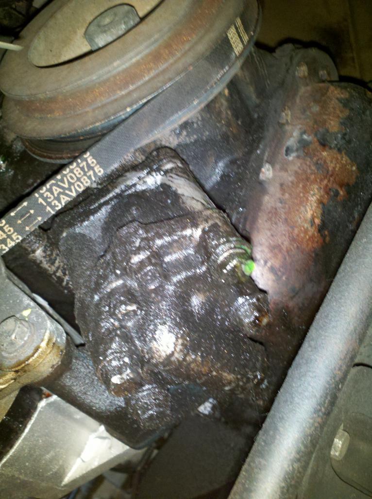

Engine Part Identification
boosd
The large thing there is the center under the crank pulley is the oil pump. It's more then likely not leaky coolant, its probably leaking from above and coming down all way there. If you look at the top left of the picture you can see coolant sitting on one of the bolts up there. Something above there is leaking. Check the water pump, hoses and all the fitting that the hoses go to.
Hope that helps
Jan
Edited by Pomorza
  • 2 weeks later...
Flushed my cooling system today, got home and checked the radiator.....no coolant, looked underneath the car, coolant dripping of of the same bolt on the oil pump,
heart stopped, grumbles....this can't be good.
Checked around and realized it was coming from the water pump weep hole.......big sigh of relief...............check your water pump
