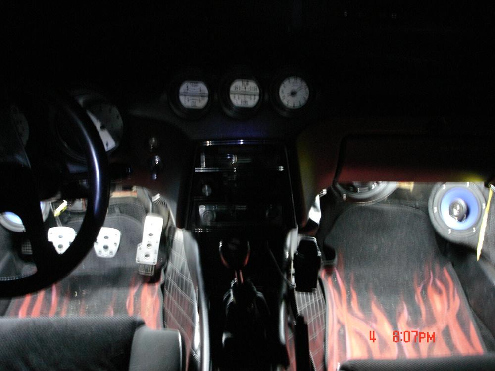

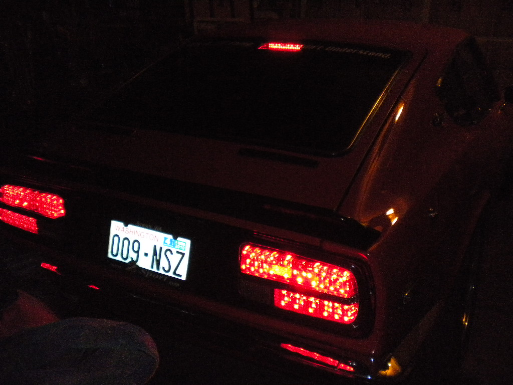

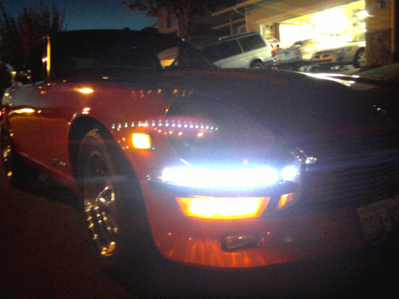

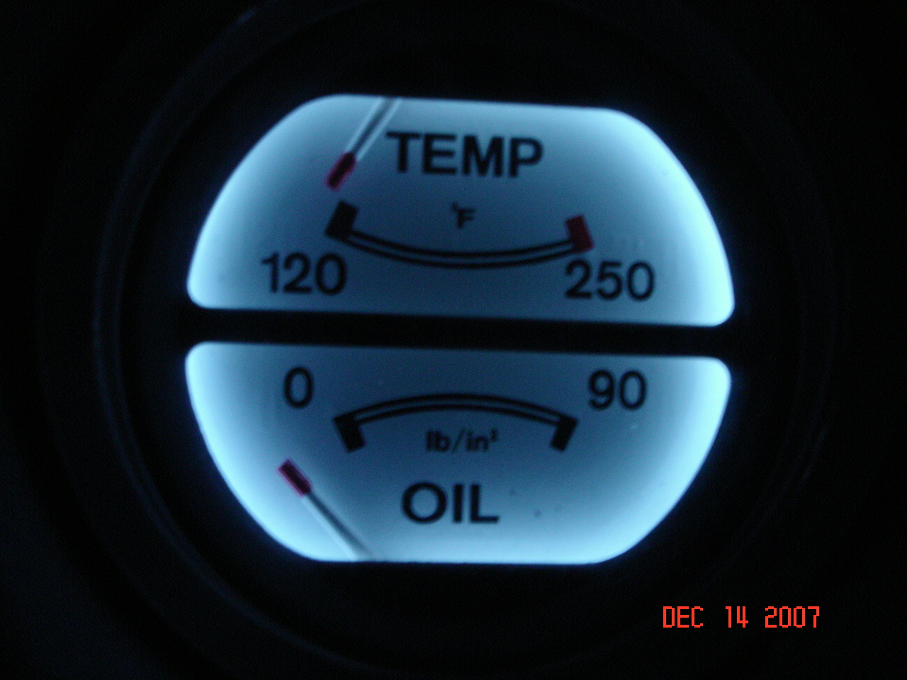

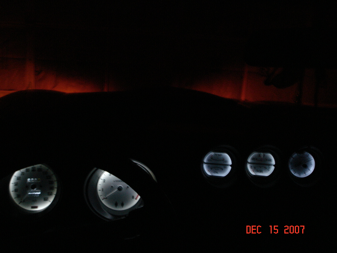

I decided to do the LED thing a few years back and have gone nuts on it all. The only 2 incandescent bulbs on the whole car are the license plate lights. I made my Map light LED array, my dome light circuit board, custom cut 4) 12 LED sidemarker lights from the Kenworth Shop, Custom made the LED plates on the Tail lights and front markers and tore the gauges apart to remove the green lenses and paint the insides silver before installing "SuperbriteLED's" and MSA white face gauge overlays. I used the the White Wide angle ba9's in the dash.
5mm super whites in the map and dome light boards
5mm 18K mcd Red LED's in the brake light boards
5mm 12K mcd Yellow LED's in the front marker boards\
Blazer 12 vdc 3 light (per side) LED electronic flasher
12" white Cold Cathode tube lights (4) underdash and domelight area

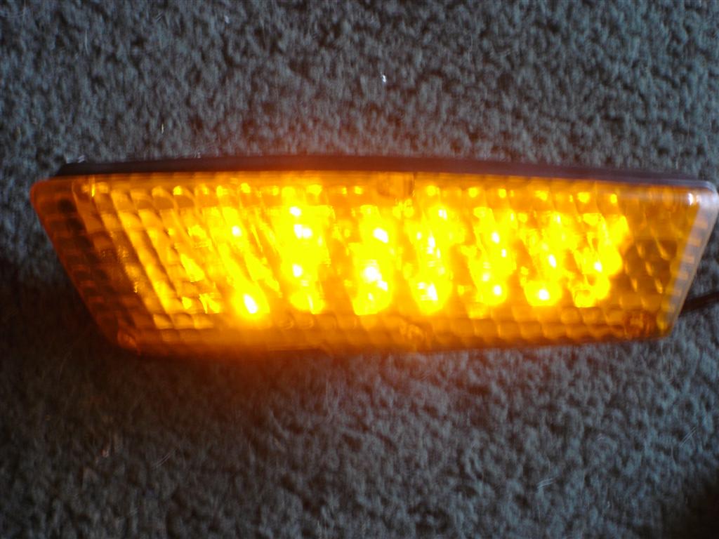

Maxxima* 12 LED clearance lights 2) red 2) amber for the sidemarkers

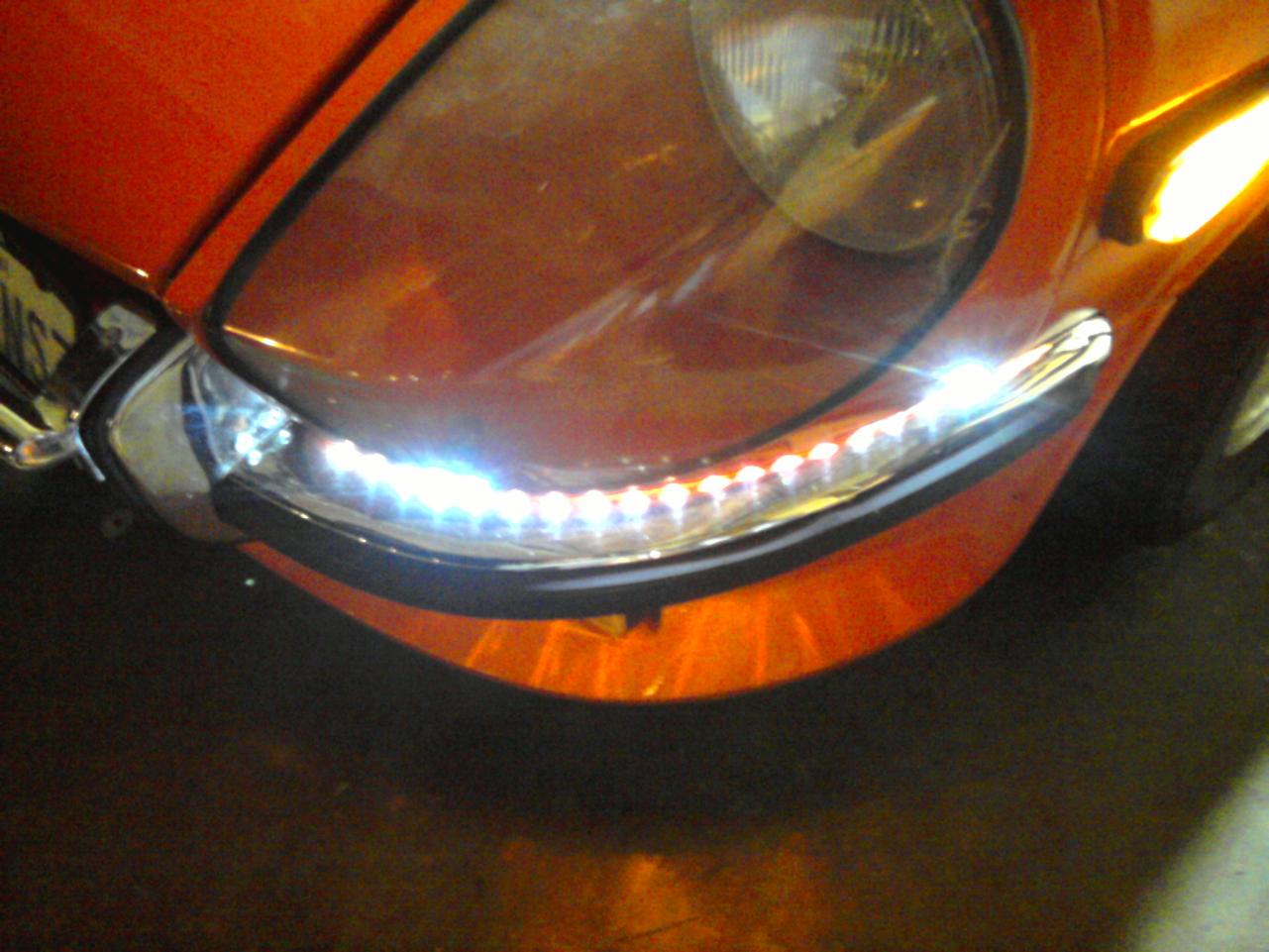

Alpena White Flexible LED strips just above the front bumpers for that Audi look.
H4 6000K HID headlights in Autopal housings.

Dave, what I love about these LEDs I used is that they are just drop in replacements. I really like how your tail lights turned out, but frankly, I'm just too lazy to try to go to the lengths you did. LOL Anyway, given what I've seen and read about the parking light circuit, I can't overemphasize the value of a solution like this. To me it's even easier to implement than your relay solution.
The dash lights are on the list for me. I just need to get smarter on taking out the gauges.

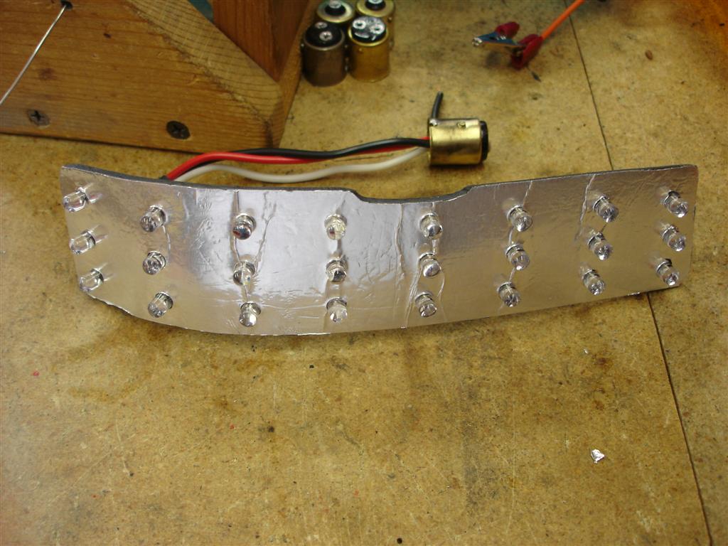

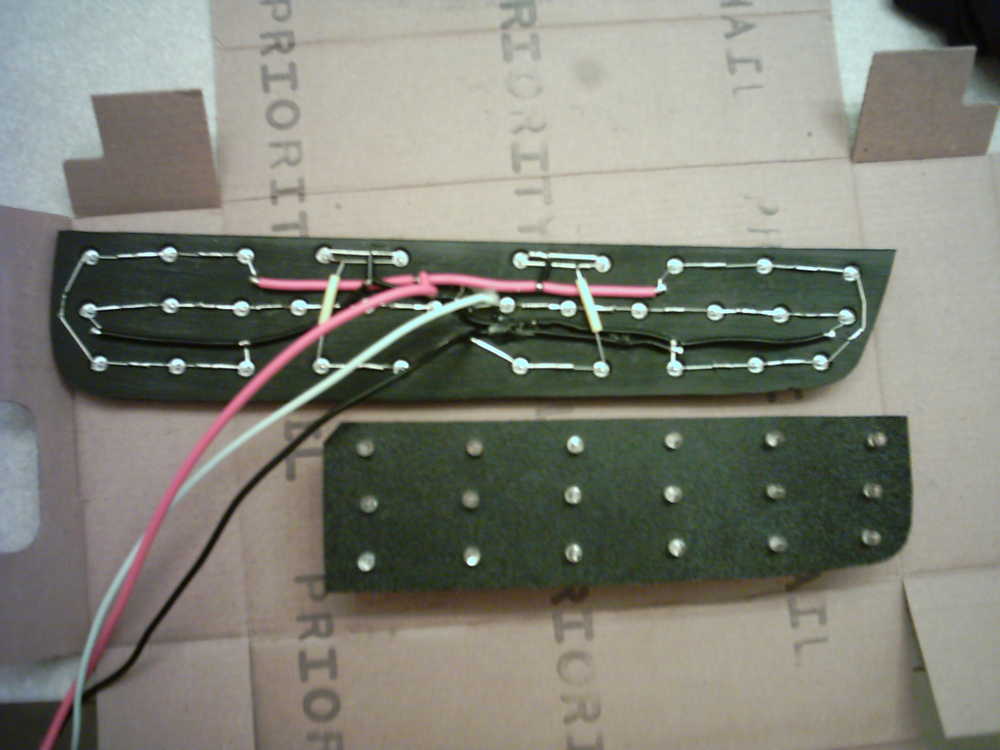

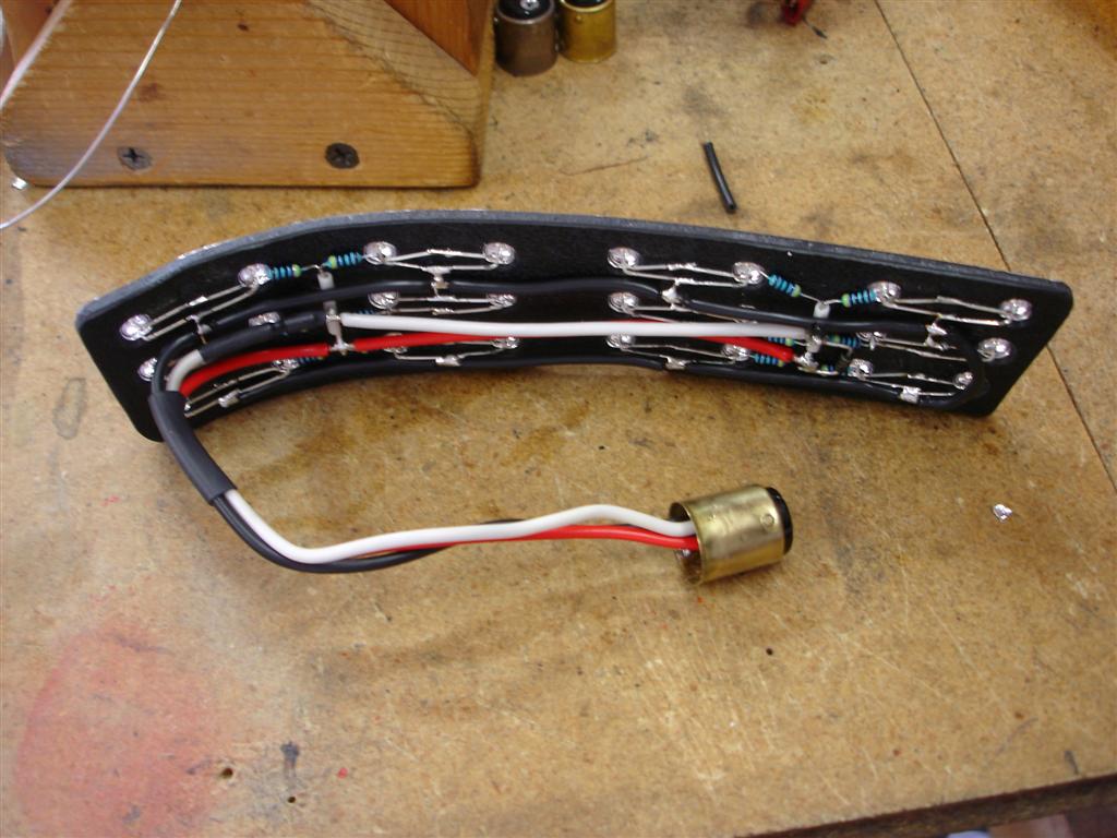

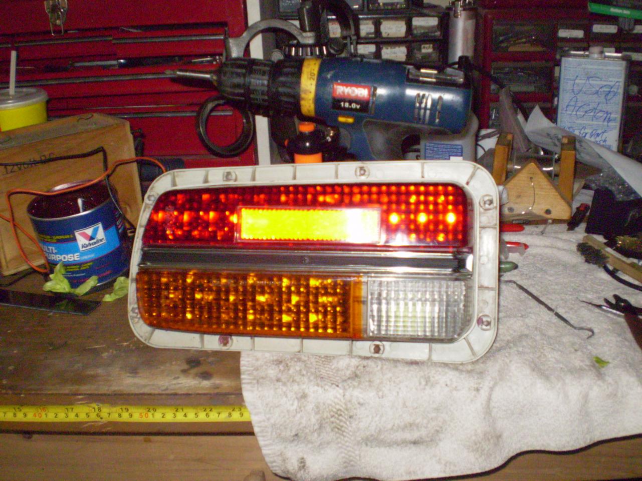

I use 1/8" Black ABS plastic. Then I use a counter sinking bit on my drill press at an exact depth to allow the LED's to squeeze thru the plate and sit further into the plate, which in turn allows more LED body to be pushed thru the opening.
Then I sand the plate face smooth, spray glue the face and regular aluminum foil for a reflective surface, cut out each hole then load the LED's into the board. Bend the leads so the grounds all connect with each other then wire in the resistors (2 LED's per resistor).

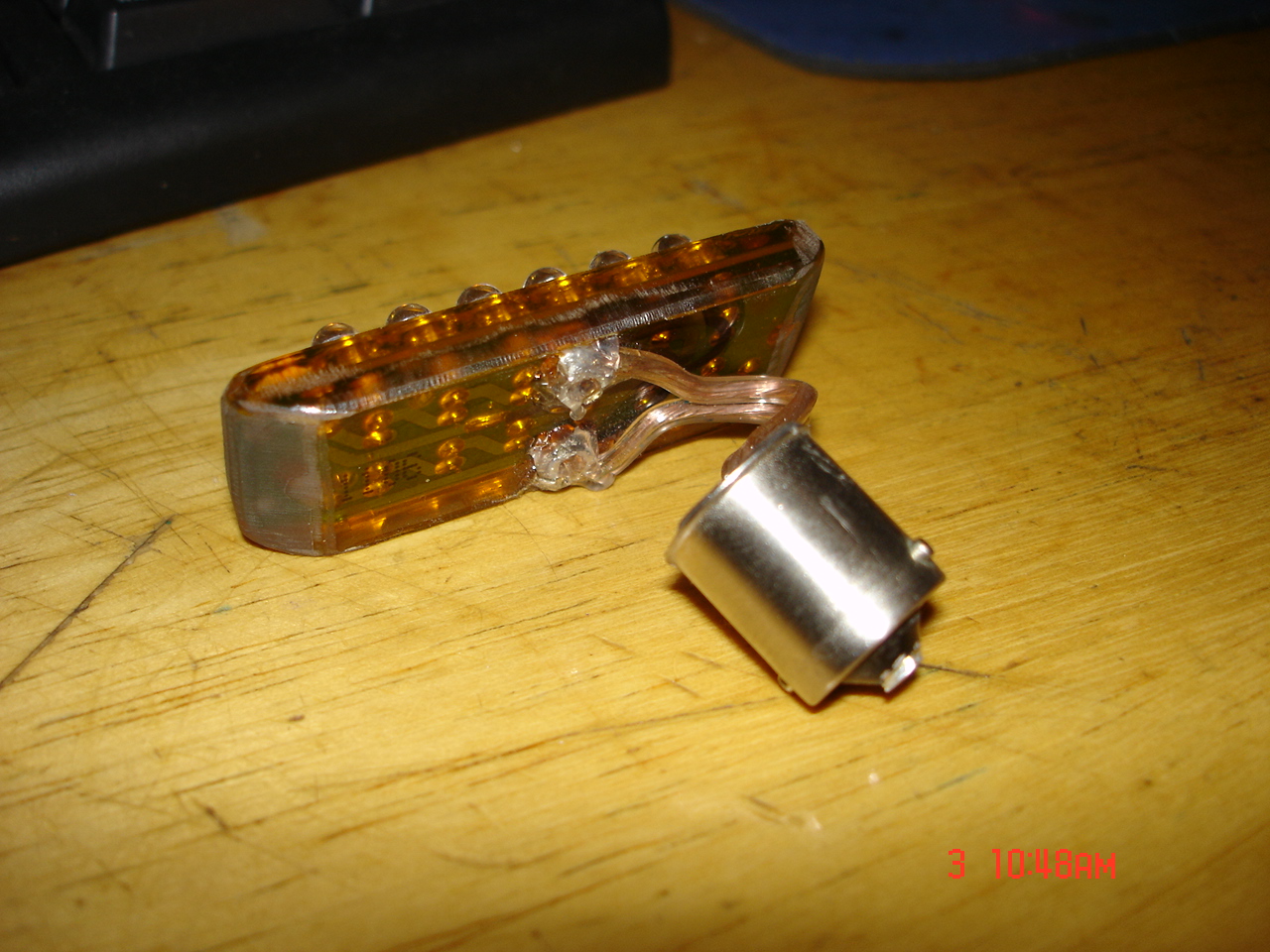

The larger plate has 2 mounting screw in the middle and the smaller board has 2 screws also, one on each outer edge. Then I take 2) 1157 bulbs and break the glass out of them, unsolder the leads and clean the inside out. Then I wire in the ground, brake and parking light wires and back fill with hot glue. Then all you have to do is plug them in like a regular bulb into the socket.
I also repaint the center of the chrome strip, polish the lenses and reglue before reassembly. And it's basically the same thing in the front. The sidemarkers are more of a plug and play deal but also do the hollowed out bulb base so things can go back to stock if I (or the customer) ever decide otherwise.
Yes, it takes a lot of labor and many hours of plate cutting, drilling, wiring, soldering, polishing and gluing and screwing, BUT it's all worth it in the end to have a STOCK looking taillight that lights up the road behind you and has a look like no other Z. I haven't had a customer complain about people not seeing their car yet. And better yet, other people CAN see the Z's better. No excuses of "I'm sorry Officer, I didn't see his brake lights"
And with a 100,000+ hour lifespan, they'll be around long after I'm gone. Especially since they are typically underpowered due to the Z's bad wiring.
Below, you can see the front markers on an angled plate, with the hollowed out bulb housings and aluminum foil. I have to glue in the front plates for lack of a good screwing surface. I also use one of the reflectors from the taillights, rebend and installed into the reverse light section for better light output from the 1156 bulb. (Customers Euro taillights)

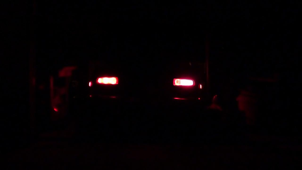

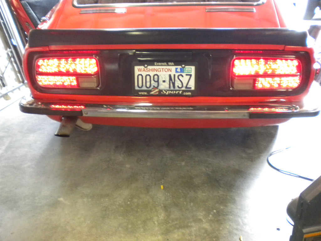

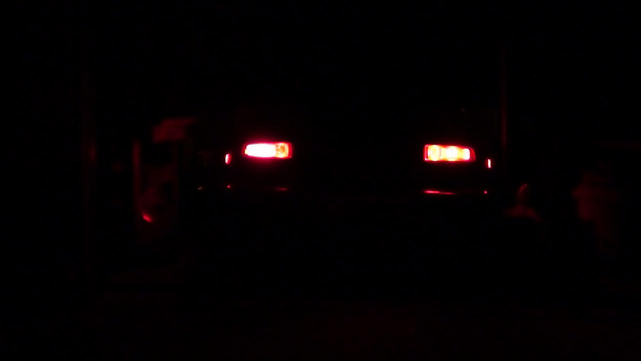

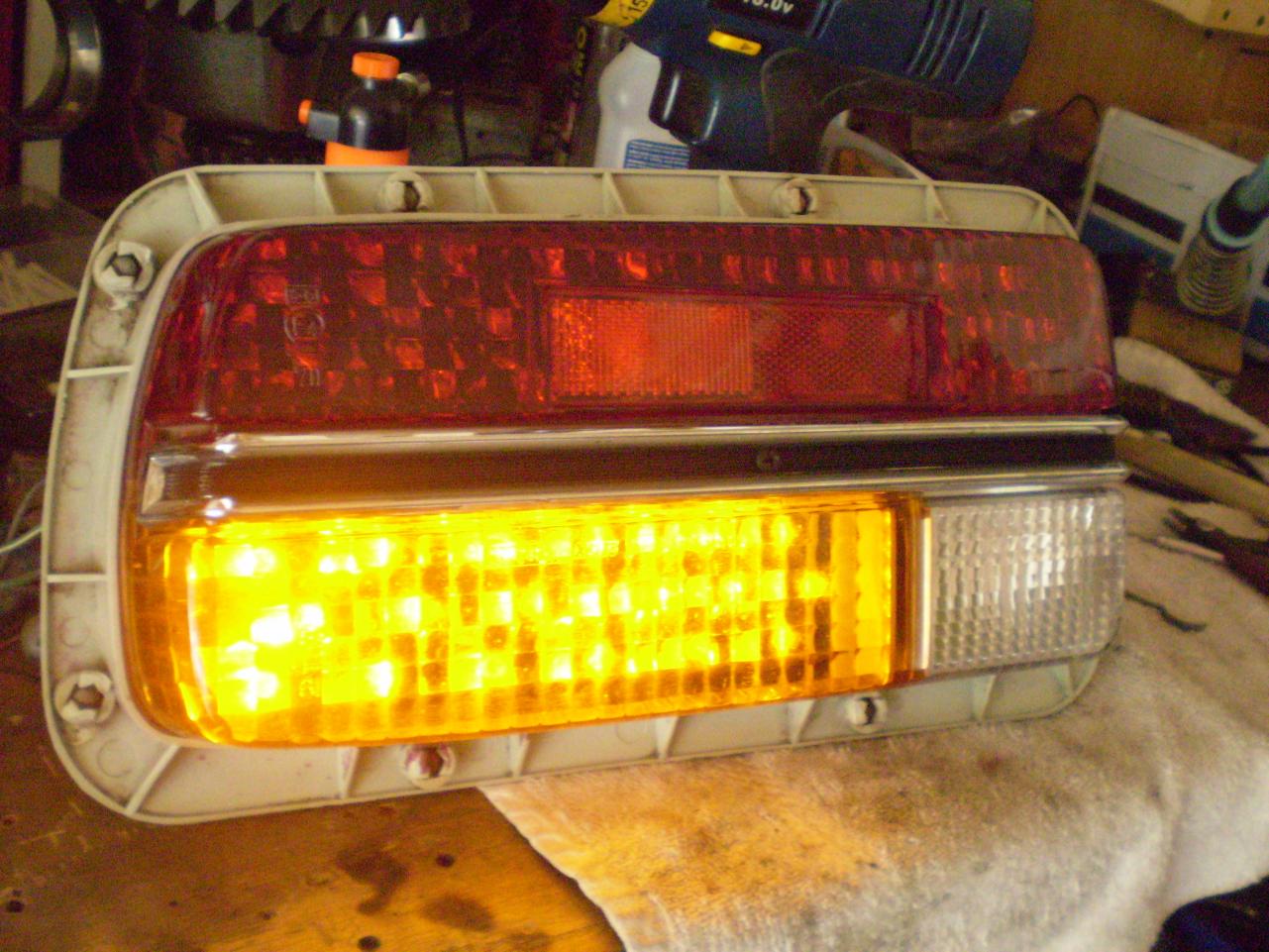

I finally took some pictures of the taillights. I swapped the incandescent bulbs from the right to the left to reduce the influence of any exhaust soot affecting the perception of the lights.
In my opinion, the 1157 incandescent bulbs are SLIGHTLY brighter. However, I have some LED 1157 equivalents with more LEDs. They do require taking apart the taillight to install since the LED bulb is larger than the opening for the socket. The 67 LED equivalent does seem to be a little brighter, though.
Considering the drop in current flow through the circuit, I'm still VERY happy with the results.
