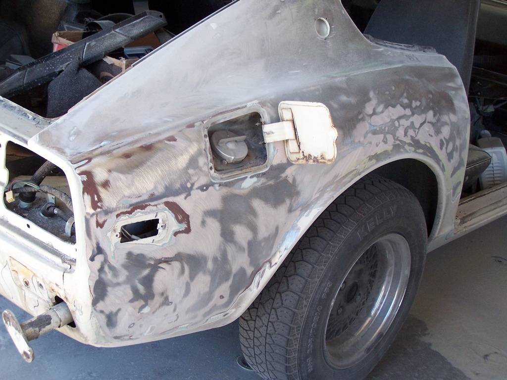

my body shop is stripping the rear of the car, and they've found what they say is irreparable rust over the wheel arch. i've seen this area rust in other cars, and i'd like to know if the rust in this area is usually just confined to the skin, or will it be likely to have bled onto the wheel housing? would it be better to just buy a rear wheel arch replacement panel, a la black dragon, or try to find a donor car? does anyone else sell a better replacement panel than BDA? i've heard tepid reviews of their body panels. which years will match my 76 when it comes to the quarter panels?
i'll be uploading a few photos later tonight.

how deep does the rust usually go? which portions do most people replace? here's a photo of mine... i know you can't really tell what's there, but it may give you some idea of where i'm at.
A bodyman, decently skilled, does not require replacement panels. It may be less expensive, but replacement metal can be welded in and finished regardless of the amount of rust encountered without having to replace entire body sections.

ok, i talked to the body guy, and he says: the quarter panel needs to be replaced, probably all the way up to the roof line. he indicated rust below the quarter window and on the rear side of the window as well. he says that a patch panel won't work for this reason, and that it would be better to have the entire panel.
i had misunderstood him last time we talked; he doesn't have a replacement panel from a donor car, he has an actual nissan replacement quarter panel. that makes the 500+ amount he wanted for it sound much more reasonable. he says he may even be able to get it cheaper than that. does this sound like a good deal to yall?
his reasoning regarding the benefits of a full replacement confuses me. when he gave me the quote for the full amount required to rust-repair and paint the car, he said $8000-9000 with additional costs for parts, worst case scenario. today, he told me that he could make a quarter panel from scratch if he needed to, but then he pointed at his his employee and said that he would have to pay the guy $125 a day, for probably 6 days of work, to fix the car without a replacement panel. i would have thought that replacing a quarter panel falls well within "worse case scenario." could he be trying to get me to spend money on a replacement part, so he doesn't have to spend his limited amount of profit on labor? or is it reasonable to expect an additional charge for replacing something like this?
also, he said something that i thought was a little fishy... i asked him if the panel he has is the correct style for my year, and he said they're all the same. aren't the 75-78 years smooth while the earlier cars have an indentation for the bumper?
I don't know the exact years but you are correct. There is a bumper indention on the early S30's. I wouldn't jump the gun yet though. He may just not realize that unless he specializes in Datsuns/Z's.
But... Definitely confirm the part is OEM before dishing out that kind of cash.

I am thinking that he is looking to plump up his margin. I would almost pay him for the work he has already done (get a receipt), then I would take it somewhere else. He is going to Rob you and then when the work just isnt quite right - there will be all of these excuses. I am telling you - Listen to my keyboard....
From the pics, it just looks like a bunch of Bondo, I did not see any catastropic rust. Sometimes these body guys get lazy knowing that they can do a panel quicker than putting work/skill in fixing a repairable panel.

Here is my Tabco panel install on the right side. The Tabco's are less "crisp" on the folds (more rounded) and are pretty easy to distinguish from an original unless you do some hefty work on them. I was going to just do the doglegs but ended up having to do both wheel arches as there was lots and lots of bondo and some rust from behind spots... My car has 300K+ miles on it so my goal is "nice" instead of perfect. I'd say the way Guy is doing his cars (all datsun panels) is the way to go if you can. :beer:

I would be leary of anyone who claims they can make a quarter panel from scratch. Also, the price of $500. for a genuine Nissan replacement quarter is not even in the ballpark. In most cases where the dog leg, outer wheel arch and outer wheel housing has been severly rusted it does not advance any higher than the lower half of the outer wheelhouse. There will be a fair amount of surface rust extending higher but not to the extent that the metal needs to be replaced. Ask to see the replacement parts before he starts any work. Don't let him tear into it before he has the parts in hand. Then you will know "whats what".
I agree with ZCurves and geezer. Be aware or at the very least suspicious of anyone claiming to be able to fabricate a whole panel from scratch. I also agree that it is very rare to have that much rust above the wheel well that would necessitate the replacement of the whole panel without showing some easily seen sign. I had damage and repair on both quarter panels that required new panels. My body guy and I knew there was something going on with one side more than the other, but when the damage was more than we thought and had talked about, he stopped to show me what was going on. Literally stopped and waited until I could get there to look at it and see what he was explaining to me and just how much we needed to replace. Attached are some shots of my car; the before during and after the quarters were done. Body work does not come cheap, but what he is quoting you seems to be on the very high side to me. Just make sure in addition to a written quote, that he shows you what he is talking about and just what needs to be replaced. If it is rust that is need of being replaced, then it should be rust and not be able to hold together. Surface rust is one thing, rusted through is fairly easy to tell. You can poke holes through it, which is what my dog legs were like, under all the previous bondo and repair work. Good luck.
From the pictures in your Flicker account.... $8-9K for just the manual labor... WITHOUT extra for parts seems more than reasonable.
You had/have rust in just about EVERY major component of that car... Rockers, Front End Fender supports, Doors, Hatch, Hatch Sill, Floor pans, Roof (just above the windshield), the whole rear quarter panels INCLUDING below the quarter windows.... then to boot it was all covered with thick layers of bondo (and those cute little "flame" stripes up the back end which then got painted over) and at least one or two re-paints. What is NOT visible makes me shudder.
Without seeing the actual quote and talking to the guy to find out what he did and did not include in his quote, (patching in new metal, D/A'ing or stripping paint, sourcing the parts) it is extremely irresponsible to automatically assume that he is ripping you off or robbing you. Go ahead and pull your car only to find that the next body shop simply tells you to get lost, as they will not work on it.
Your car was a literal can of worms, just from the pictures you posted as "before", where you highlighted the problems YOU found. In another bodyshop, they would have told you to go find a better car or would have given you an "Earl Scheib" job and really ripped you off. That he even bothered to quote AND take on the job, may be more telling, or it could be your insisting that he do so. He may need the work desperately, or he's doing you a favor. But your car has a lot,and I mean a LOT of issues. Even if you were family you wouldn't get it for free, and unless he's into serious (stupid) charity, he's not going to give his time away, he still needs to eat. There are several hundred hours worth of work needed on your car, and from the looks of the disassembly pictured, you were looking for a complete restoration. Those do NOT come cheap.

As far as "repairable" and "unrepairable" rust... it basically comes down to time, money, tools and expertise. Plenty of all of these and you can re-create anything. (Look at the guy that built a wooden Lamborghini, or the miniature V-8 that runs.) Fabricating a whole panel from individual pieces of metal CAN and HAS been done, doing it from a single sheet of metal requires the molds, which is where Tabco comes in.
And, instead of accepting the advice of anyone who hasn't laid hands or eyes on your car directly, myself included, when it comes to the extent of the rusted metal and the amount of metal that should be replaced, trust your bodyman. If you try to micro-manage what he does, he's likely to tell you to take your job elsewhere or simply tell you that he won't guarantee the work.

I am the guy with the extra OEM (uninstalled) quarter panel that the shop is going to use for the project.
The shop restored my 240Z (read in another one of my posts if you are interested in the project). The price quoted for the part to saridout is completely accurate. I am not the greedy sort of person who has to make a killing on a rare part. (There are many people out there who have rare parts who want an "arm-and-a-leg" for what they have.) I have collected many parts for my project that I do not ever plan to use, this quarter panel is one of them.
The shop in question does exceptional work and I am indebted to the owner for the care and attention in my project. My indebtedness only refers to my gratitude for efforts as my financial obligation has long been settled.
I have seen saridout's car in person and agree with the shop's description of the work needed, presuming the car's owner wants quality workmanship. There are many shops that specialize in collision work that can do a fast, cheap repair. If a car owner is looking for quality restoration work, then the car is at the correct shop!
