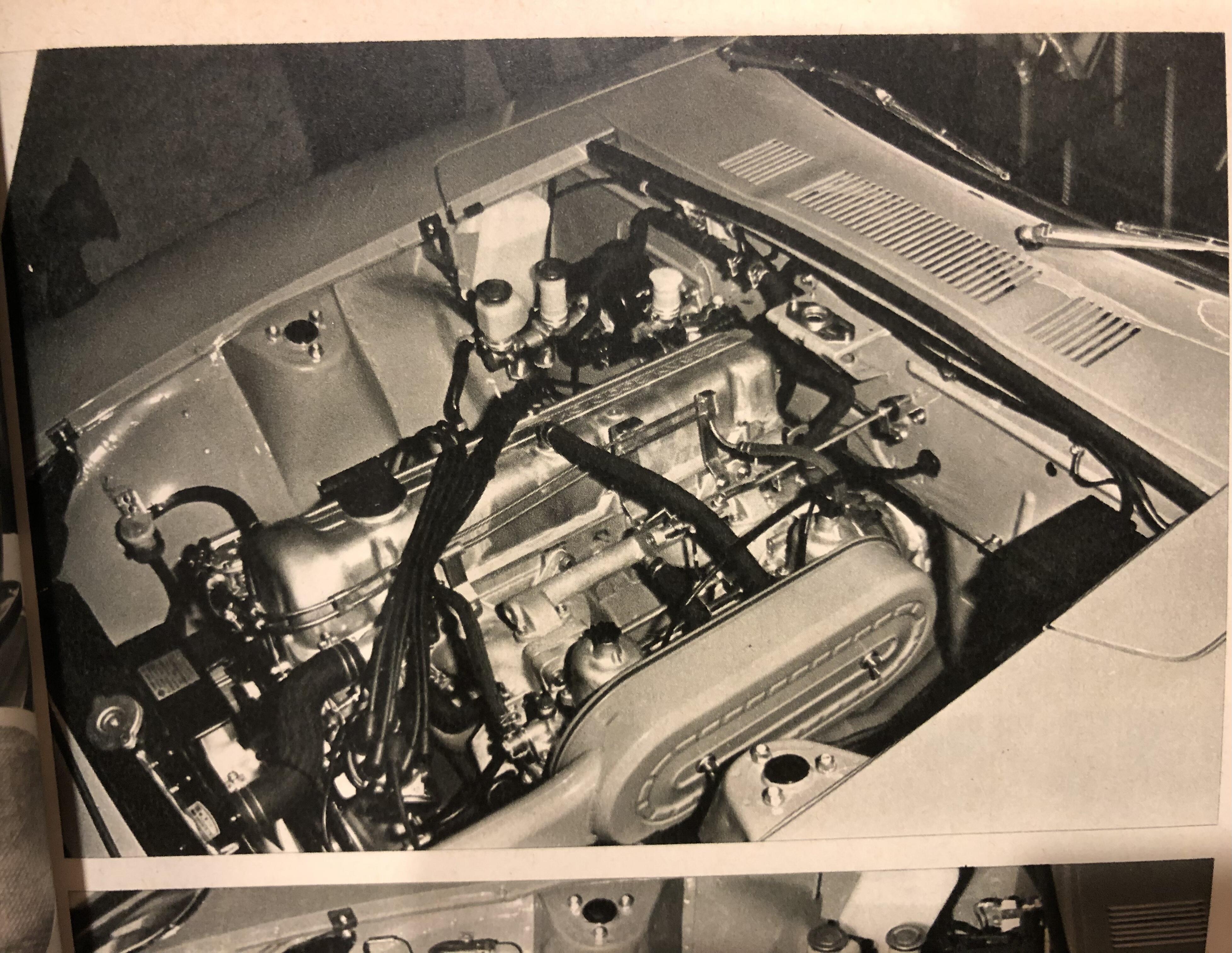

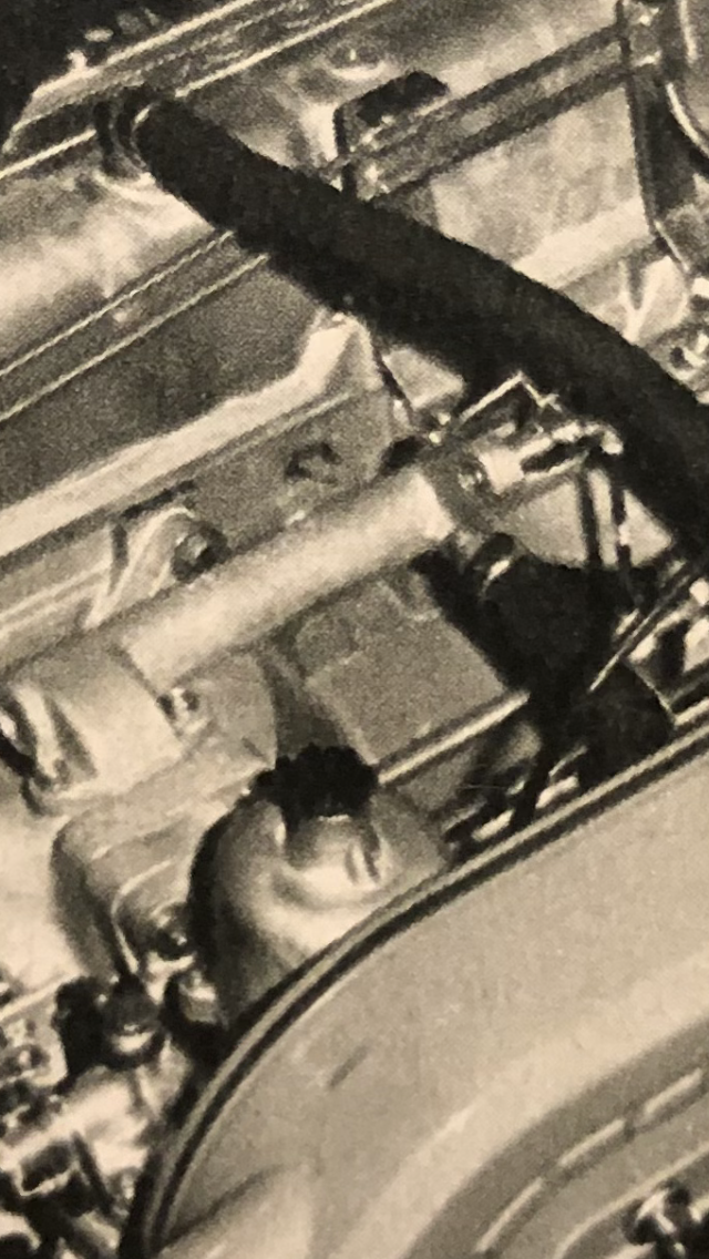

And the same strange situation with the engines: a block cast earlier with a higher machine number than a block cast later (although days later).  I would assume that the engine ID number was assigned when the casting was machined?  What do the 'A' and 'D' mean?

Probably later. Either when the engine was complete and signed-off as OK, and/or when it was assigned to a destination/batch of cars.
Factory replacement/motorsport L24 blocks were supplied machined, but without an engine number. Seems to indicate the above.
No real surprise that engine block casting dates/batches didn't match up with assigned engine numbers in a completely linear fashion. Stack up a rack of block castings and they could get mixed fairly thoroughly as they passed through the stages of being cleaned, machined and built up into complete engines. Last on the rack, first off the rack etc. All coming out in the wash over a certain time period. I wouldn't expect very many "Oh! I just found one down the back of the shelf" type scenes.

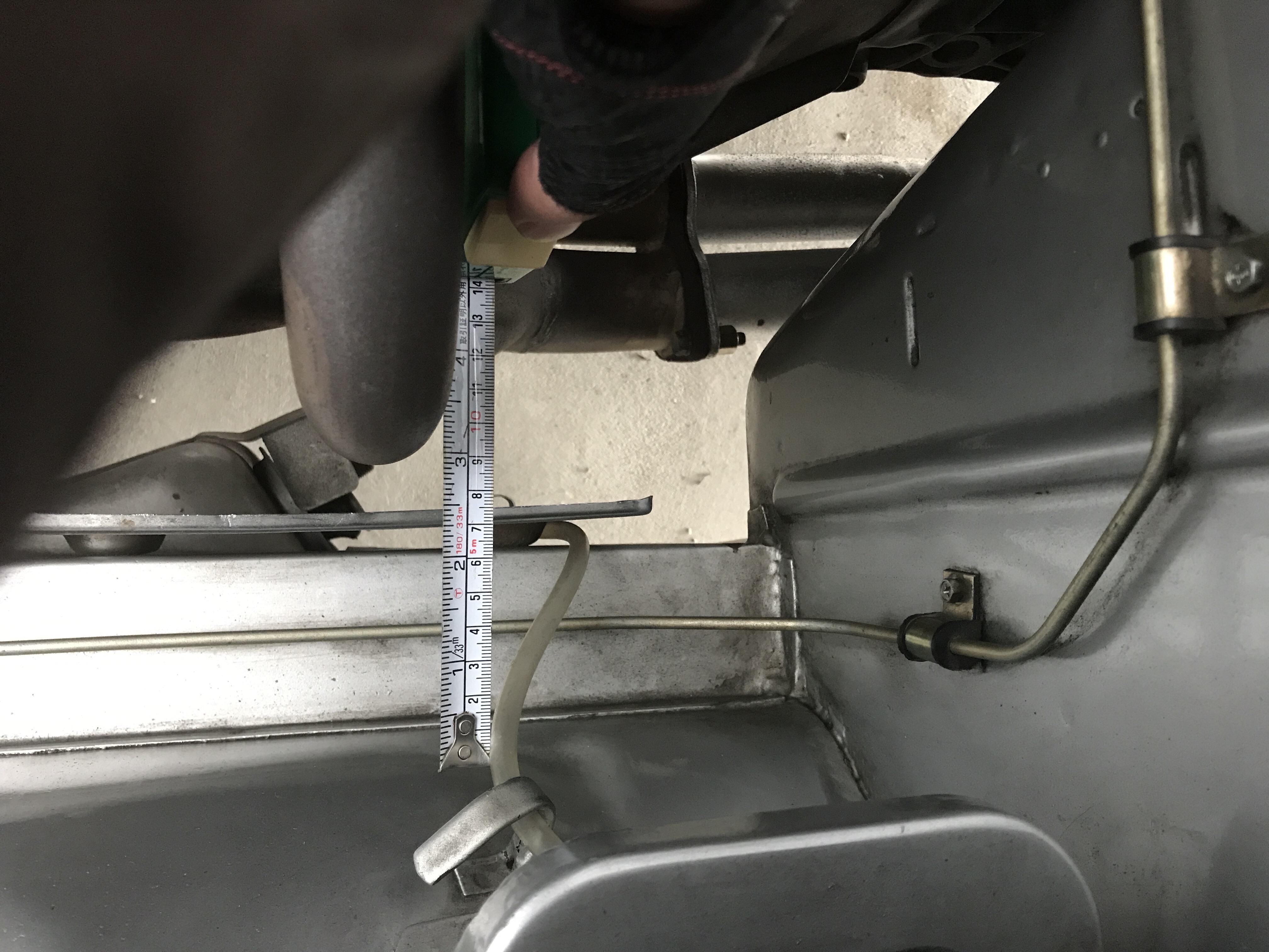

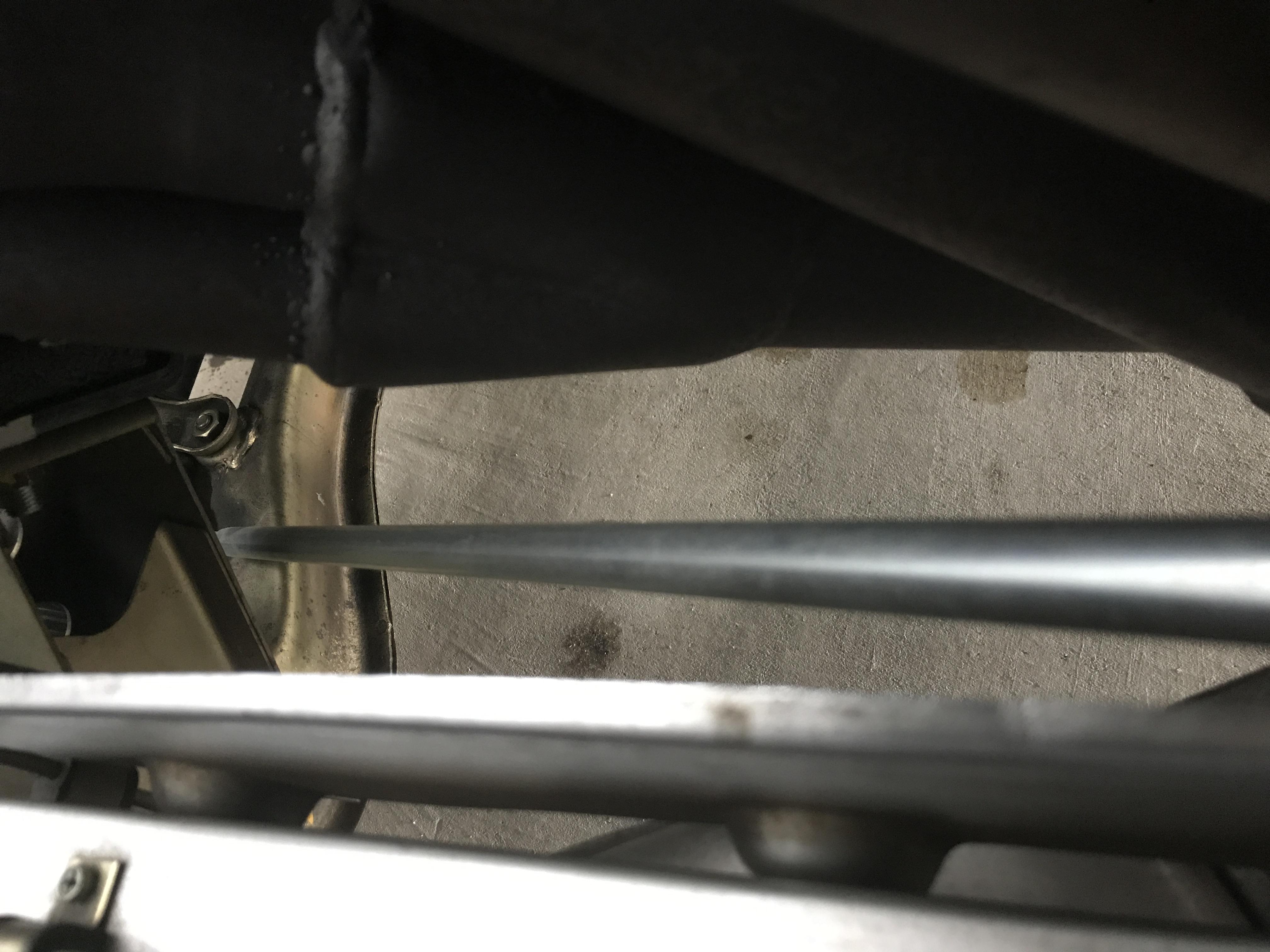

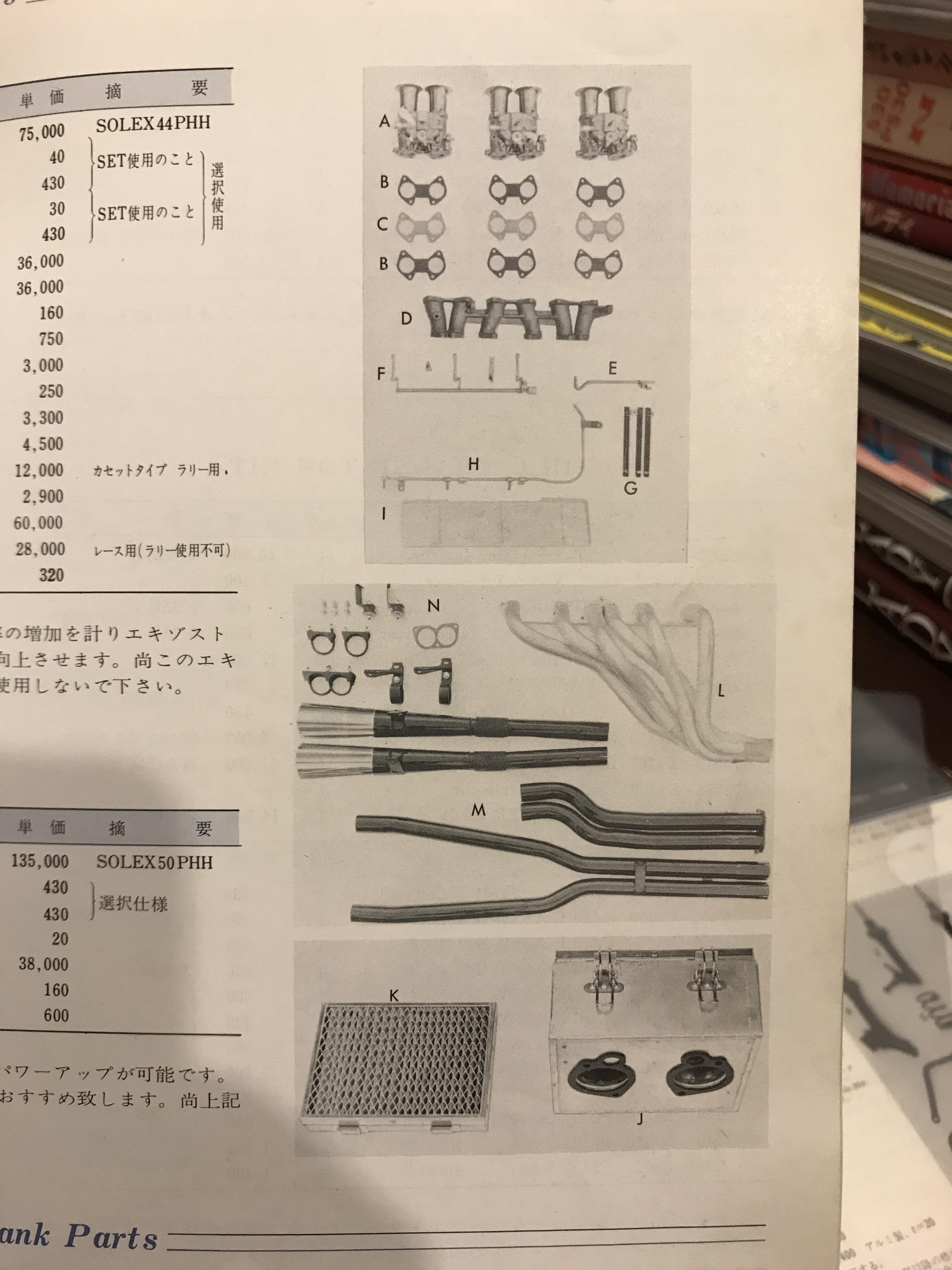

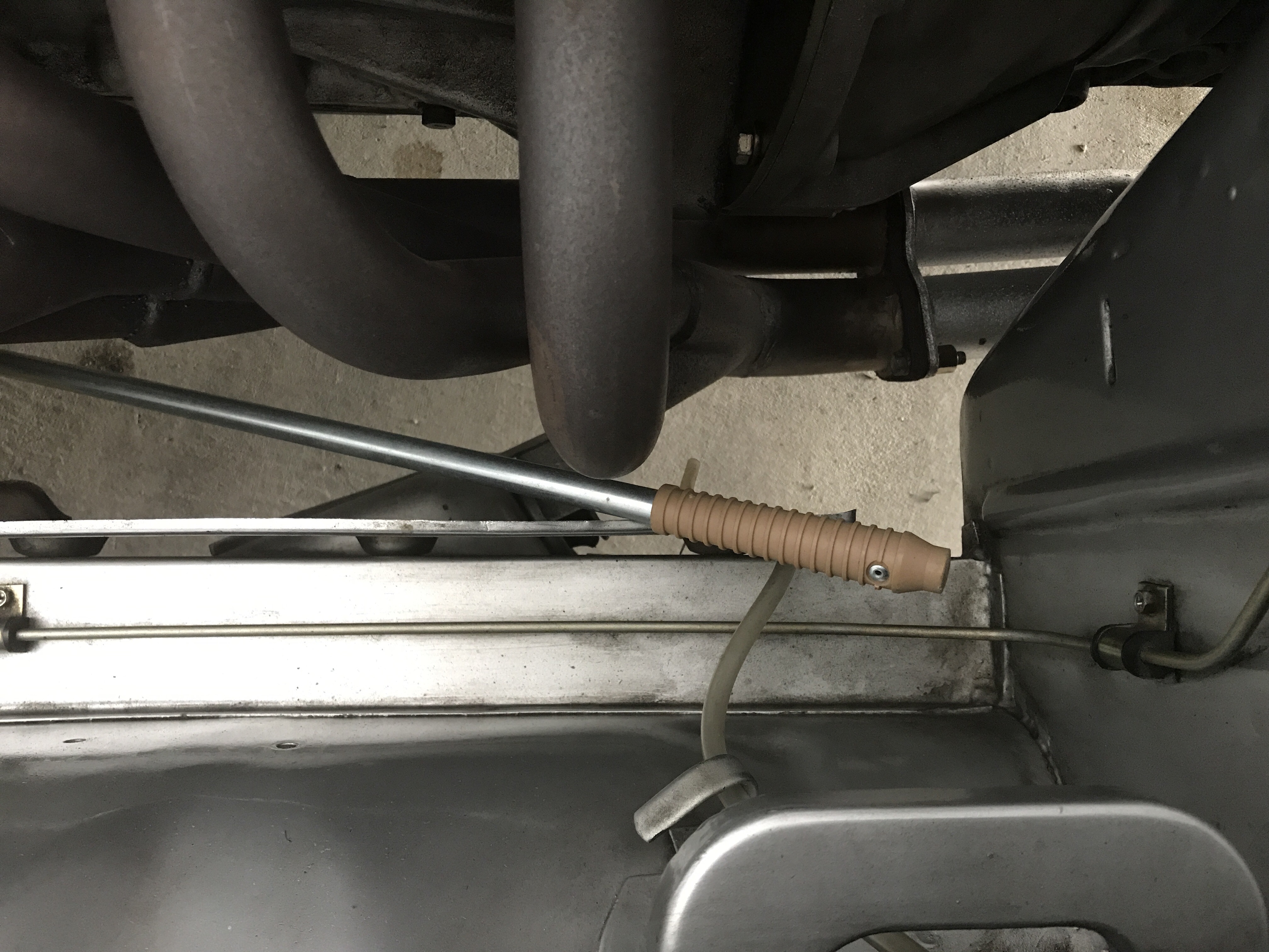

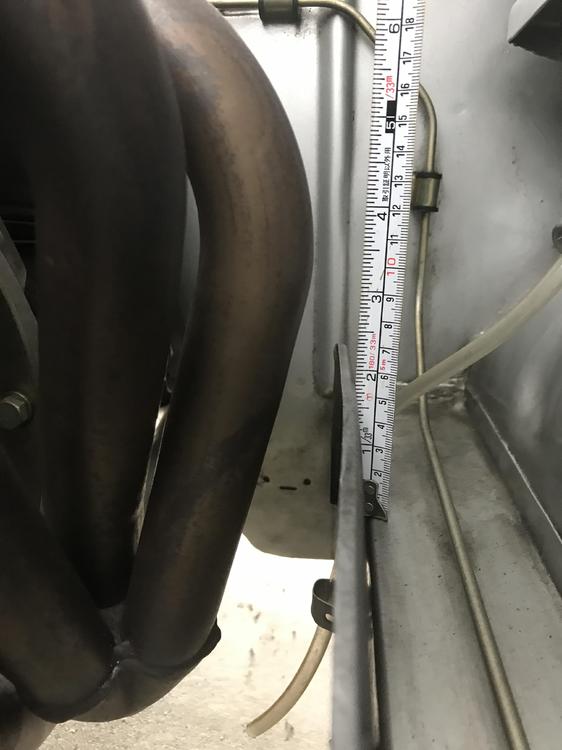

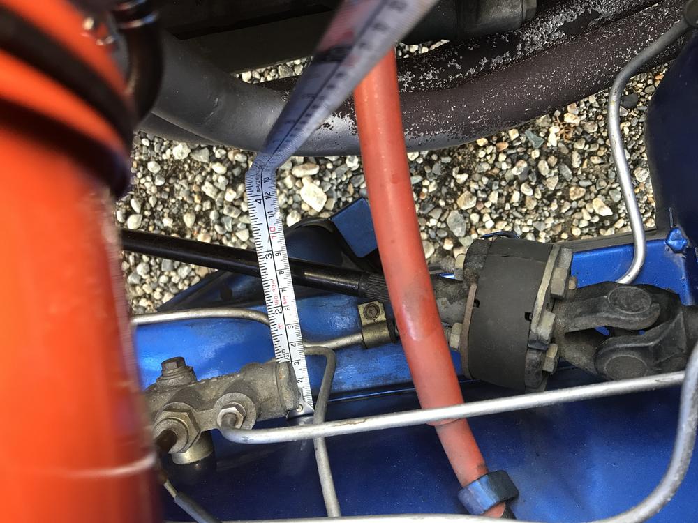

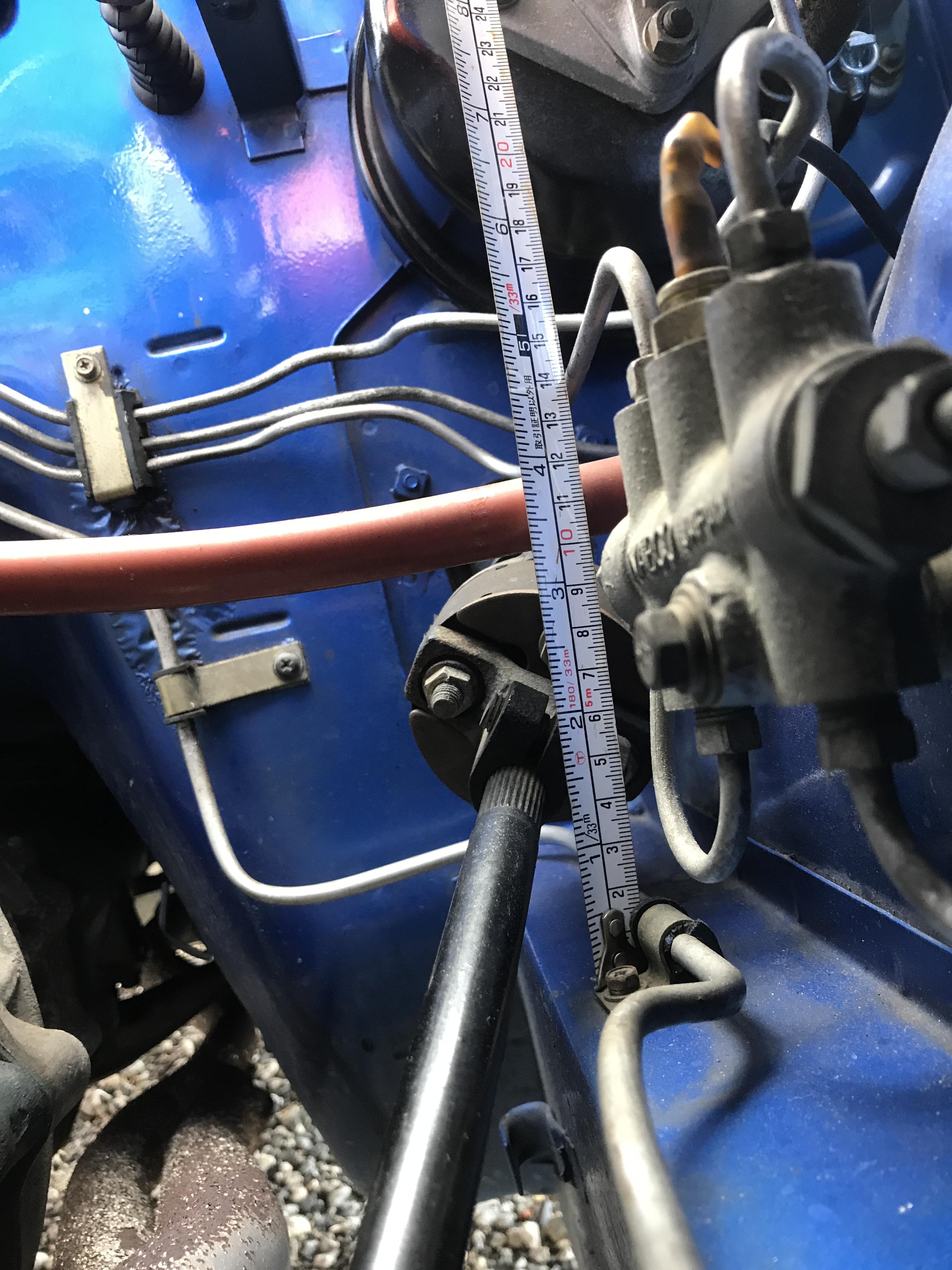

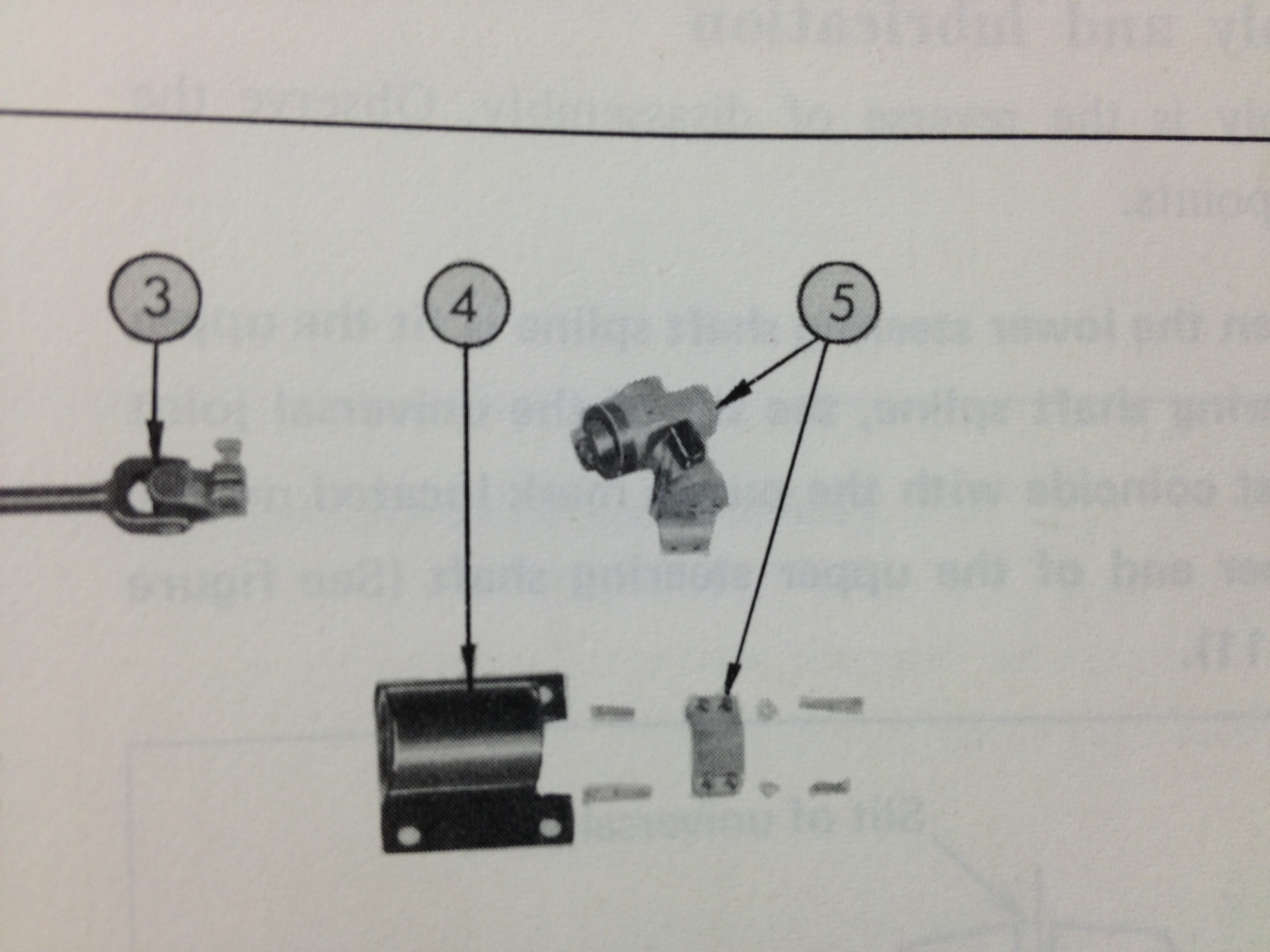

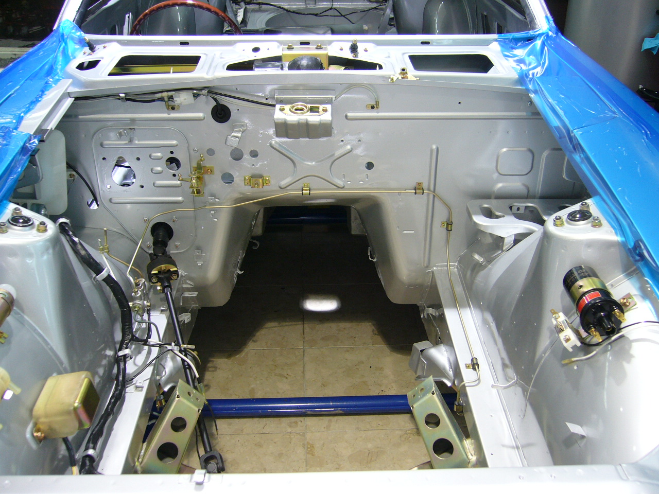

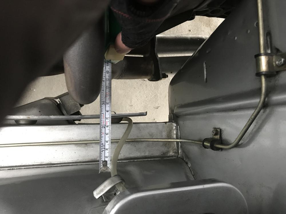

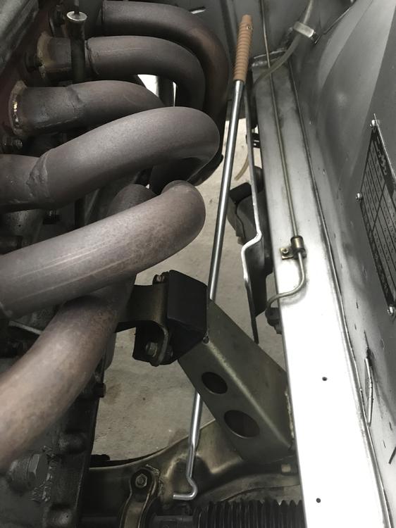

By the way , I did dry fitting of the Nissan sports option exhaust system, I am wondering the steering rod from the LHD 240Z would possibly obstruct the pipes . I hope not …
Kats

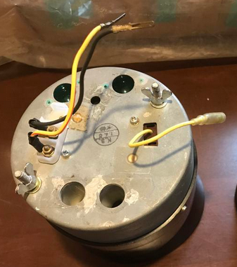

I think anyone who's spent time working on these cars will appreciate how each component is made or engineered. Having pulled apart the OEM AM radio I was fascinated by the engineering in the mechanical tuner and how intricate it all was (before all that kind of thing was digitised), same for the Harada Antenna and even the combination switch for the headlamps etc.. once you've pulled it apart and repaired it, you gain an appreciation for what went into making the product. Especially considering this was all pre computer aided design. The Rally Clock is next level in terms of the oscillator box, I have had several repaired by Ron at ZClocks and I find them as fascinating piece of technology - albeit temperamental.
  • Like 2
Hi Gavin, you scored nice original radios and clocks,
I am so surprised that the average price of them are skyrocketing. I was hoping to get one for my second blue 240Z , but I will never be able to get one .
Fairlady Z series didn’t have an automatic seeking system for the early radio . So I cannot look for the one in Japan .
Maybe I will put my 8 track audio system or just a pocket for my second blue 240Z .

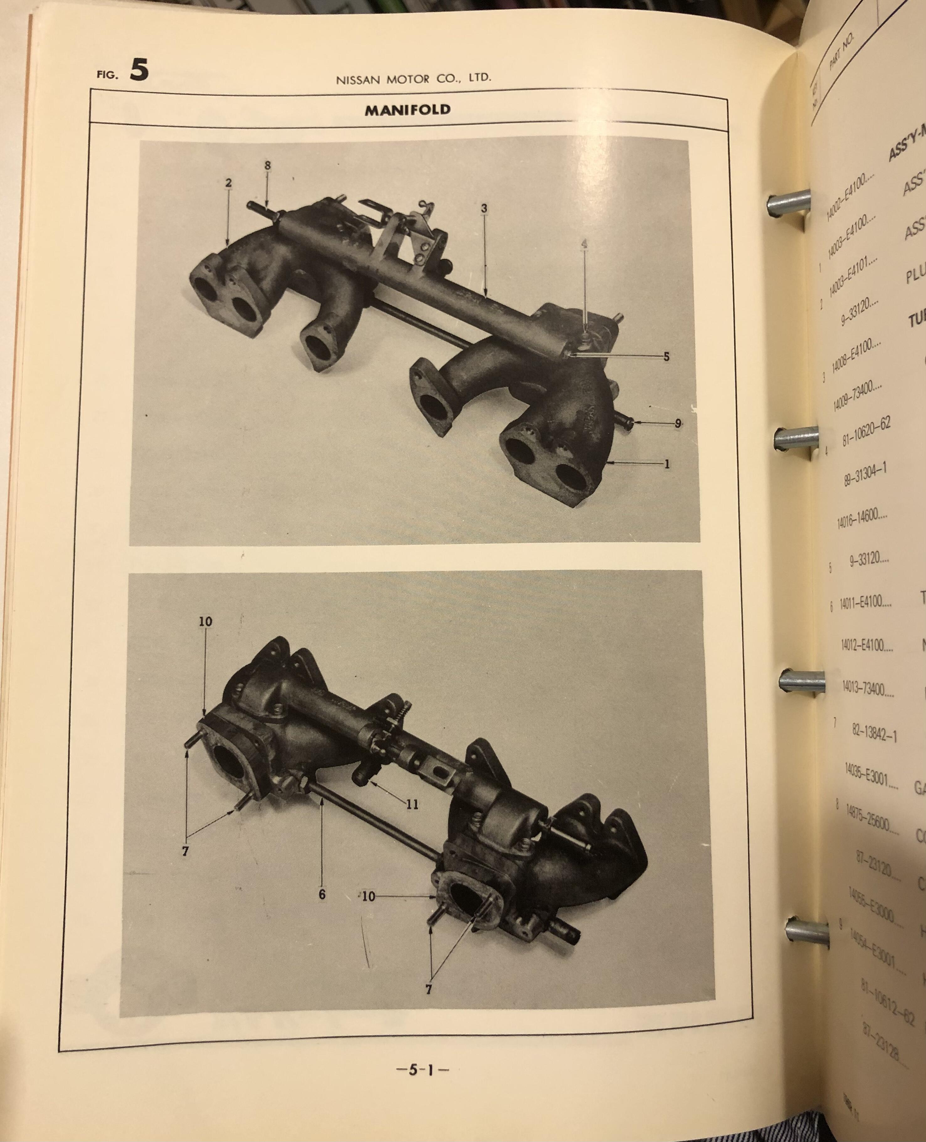

Transition to the non-US intake manifold,
I have a donor system which was pulled from a 1972  Fairlady Z (L20 engine model) . I was expecting I only need the balance tube but the water tube of between the two manifolds was so rusty. I decided to replace it with the one  from the donor.
 I snapped the rusty tube , I was lucky the donor is very good.
Today I have learned that when assembling the intake manifold, I have to wait final tightening the bolts on the balance tube until the two manifolds are secured . Also I tightened the two nuts for the water tube after the balance tube was secured .
As some of you are wondering about the two plugs on the balance tube which are not welcome for my 03/1970 car.
I am thinking about it to look just like an early L-series balance tube.
Kats

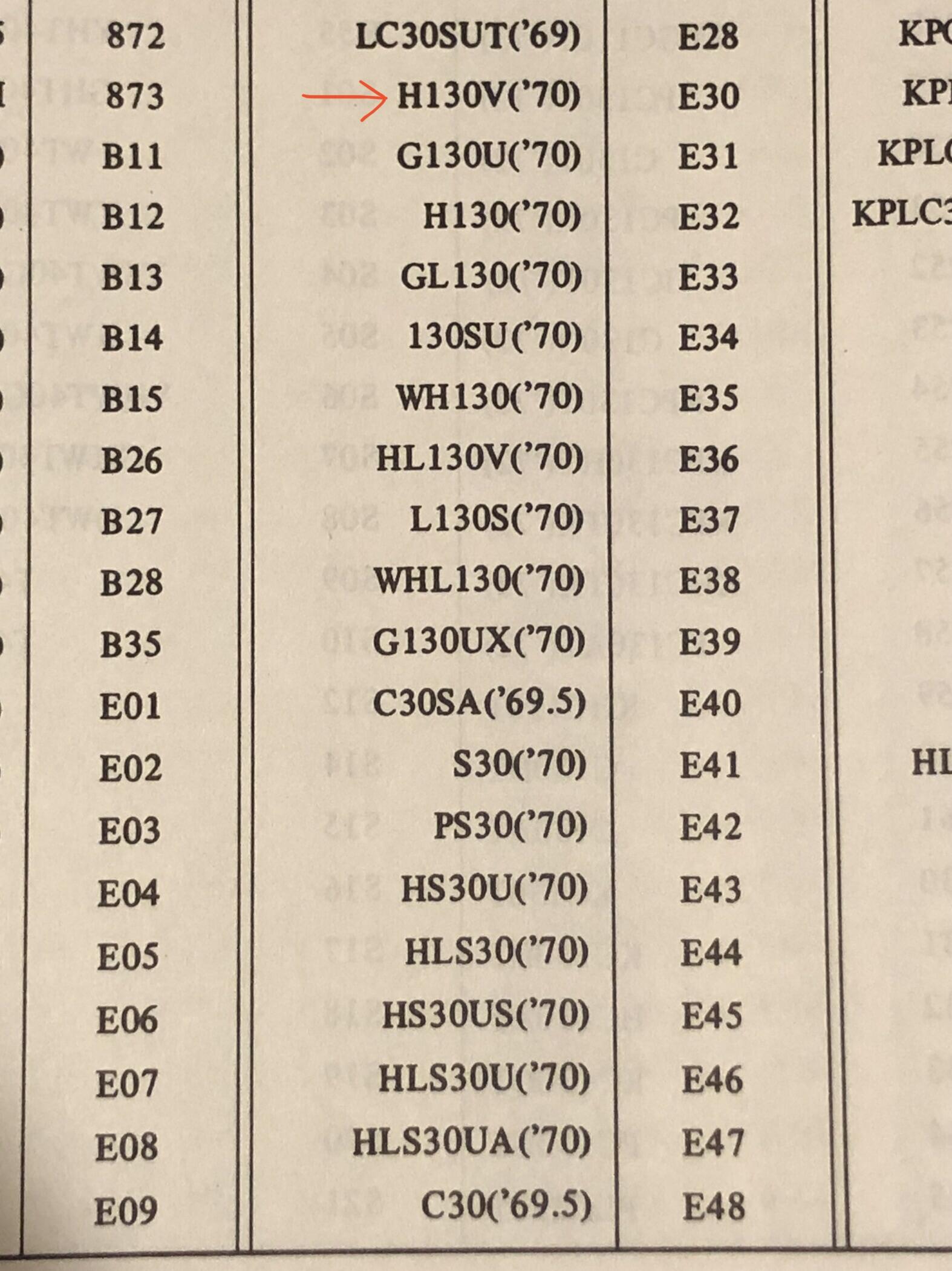

Hi Chris, I was thinking about “Her majesty “ , is she originally  non- emissions type intake & exhaust? I believe you told me that before but my memory cannot be clear. Or only without fuel vapor system?
By the way, I can’t find “ U98 “ models, I only found  E98 which might be related your U98 .My parts catalog says  E98 is a prefix for the parts of RS30 . I guess it’s exhaust manifold might have E98 on it .
My non- emissions type exhaust manifold has “JAPAN E30 “ on it between No.5 and 6 pipes, and also has “ 1 “ between No.1 and 2 pipes .
Also it doesn’t have any thread for bolts to retain the heat duct for the air cleaner.
I saw “ 2 “ version for the non-emissions type , which has two threads for the bolts which is retaining the heat duct for the air cleaner.
E30 exhaust was used for L20 and L24 without emissions devices.
Yes my E30 exhaust has provisions for the air - injection pipes , but only basement.
I see a Fairlady Z at the 1969 Tokyo motor show has the same exhaust manifold on it .
I need to grind the unnecessary humps on the balance tube, to be looked like an early non emissions type !
Kats
