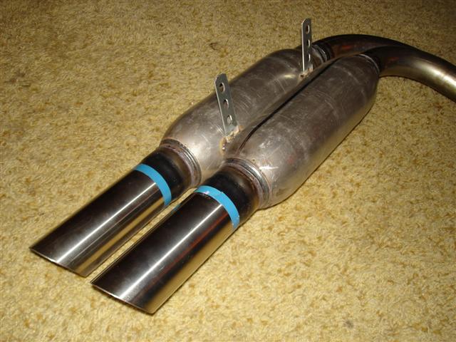

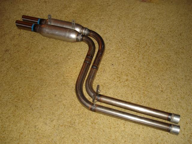

Phred Posted February 13, 2007 Share #26 Posted February 13, 2007 jmark, The finish in the pic is "as recieved" from Stahl. It's just paint. I am waiting till after I dyno my next eng. to refinish them with one of the high tech coatings. I really like the dual exh. sound, so I took the time to build a full dual system all the way to the outlets. You can easily buy or build a two into one merge collector for a single pipe system. When I first saw the race Z's in the early 70's, they had duals with megaphones straight out the center in back. So that's what influenced me. I used all mandrel bends and heli-arc'd the whole thing with a short crossover just ahead of the muffs. At the rear, I did a zig-zag around the fuel cell and built a resonator with two small race type muffs welded together. They have a 2.5 ID x 4" OD x 12" long, and I finished it off with a couple stainless tips. The only bummer with the side to side layout was I had to enlarge the cutout in the rear bodywork. I tried a stock type verical layout, but the lower muff was too close to the ground. Back in 98' when I bought this header, it was $512.00. I'll be interested to know what they go for now. Phred Link to comment Share on other sites More sharing options...

jmark Posted February 13, 2007 Author Share #28 Posted February 13, 2007 jmark,The finish in the pic is "as recieved" from Stahl. It's just paint. I am waiting till after I dyno my next eng. to refinish them with one of the high tech coatings. I really like the dual exh. sound, so I took the time to build a full dual system all the way to the outlets. You can easily buy or build a two into one merge collector for a single pipe system. When I first saw the race Z's in the early 70's, they had duals with megaphones straight out the center in back. So that's what influenced me. I used all mandrel bends and heli-arc'd the whole thing with a short crossover just ahead of the muffs. At the rear, I did a zig-zag around the fuel cell and built a resonator with two small race type muffs welded together. They have a 2.5 ID x 4" OD x 12" long, and I finished it off with a couple stainless tips. The only bummer with the side to side layout was I had to enlarge the cutout in the rear bodywork. I tried a stock type verical layout, but the lower muff was too close to the ground. Back in 98' when I bought this header, it was $512.00. I'll be interested to know what they go for now.PhredPaint seems to have held up well. I think it is rated to 1800 F. I am not sure the ceramic coating is rated that high! Link to comment Share on other sites More sharing options...
