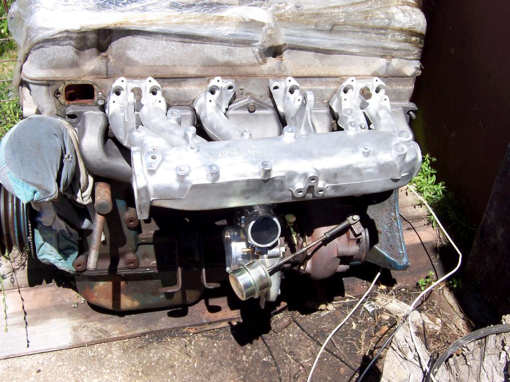

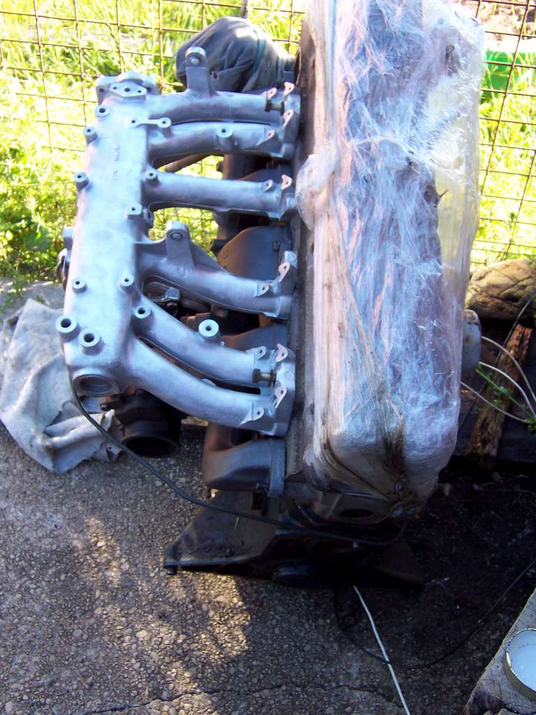

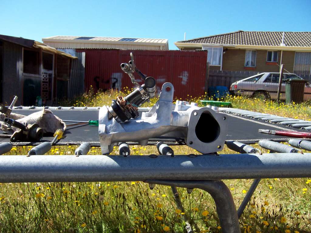

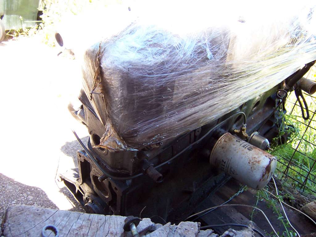

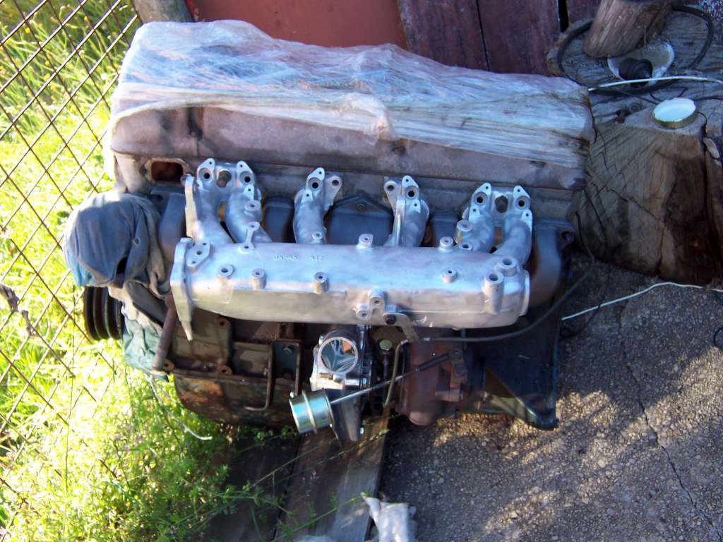

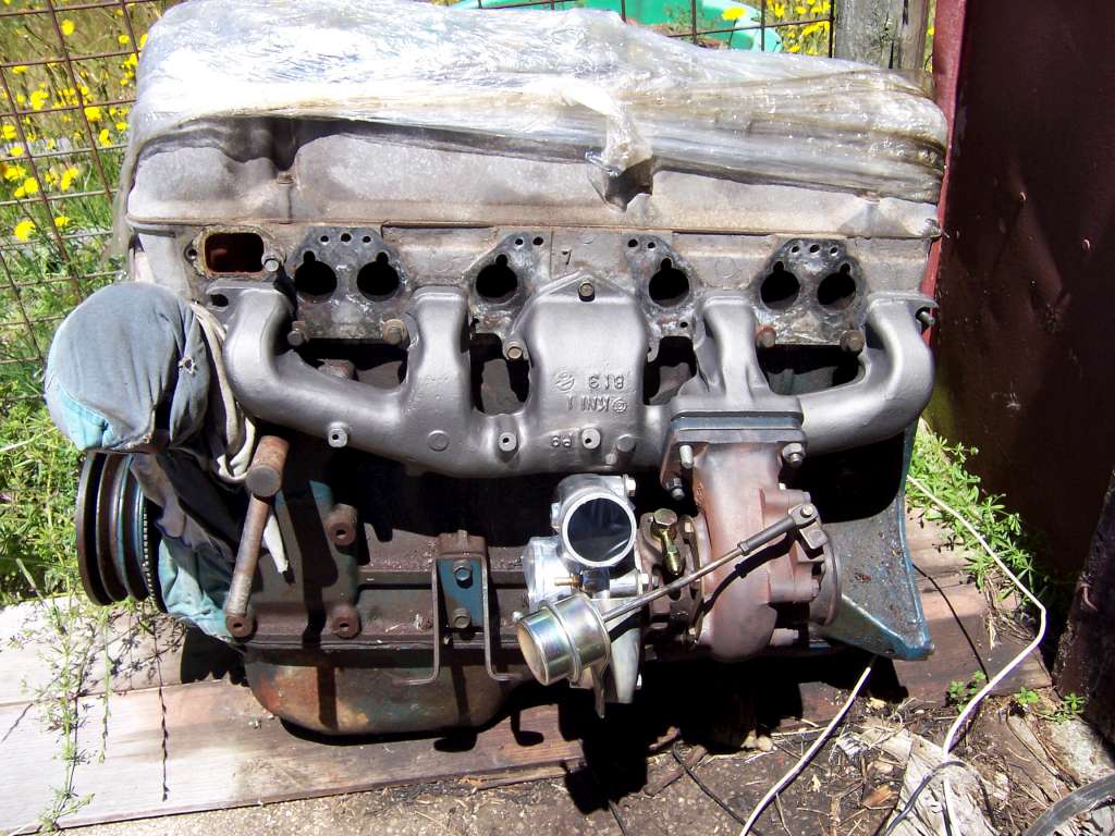

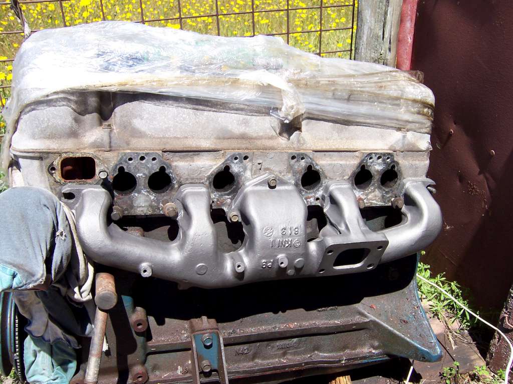

I had my manifold machined across the gasket area, it was pretty rusty and I didn't want the hassle of a leaking manifold.

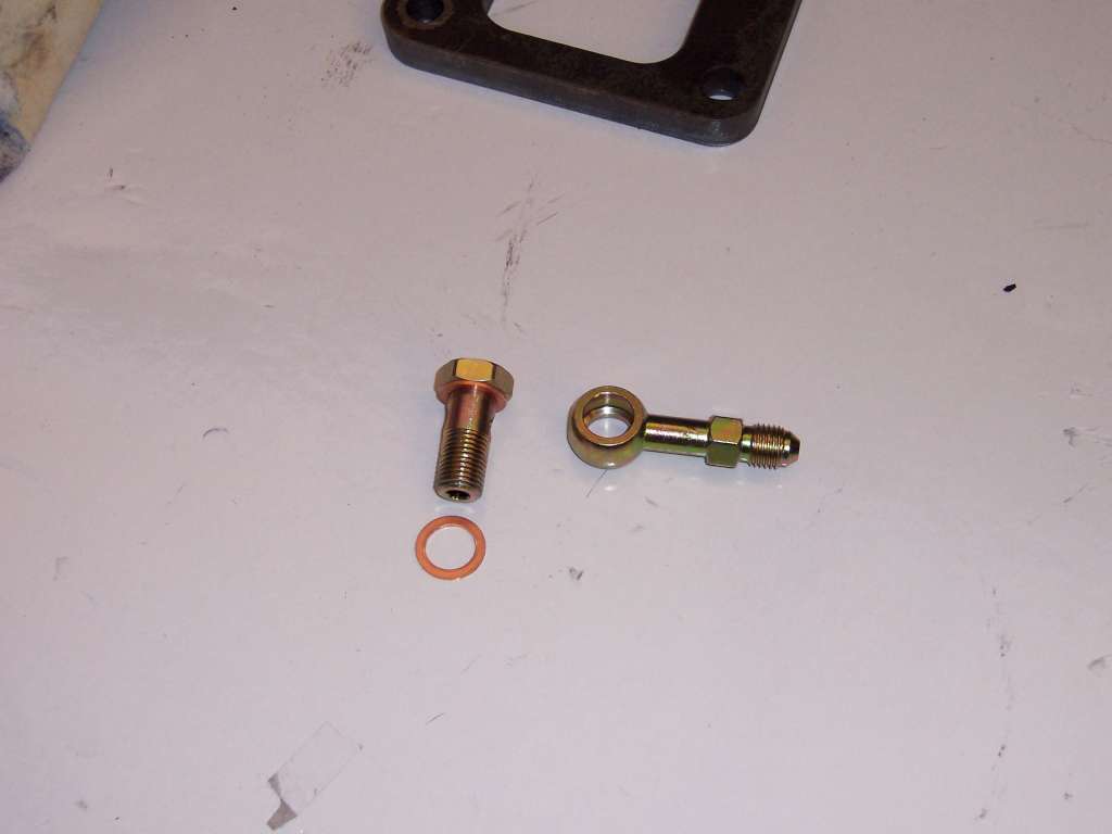

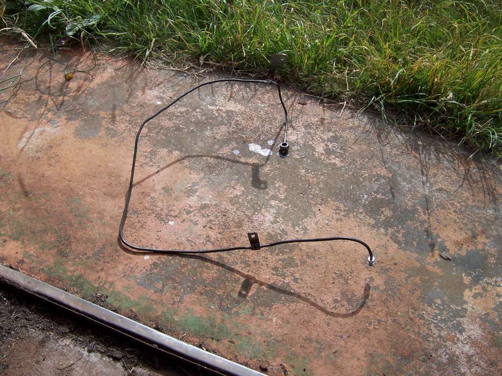

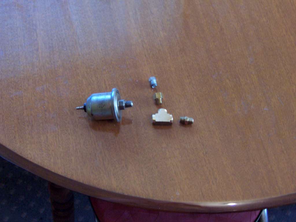

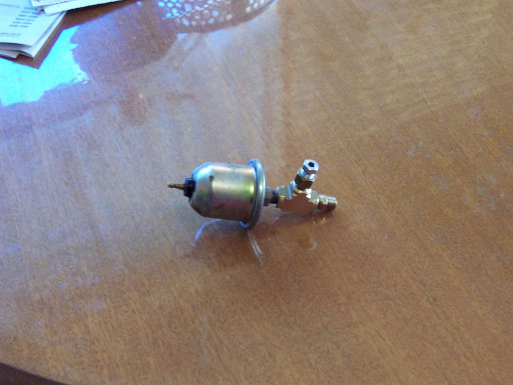

I also made the oil line today for the inlet for the turbo,I made it out of brake line, also got a Tee made up.
Edited by Noddle
added picture of finished oil line

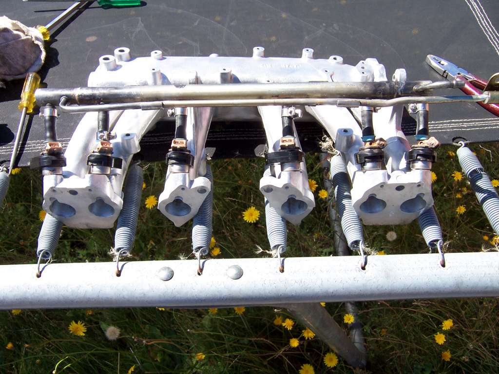

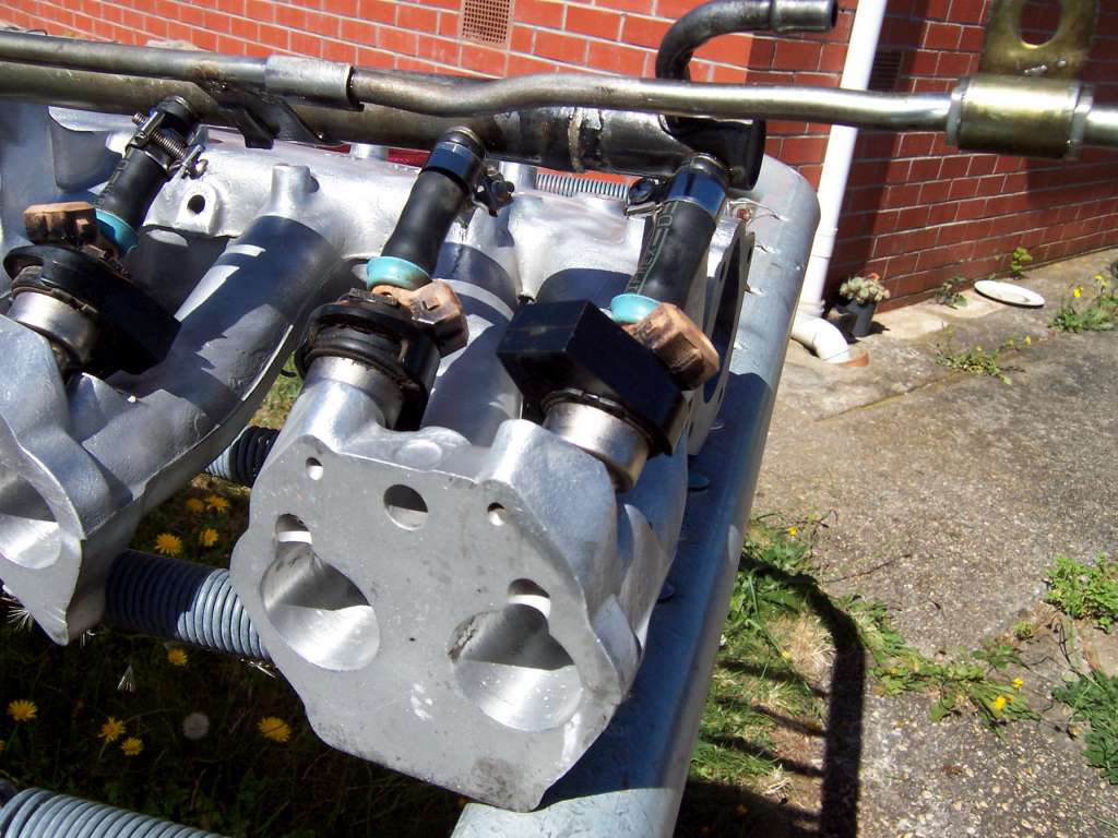

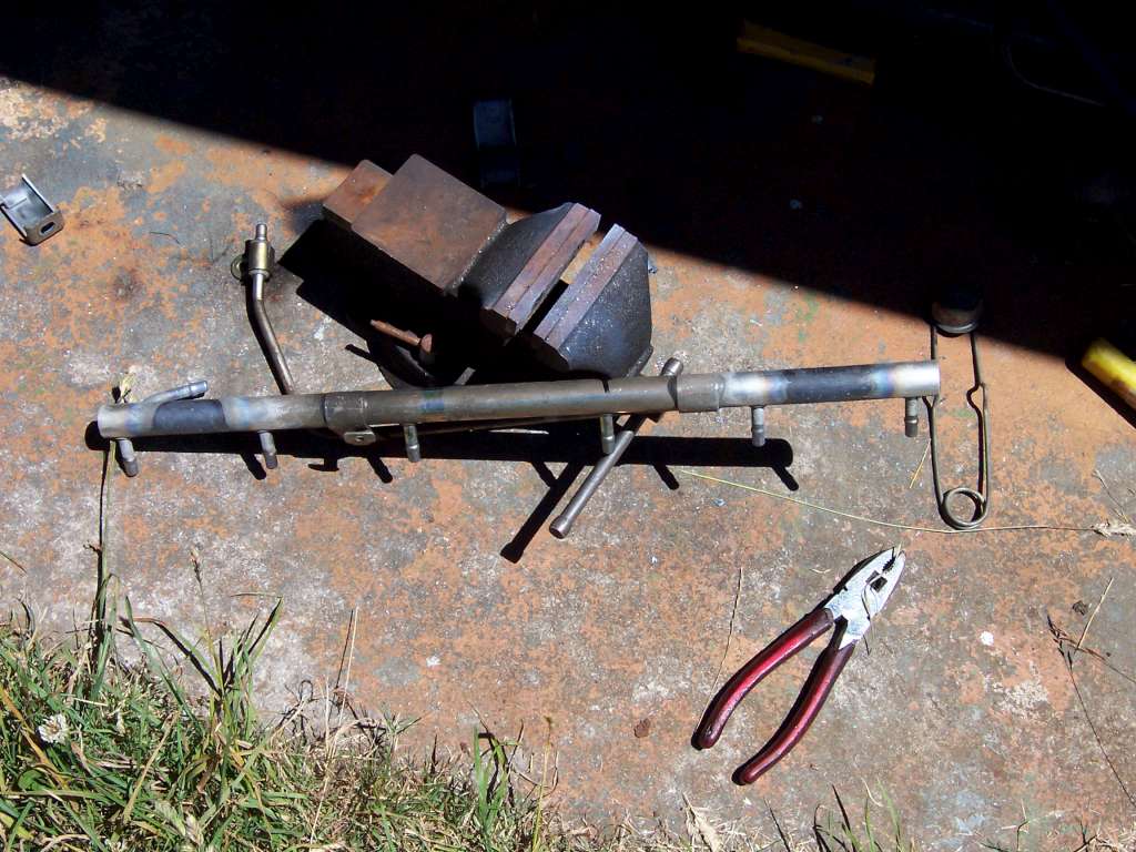

Hi all,

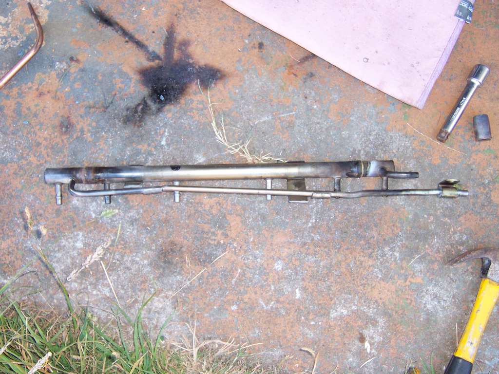

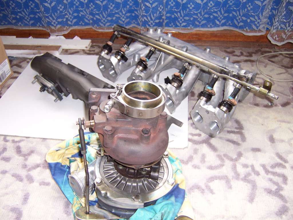

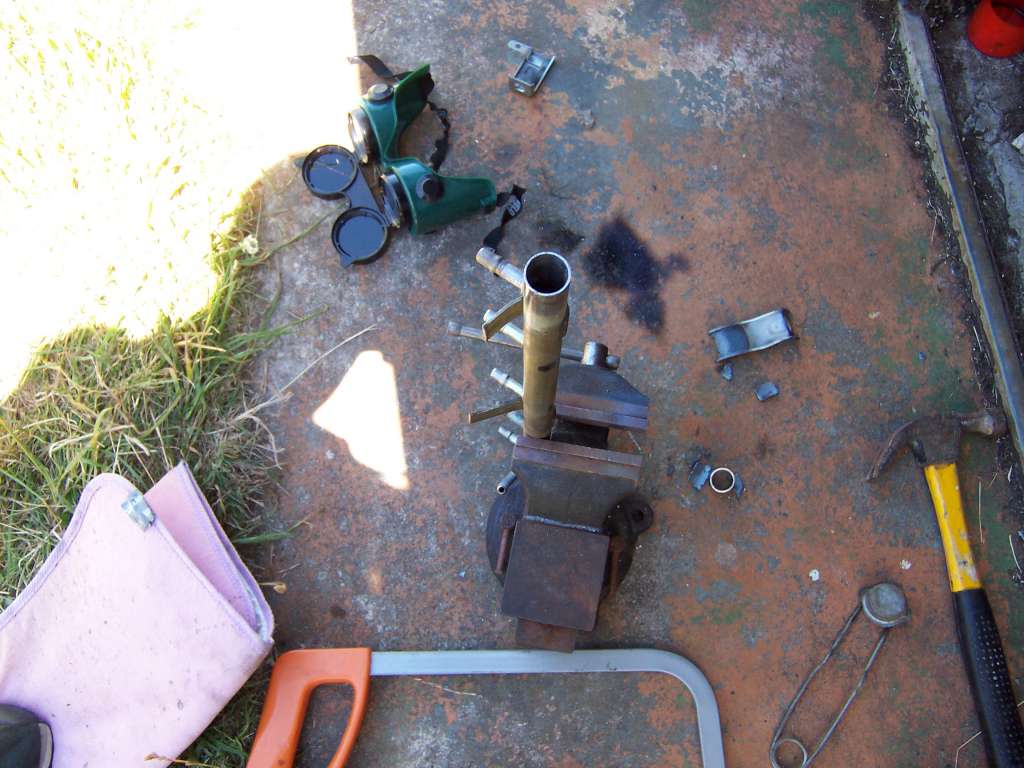

Yesterday I was checking out my ebay purchase of a RB30 injector rail and injectors (I was after the injectors for my turbo installation), and I noticed that all but the end 2 injectors lined up, so I though this may be useful as a fuel rail for my L24, so after some bracket removing, shorting, and some silver soldering, this is what was left.
I'm after some injector clamps to suit my manifold, so if anyone got some for sale PM me.

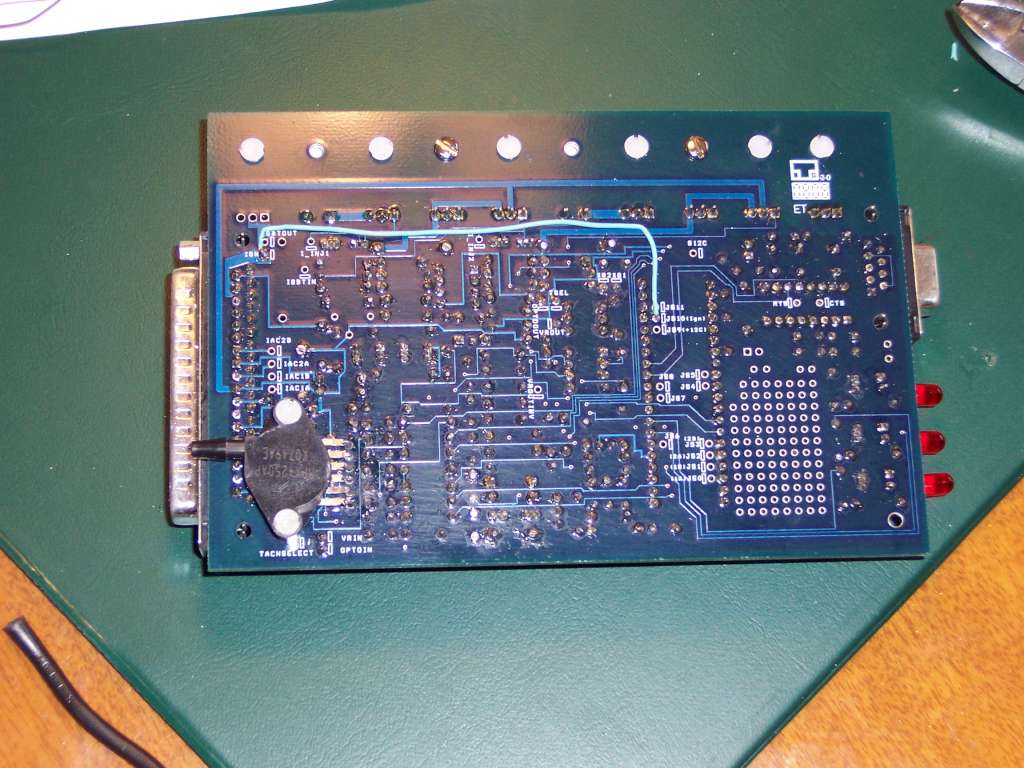

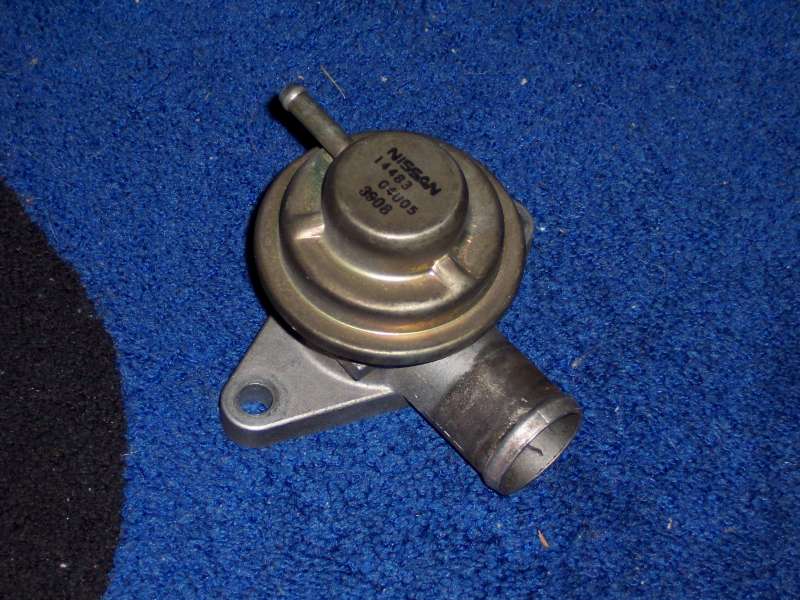

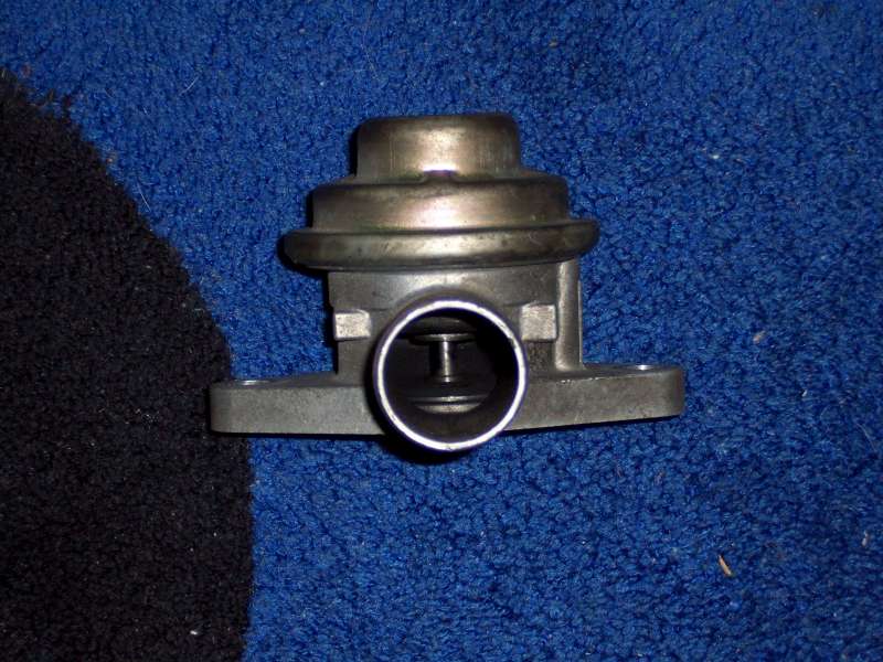

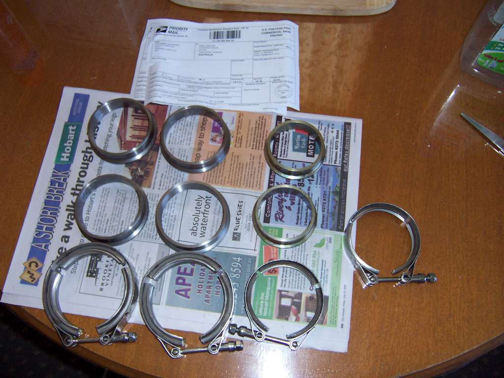

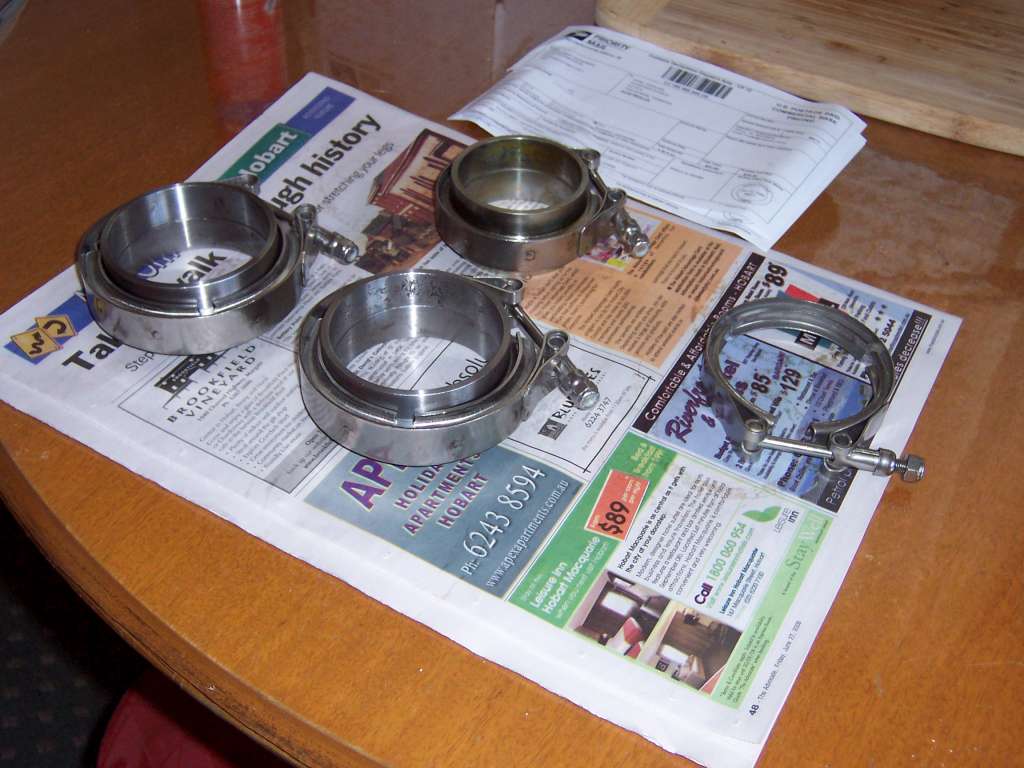

Picked this up last night,
The guy I got it from has a workshop, and he works on later model skylines, so I assumed he would install new aftermarket parts, and I was correct, got this for $20.
It's nice to deal with some one face to face, I brought a BOV over on www.skylinesaustralia.com, but the guy stiffed me. it was only $30, but that's $30 I could have spent on something else.
Nigel

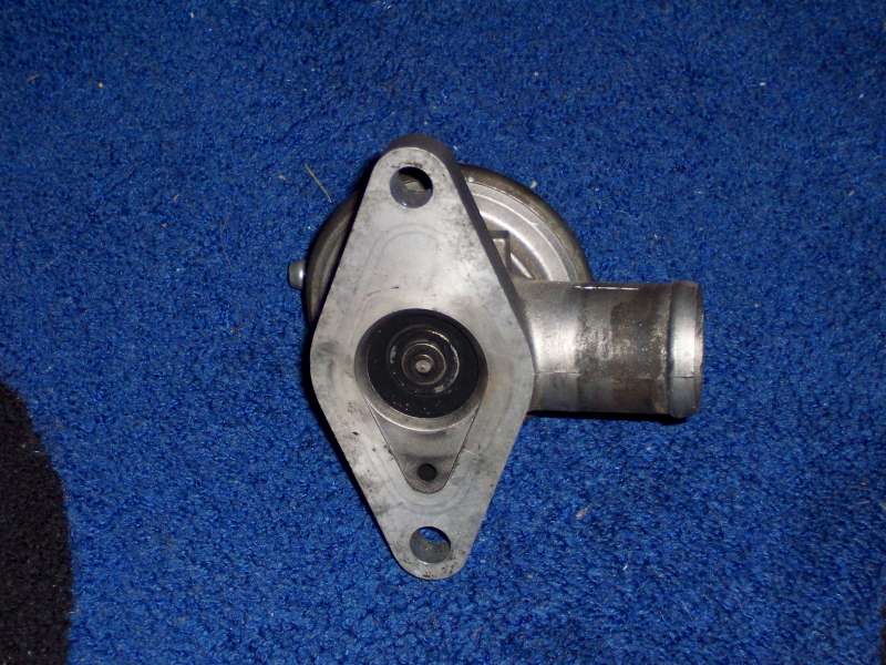

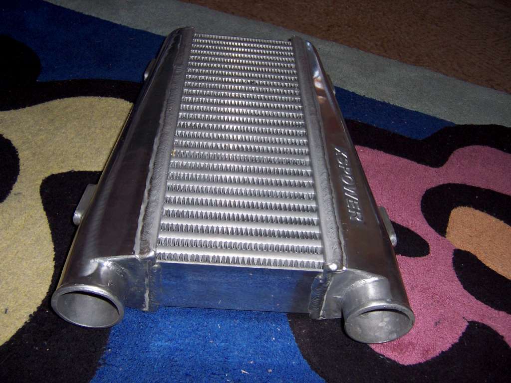

Still adding to my collection,

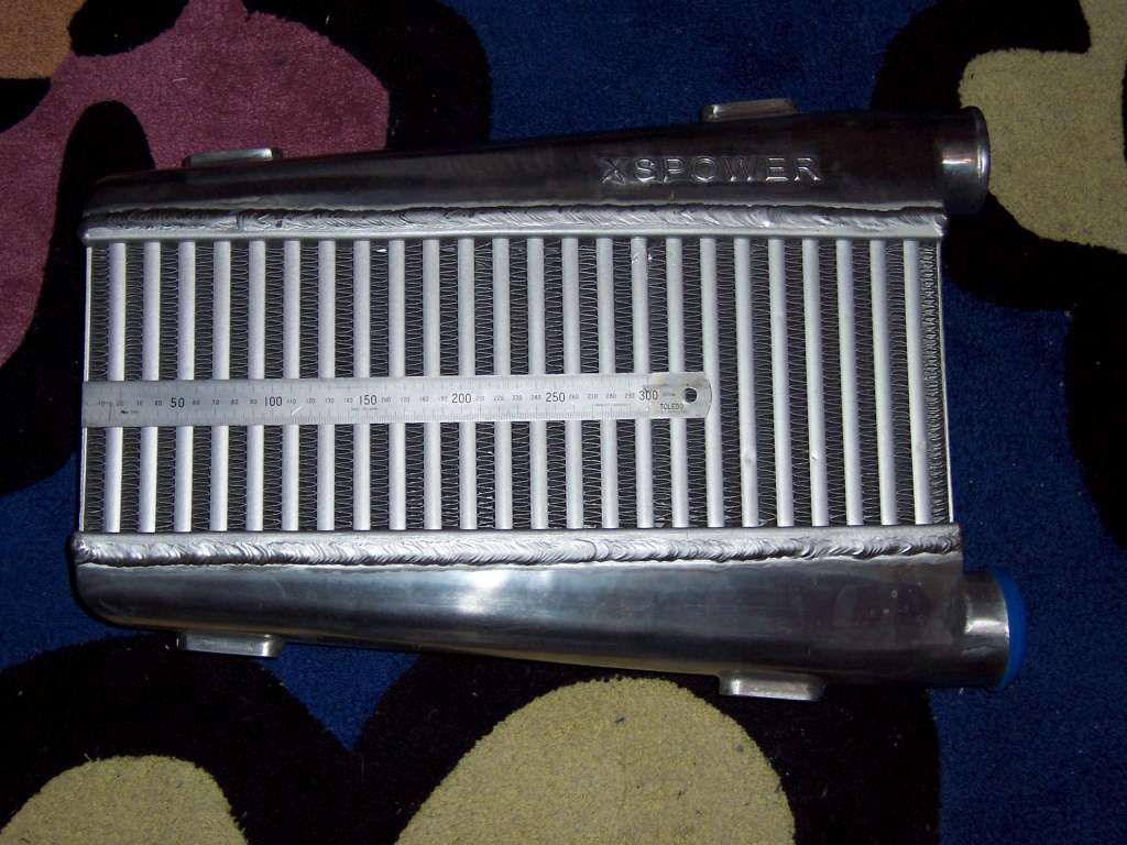

Got this on ebay last week, exactly what I was after, inlet and out let on the same side, plus the core design, from my research is better than the longer tube type for the same core size.
Nigel

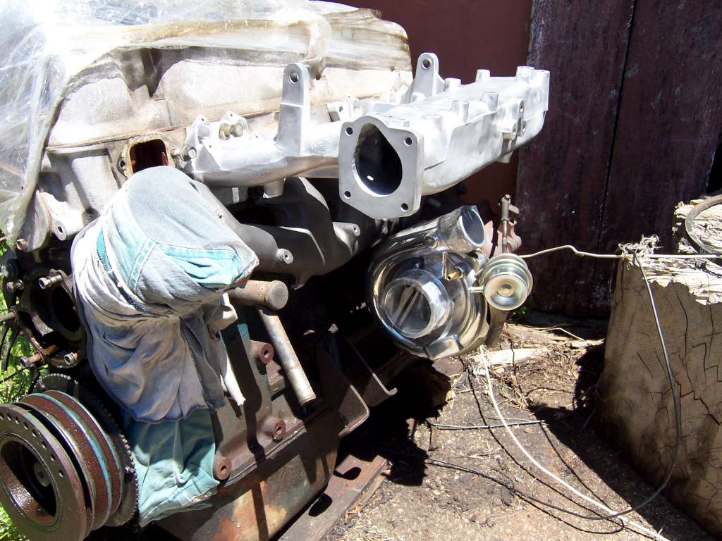

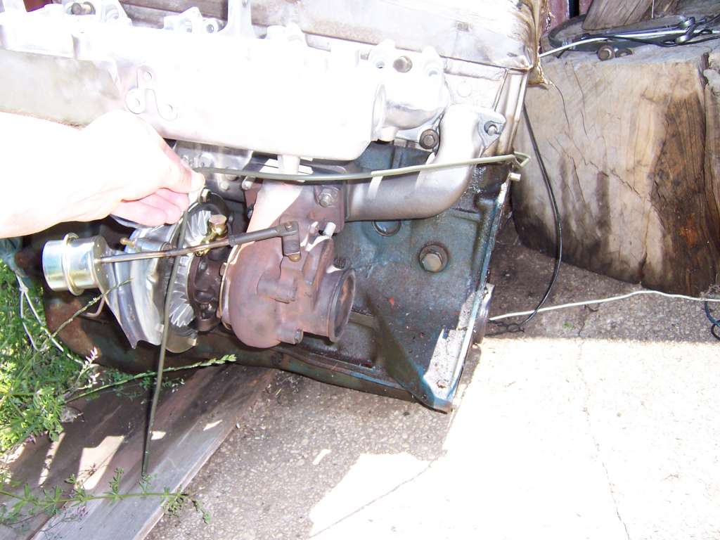

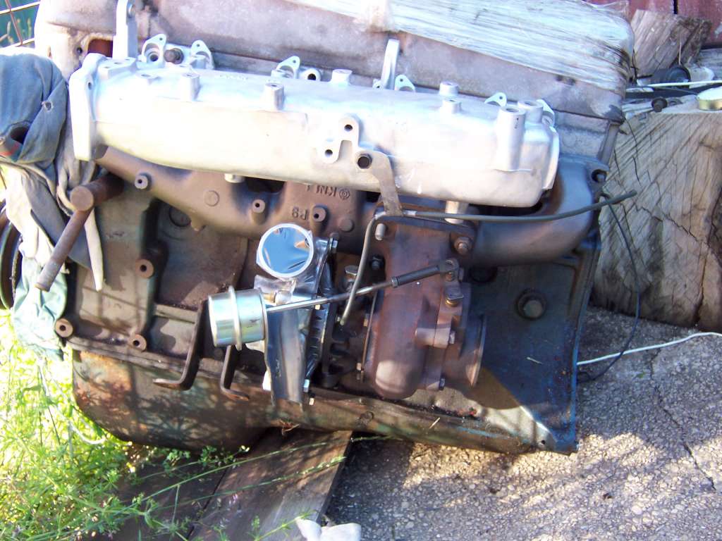

Hi all,
Still chasing bits for my turbo upgrade,

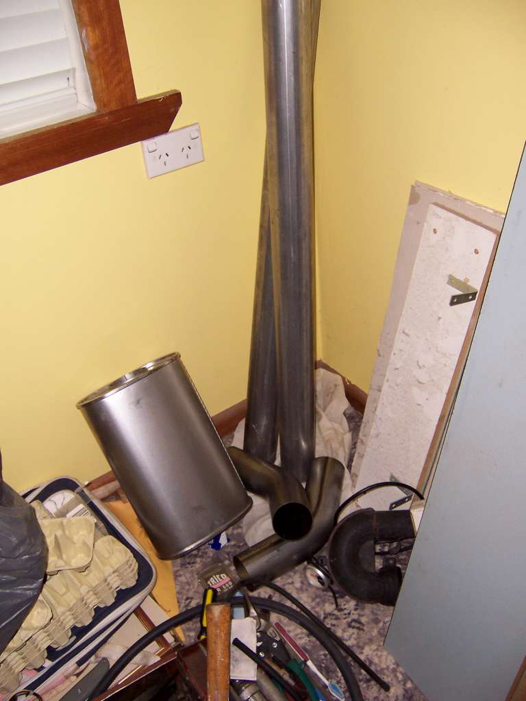

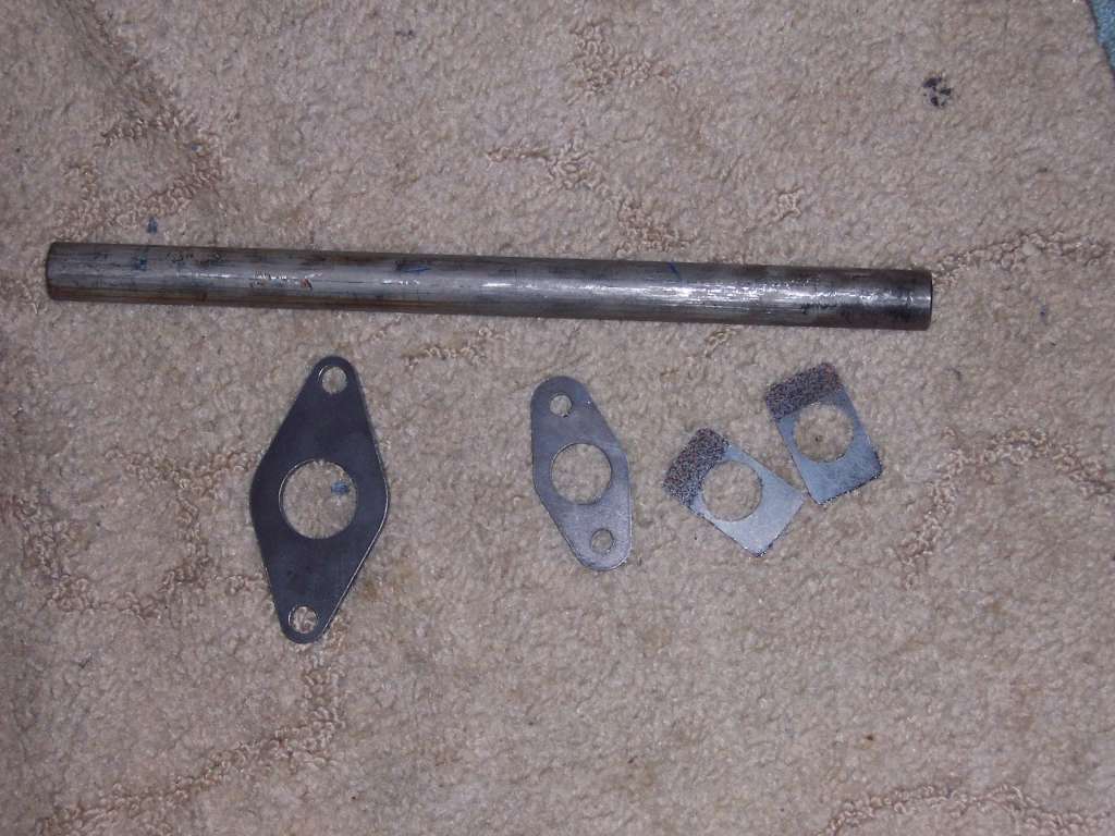

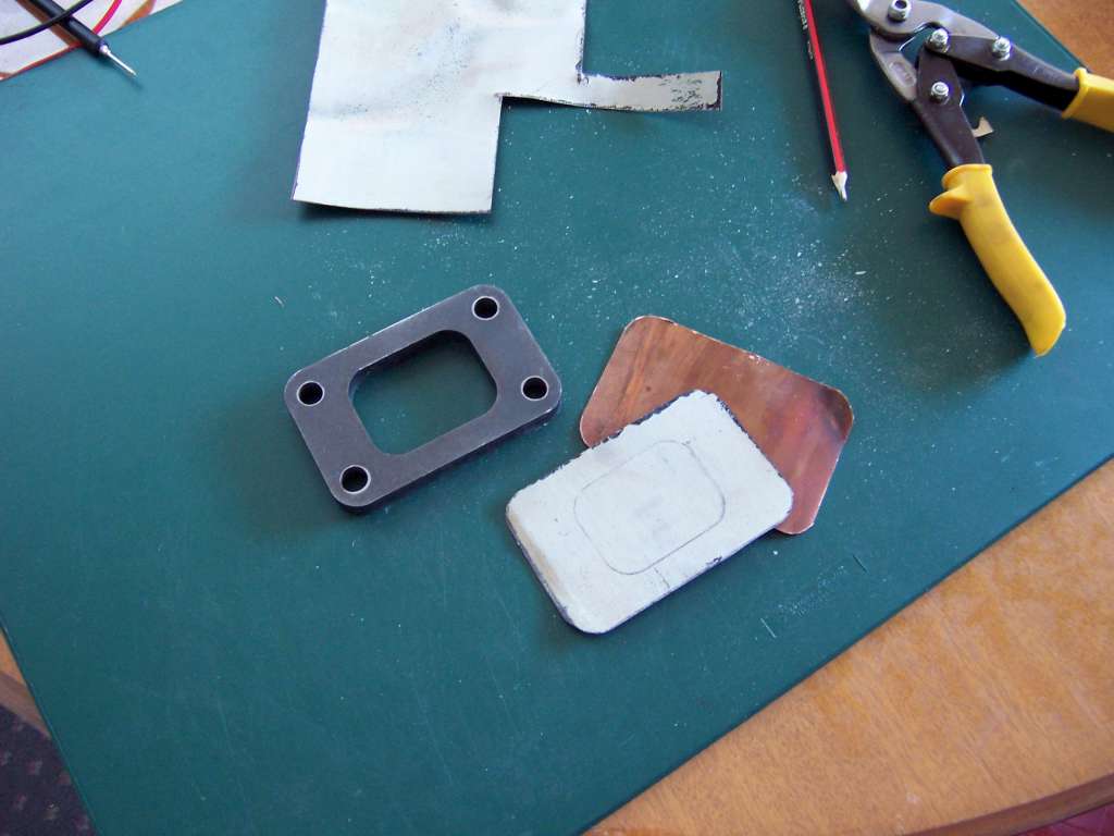

I had some stuff laser cut, BOV flange, oil return flange, this will bolt to the bottom of the turbo, and two other pieces that I will weld (bronze) to the sump to strengthen it where the return will fit, all for $10.

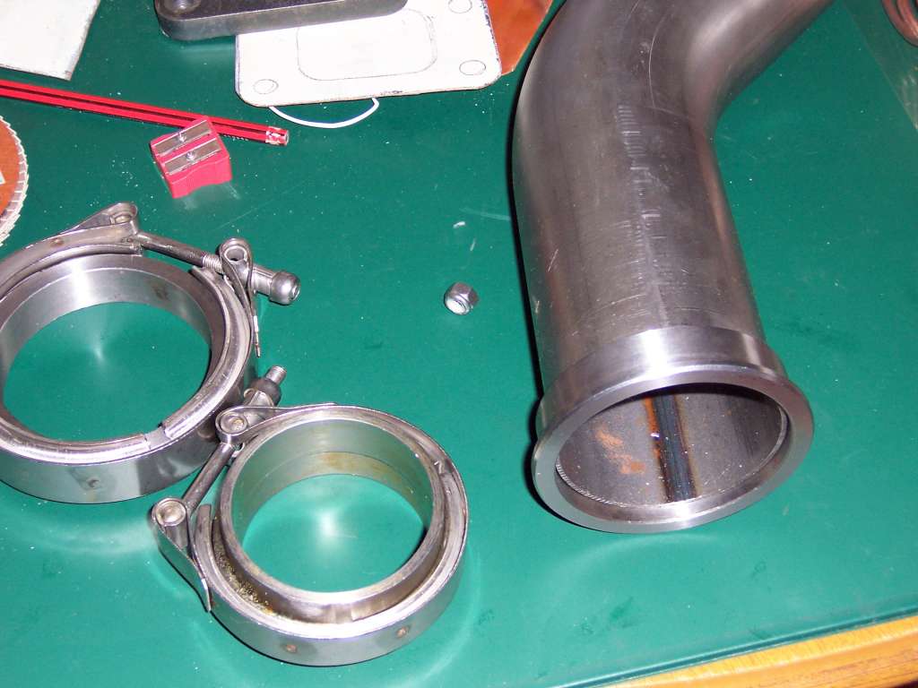

also I got 3 meters of 3 inch mild steel exhaust tube, 2x45 degree bends (mandrel), and a muffler, I'm hoping to use 2 x 45 degree bends for the down pipe, if there is enough room, otherwise I will have to get some 90 degree bends.
I'm plaining on using 2 copper gaskets for the turbo spacer I need, so the turbo doesn't touch the exhaust manifold, this should work, the only concern I have is to make sure none of the copper is directly exposed to the exhaust stream. I don't want molten bits of copper going through the turbo.
As you can see in the picture the weld on exhaust flange fits very nicely.
so hopefully over the next week or two I will be finished, well, finish the turbo install, then I'll probably move the whole lot over to my other 240K.
