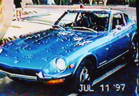

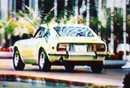

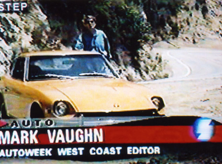

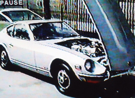

Here are some pictures from home movies.

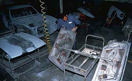

…talk about how the Vintage Z cars were prepared. How were they restored? What techniques were used? What finishes? What do we see when we view these cars which may differ from the way they left the factory in 1970, ’71 and ’72? Nissan makes strong statements about how these cars were “improved”, “upgraded”. Nissan was selling brand new cars with 12 month / 12,000 mile warranties. There were Federal laws and liability issues to contend with. Requirements for vehicle emissions and passenger safety had changed. Although they were previously owned, previously registered, they were sold representing new cars. This is where the concept of equating brand new to refurbished and restored plays into marketing the cars. They had to be portrayed as brand new eliminating the question of worn out or how they were simply “repaired”. They had to be portrayed as restored to avoid the different legislation. To this extend, “restoration” took on a meaning of part replacement. “New restoration”. “Restored new”. This article deals with the official Nissan description of how the cars were prepared.
Pierre Perrot estimated Nissan was able to provide between 75% and 80% of the parts replaced in an interview he gave at the Vintage Z Rally, May 3, 1996. At the time, approximately five cars had been completed. Later in the Z Restoration Program, trends and techniques become more evident. In order to replace all the parts, the car had to be completely taken apart. Certainly the old body shell had to be cleaned and repaired. Everything had to come off for the shell to be thoroughly treated. There is indication that they were primarily bead blasted.

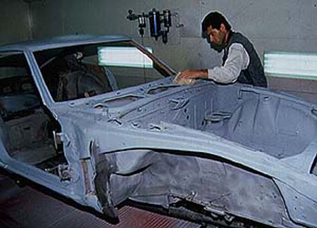

“Now that all the car’s components have been removed, the 240Zs body is taken apart as well. The hood, fenders, doors and liftgate are removed, and all panels are carefully stripped down to bare metal. Rotating platforms allow the technicians to check every nook and cranny of the panels. Craftsmen then go to work on the sheet metal until every inch of it meets their high standards, free of ripples, blemishes or dents”.
To the best of my knowledge, all the Pierre prepared cars were undercoated. This may have been common to all the cars as a Nissan specification.

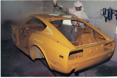

“Next, the body and panels are painted an original factory color. This time, however, the paint process gives the chassis a far more lustrous and durable finish than was possible all those years ago. Just one example of how the Z Restoration Program uses today’s advanced technology to compliment the classic features of the Z”.
In a later publication, Nissan comments on paint colors. Evidently, we find that the buyer had some input
“…and we feel it is important to be able to provide specific paint choices and model years, as desired by our buyers.”

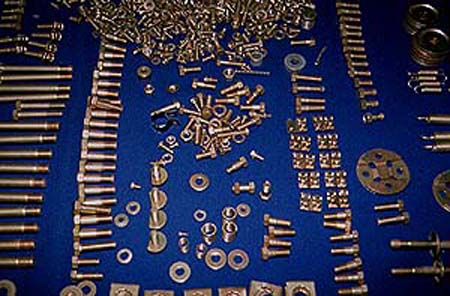

A tremendous amount of hardware was replaced.
“”When available, genuine Nissan parts are used…Many ancillary components including the alternator, starter motor and fuel pump are replaced with new units or ones that have been remanufactured to our stringent standards”.

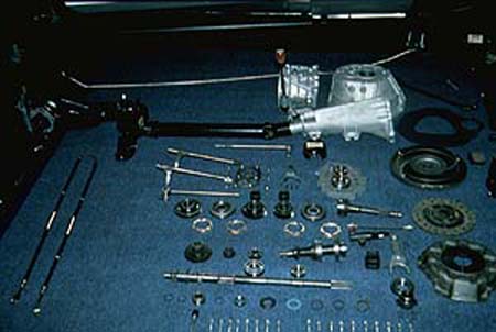

The engines, transmissions, braking and steering systems were completely overhauled and “some things are automatically replaced”.
“As always, if there is any doubt about whether a part should be replaced, we simply replace it”.
