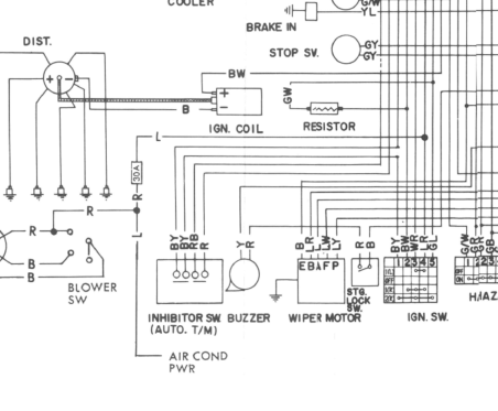

Stop replacing parts.  There are two circuits to the ballast resistor and coil.  One for Start and one for Run.  Sounds like your wire for the Start circuit is either not connected or connected incorrectly.
Here's the diagram showing the ignition switch wires. Green with a blue stripe would be the Start wire. - 1971_240z.gif

I see what you mean. No offense taken. On the ballast resistor, in the start circuit on the headlight side or the firewall side? I'll run through the service manual again in the meantime.
I think that the diagram is a little misleading.  I don't have a 71 but on my 76 the wires are connected at the ends of the ballast resistor itself.  One at the end that passes through the resistor and the other one directly to the end that then goes to the coil.  So, in the vicinity of the coil and ballast you should see the green/blue and the green/white wires.  Your green/blue might not be connected, it's the Start power.

Well, I have a new one on the way from ZcarDepot. But I just checked the wiring setup to the ballast resistor and GW wire wasn't connected to the resistor at all, it was connected to the ground side of the coil. Going to strap it to the Start power side of things. Will post results.
