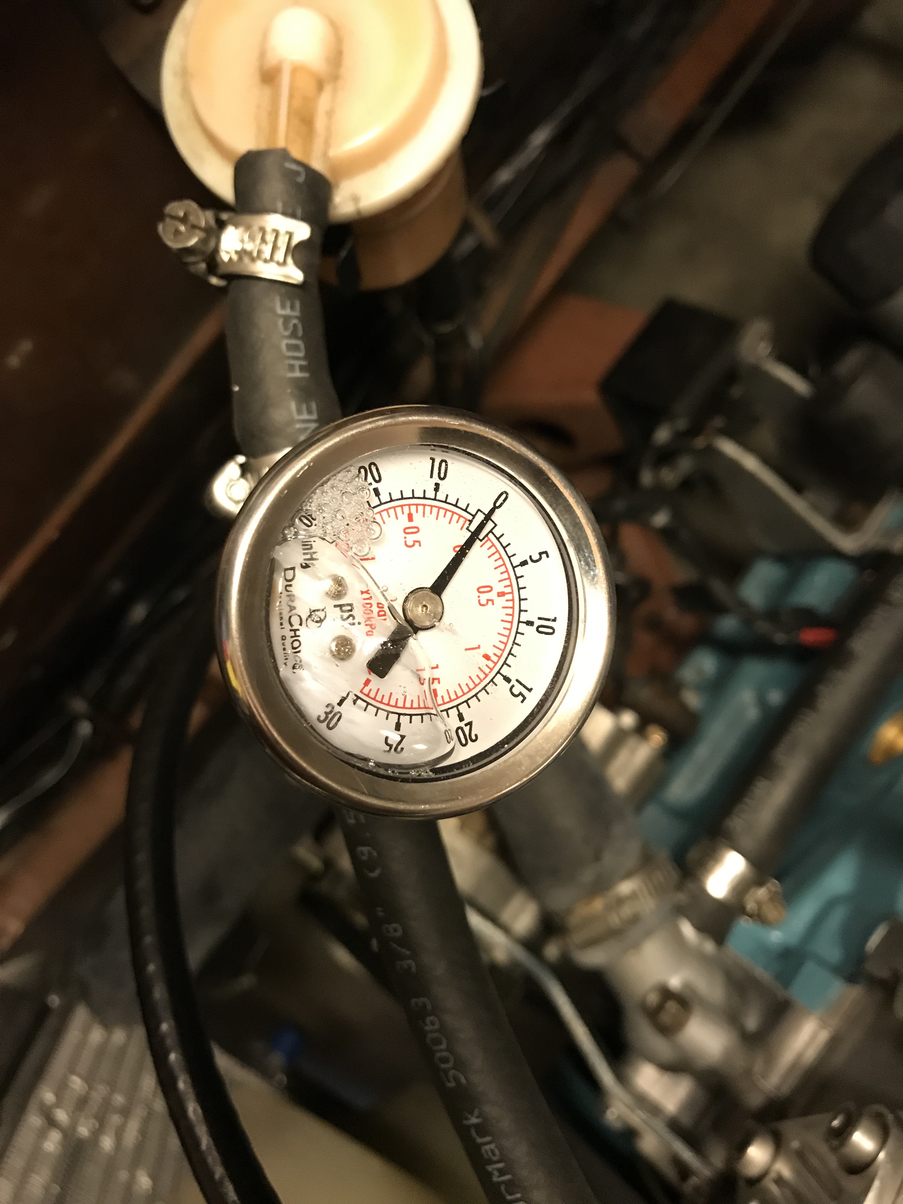

Several other items to check on your quest for idling without RPM dropping...
How is your fuel pressure?  Have you actually checked it with the engine running once its warmed up?  I plumbed in a cheapo gauge and am getting A steady 2.0 GPH out of my electric pump, which is right where it should be for carburetors.  Could your pump be pushing more fuel then your needle valves can support within the float bowls & making the carbs run ultra rich at idle?  At cruising speed, it wouldn't be noticeable as the fuel is getting burnt at higher RPMs.

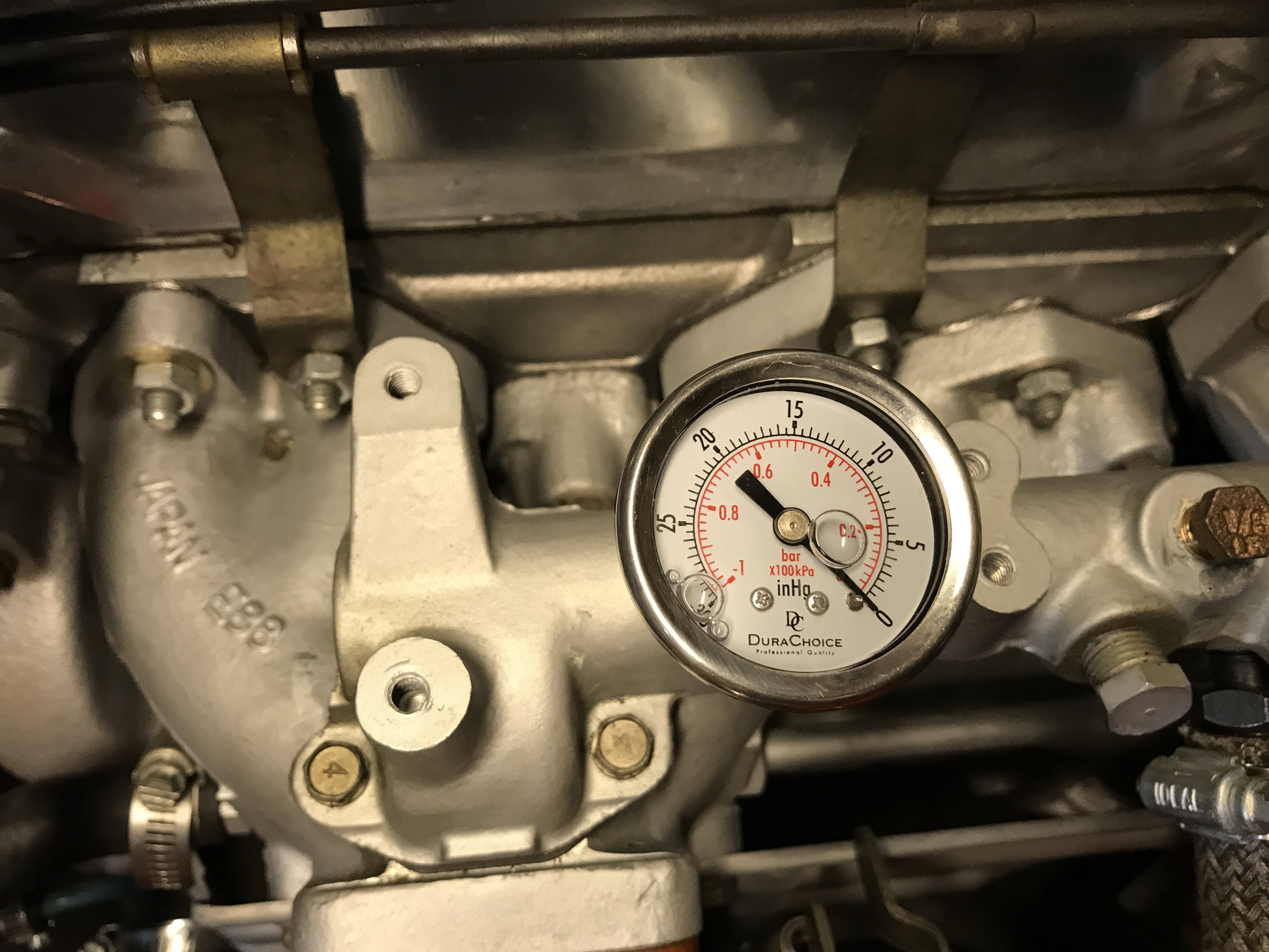

How is your engine vacuum?  Again, plumbed in a cheapo gauge into my balance tube & am able to confirm the health of the engine very quickly at idle and higher RPM.
Reference https://smile.amazon.com/gp/product/B00GM5FPXO/ref=oh_aui_detailpage_o03_s00?ie=UTF8&psc=1
No vacuum leak, but rather a health check for the engine.   You can very easily tell if you have a leaking valve, carb's out of sync, broken ring, bad timing, blown headgasket, etc.  Please see below:
