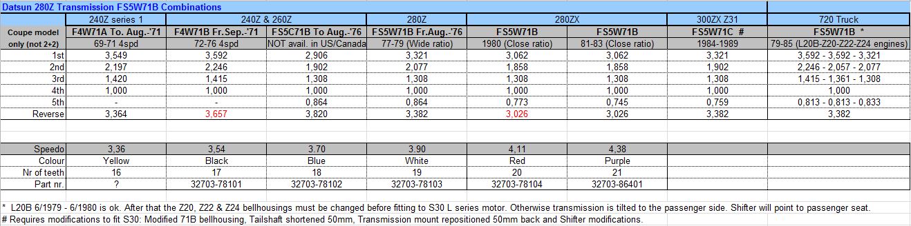

If you want a close ratio than any NA Coupe after August 79 will be fine. I find it hard to believe you will notice the difference between the 5th in the 1980 model compared to the 1981 - 83 model.
For info: If you do go with a 2+2 it will be the same as the 280Z wide ratio 5 speed. First will be very low with a 3.7 or 3.9 diff. The 240mm clutch will work fine in a 240Z, but it is heavier. You should use a lightened flywheel if you use it. The 240mm has a lot more grip, but keeps a soft clutch pedal like the original clutch. I use one with a lightened flywheel and I like it.
I made this table a while back to help me finding a suitable transmission. It might be some help to you looking for a transmission.FS5W71B transmissions.JPG
