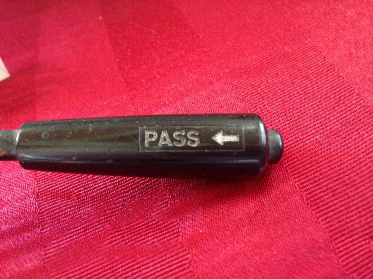

I just picked up a couple of these in Japan. They look identical to the LHD switch. If someone wanted to add this pass feature, it looks like you could just flip it over and put it on the left side of the steering column. The "pass" lettering would be upside down but that could be blacked out so it
wouldn't be noticable. Around here we flash our high beams to warn others that the cops are using radar and I flash high beams to tell others to turn down their high beams.

Thanks for that I'll look into getting one, it's a good feature to have

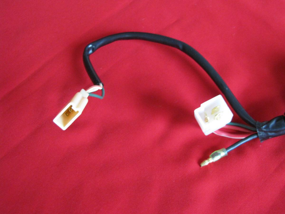

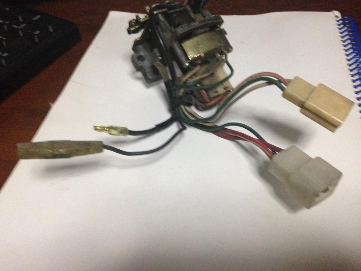

The 2 RHD turn signal switches I have are for years 74-76. I've compared the wiring harnesses to the USDM for the same year car and the plugs are identical. The only difference is there is one additional wire that comes out of the turn signal stalk and ends in a single female spade connector.
I'm thinking the RHD 1972 Japan fairladys are the same deal with 1 extra wire too.

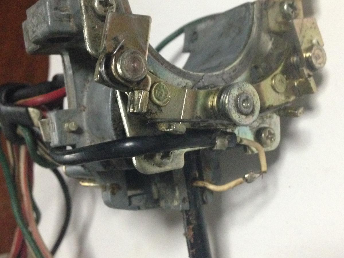

After taking a picture and posting the picture of that tiny wire I got to thinking that they're sending all the current for the high beams
through that tiny wire because there are no high beam relays. Damn they must be weak but I guess they serve the purpose and
it's only for a few seconds
