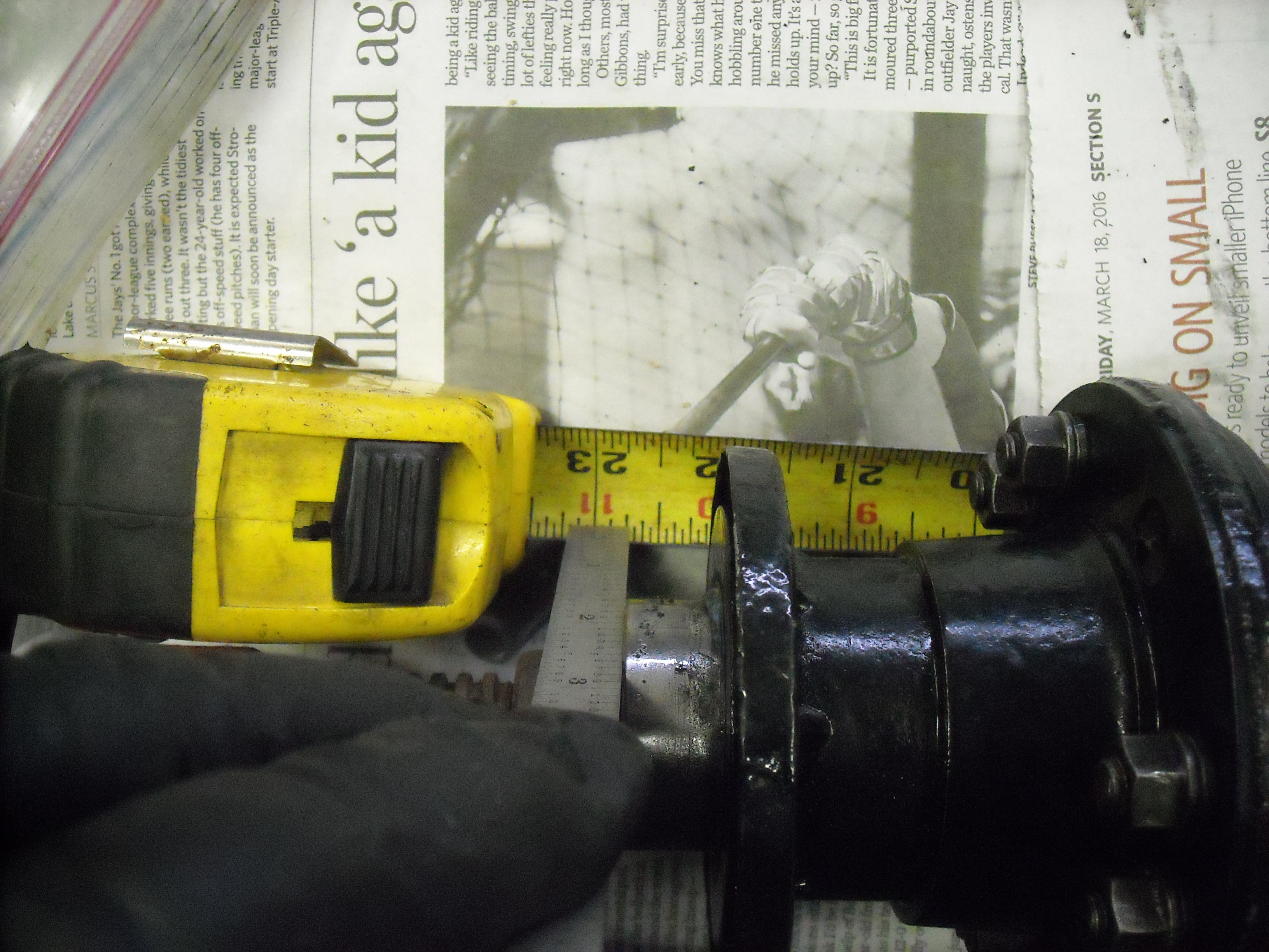

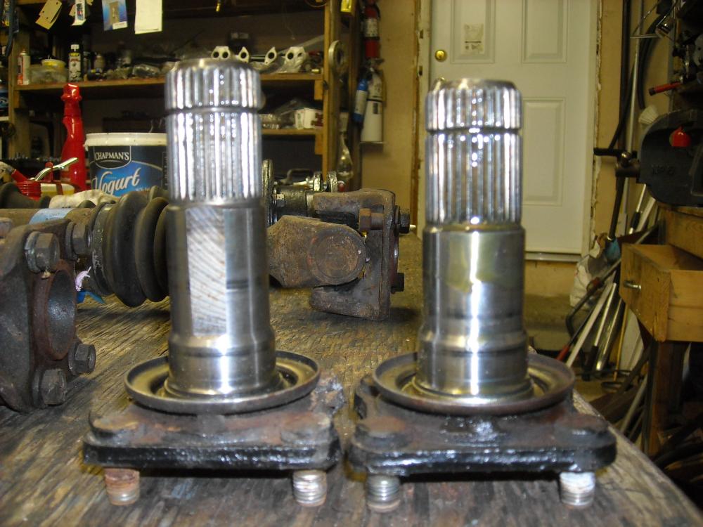

Hmmm, I know part of the difference is that I am measuring from the tip of stub axle to the bottom of the companion flange as pictured in the 1st pic of the latest post(wish I could just refer to the post #) The stub axles from the R200 diff and the 280zxt are
3/8" taller on the passenger side then the driver side. That's part of it, I just did the same measurements again and got slightly different numbers so perhaps after I do the rebuild on these shafts things will change again. Maybe there is some old grease hanging them up.
There definitely is no difference in height between the the 240z halfshafts but the 280zxt halfshafts have the stub axles built in and that is why I'm using D/S and P/S.

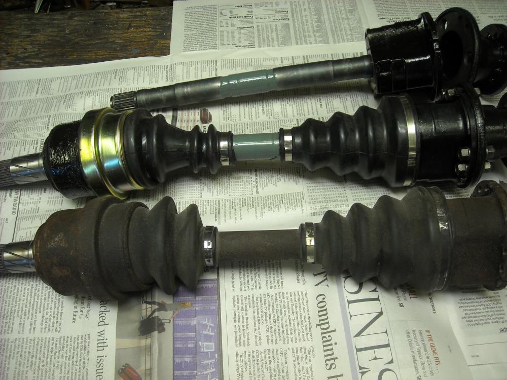

So the new D/S halfshaft arrived, it is slightly different then mine, the ends of the boots are secured farther apart,  but I'm only going to use the stub axle end of it.
The un restored shaft is from a 1981 280zxt, the other two are from a 1983 280zxt.
The boots seem to be the only difference.

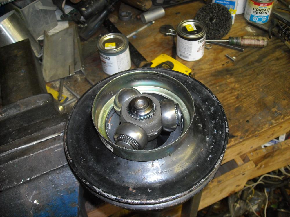

Even with my boneheaded move of throwing good parts in the garbage(a $200 mistake) I have saved about half what it would have cost me to buy the Wolfcreek shafts...so far. I'm not foreseeing any further costs but who knows. It has been time consuming hunting down the articles that describe this swap, finding the parts and doing the rebuild. Never seeing the inside of a CV joint didn't help.

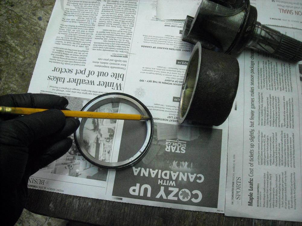

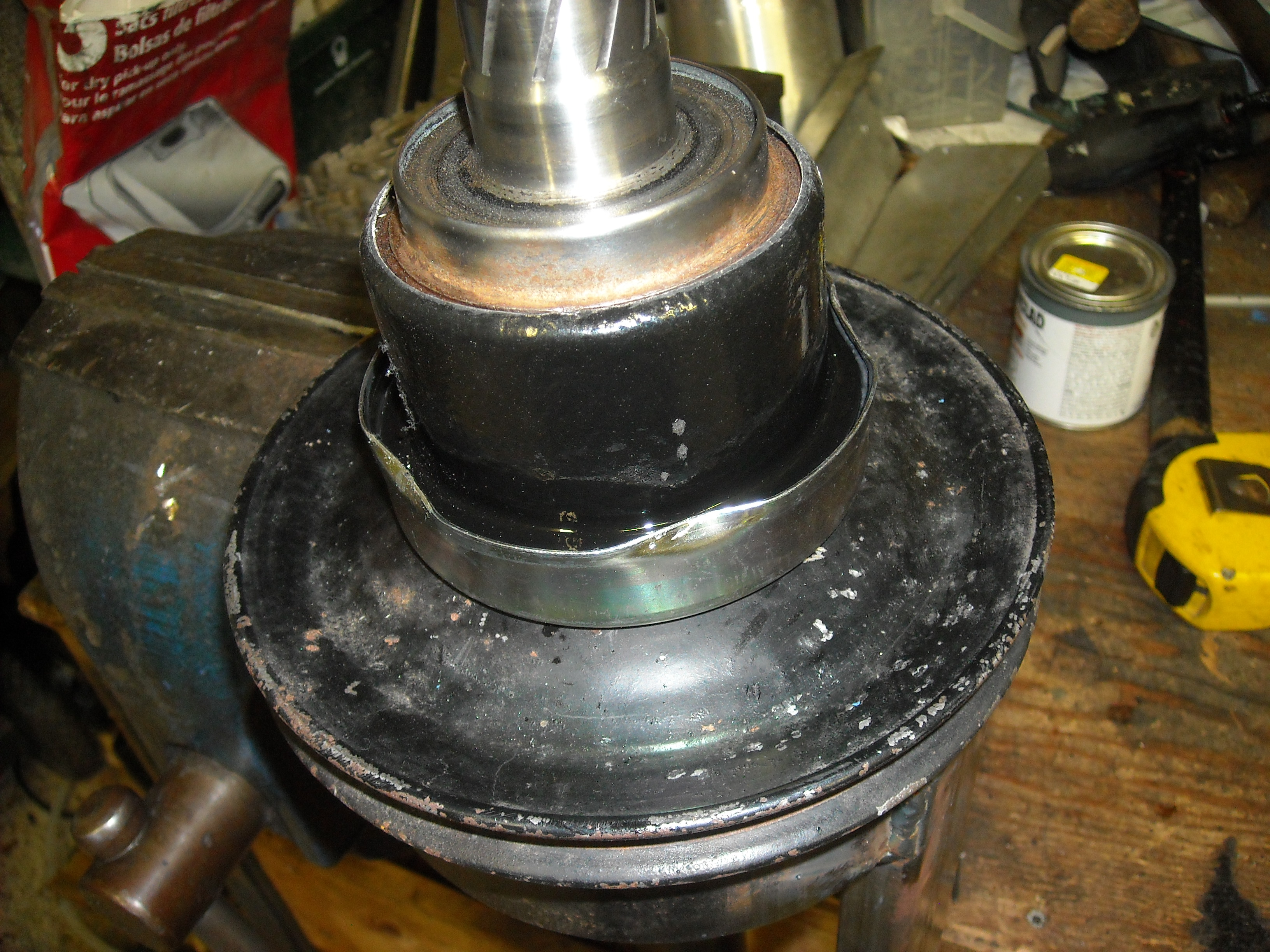

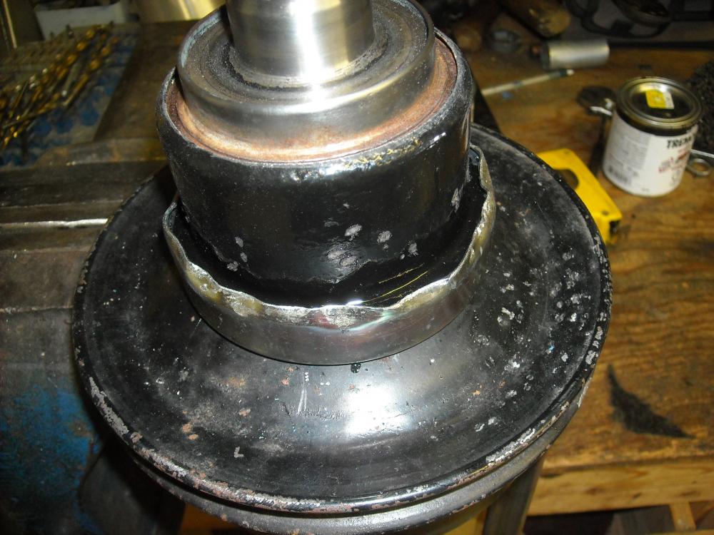

Also, there are 3 internal seals that are no longer available, at least I couldn't find them. If any one of those seals are damaged and can't be reused, stop what you are doing, you can't proceed without them if you want to get long life out of the shafts. If you think bearing grease makes a mess then you are in for a real treat when you start handling CV grease, it's a different animal, like black runny snot from hell. It gets on everything, have lots of rags around to grab easily.

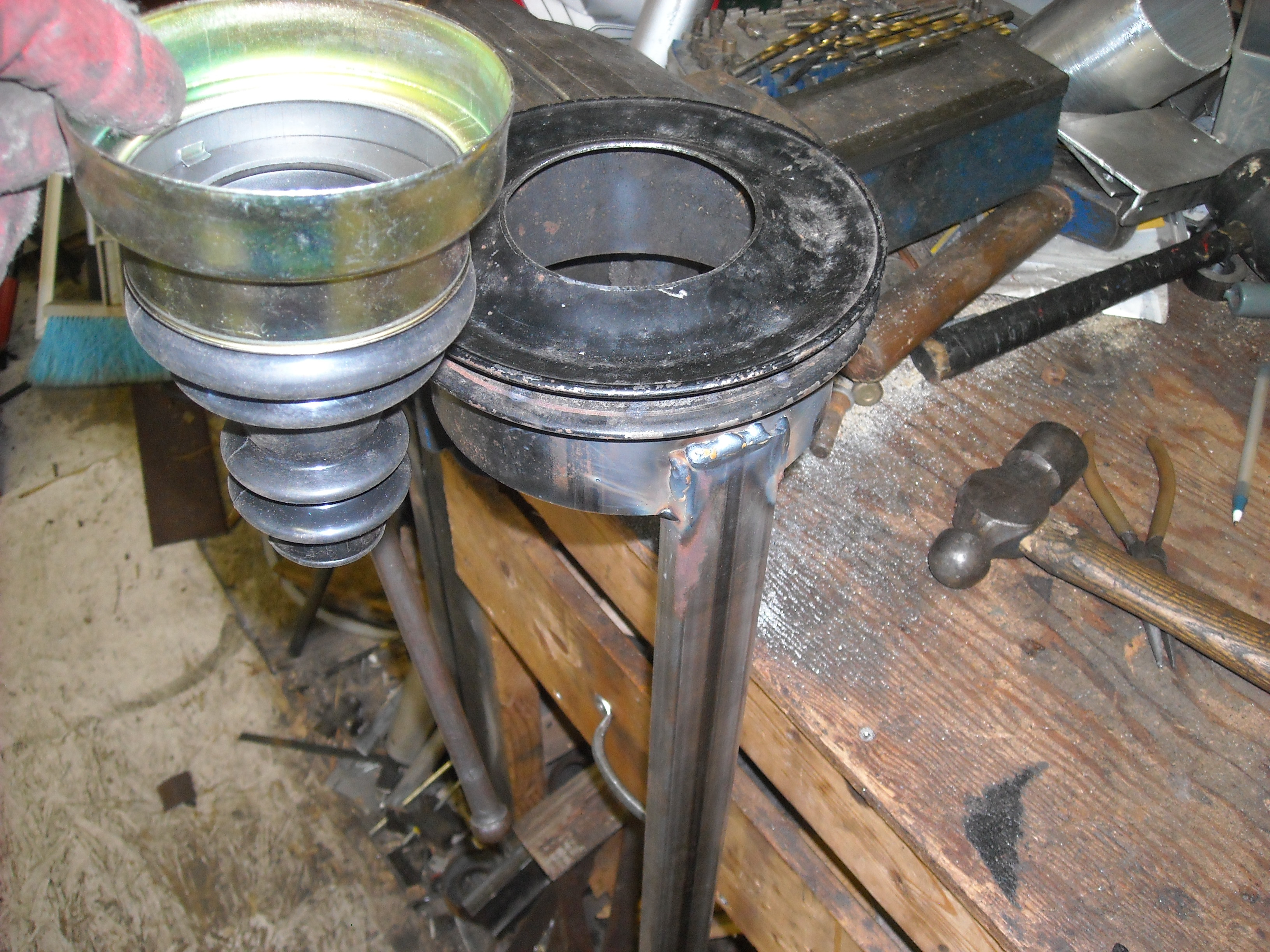

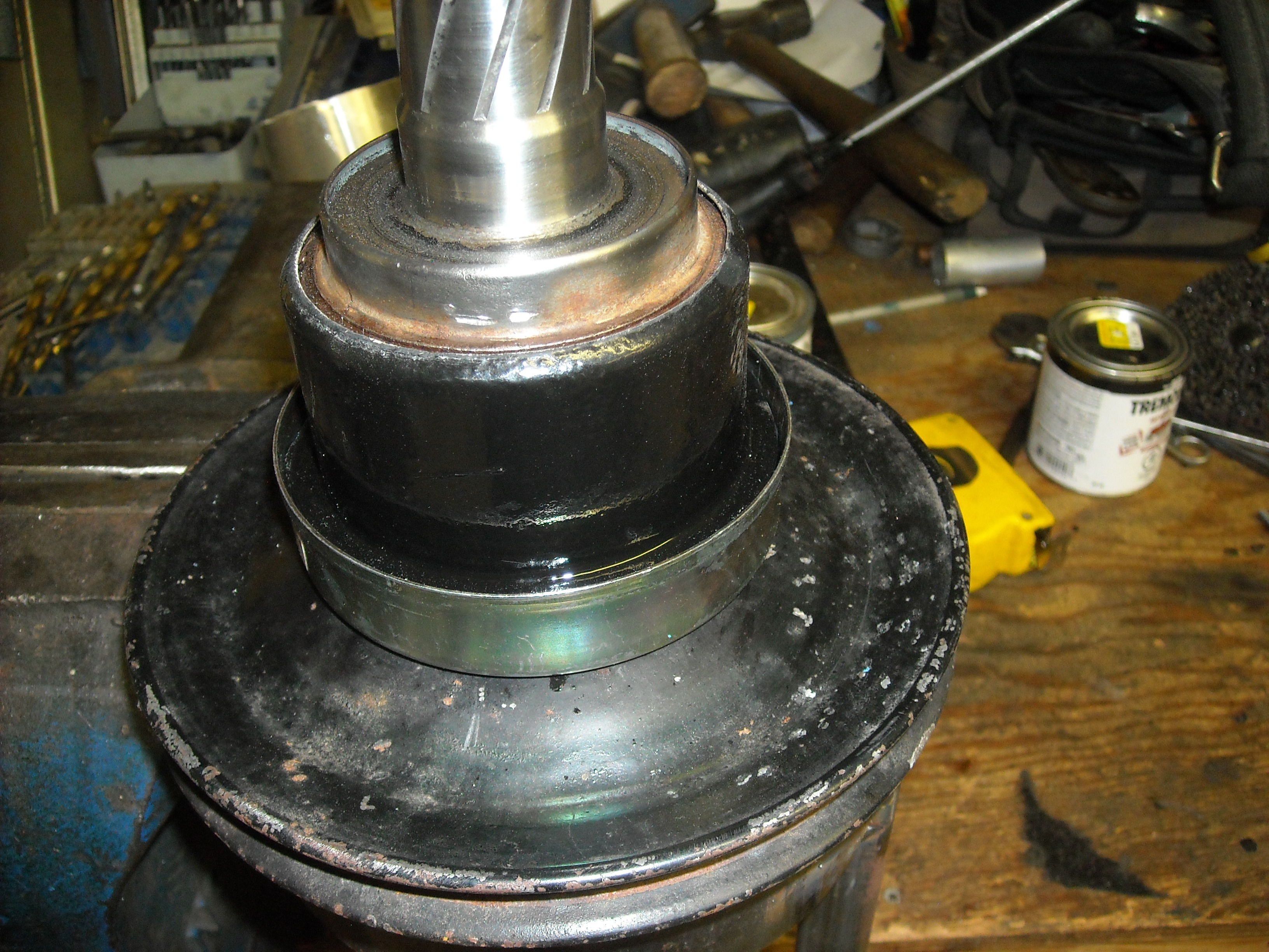

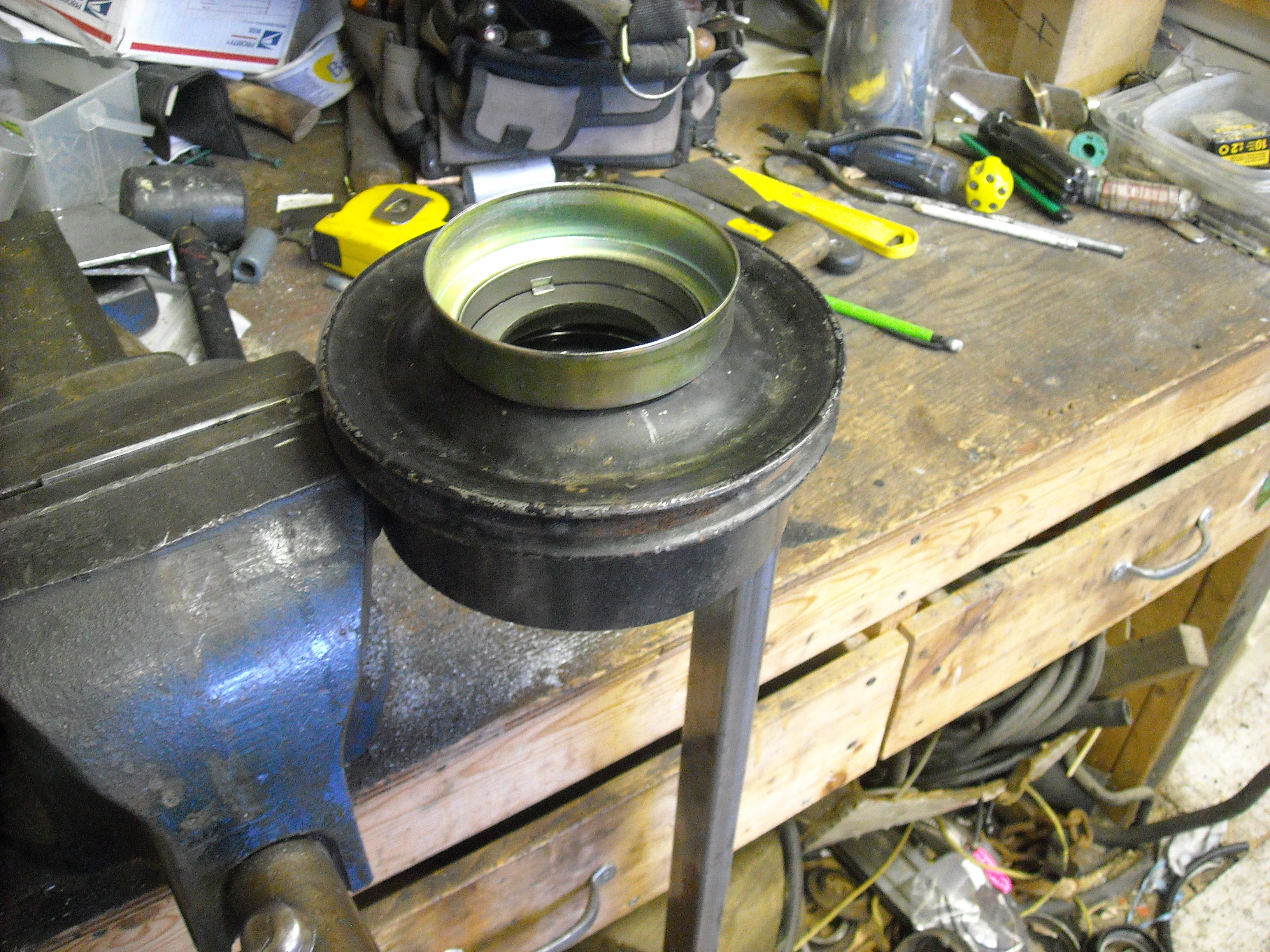

I had to build a stand to support the boot shell so it could have the edge hammered tight around the top, without that stand I can't think of how else I could have completed the job.

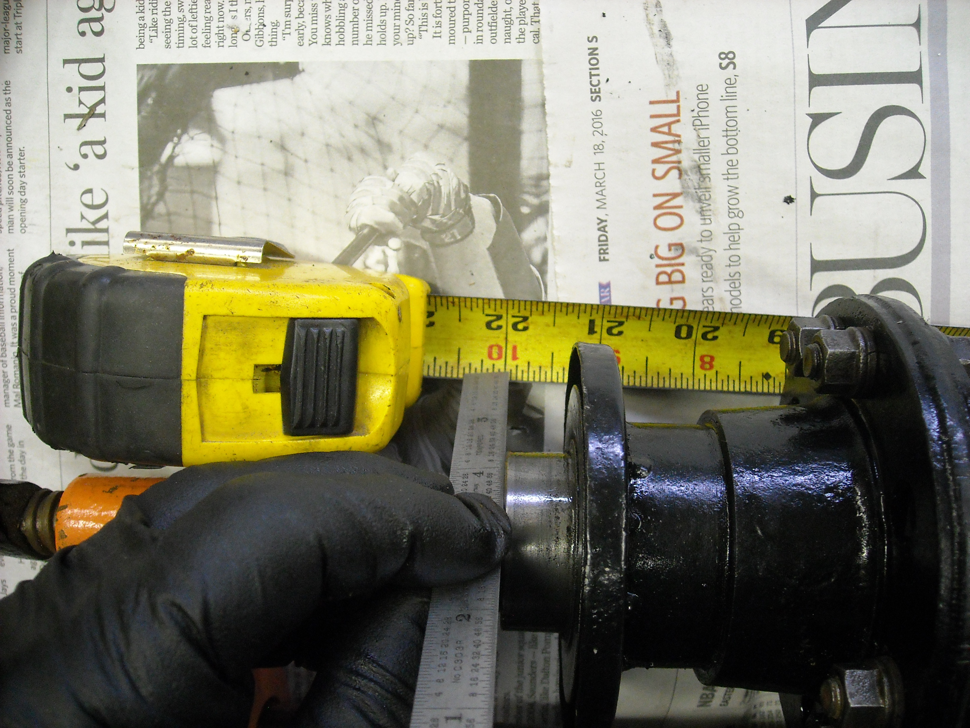

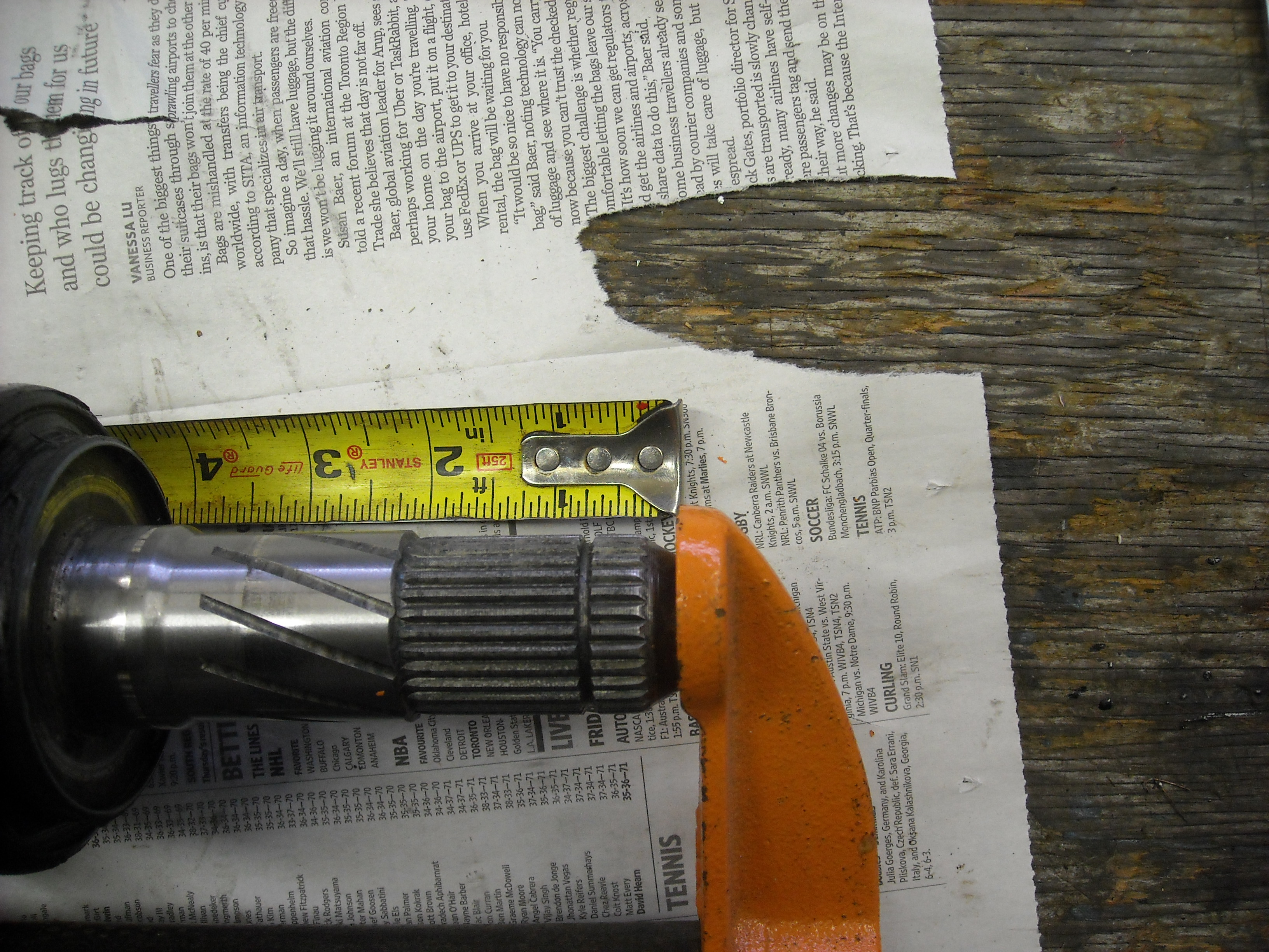

Zed, I tried your trick with the wood clamp to hold the shaft fully compressed, worked great.
D/S 280zxt shaft 22"
P/S 280zxt shaft 22 3/4"
Compared to the 240z shafts with stub axle and adapter flange measured in the same way the P/S 280zxt shaft is 1/2" longer, the D/S 280zxt shaft is 1/8th" longer. I think I can live with that.
