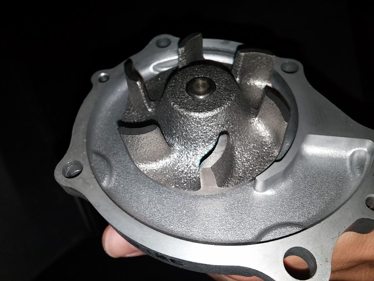

Green AF it will be.Here is the pic of the pump:

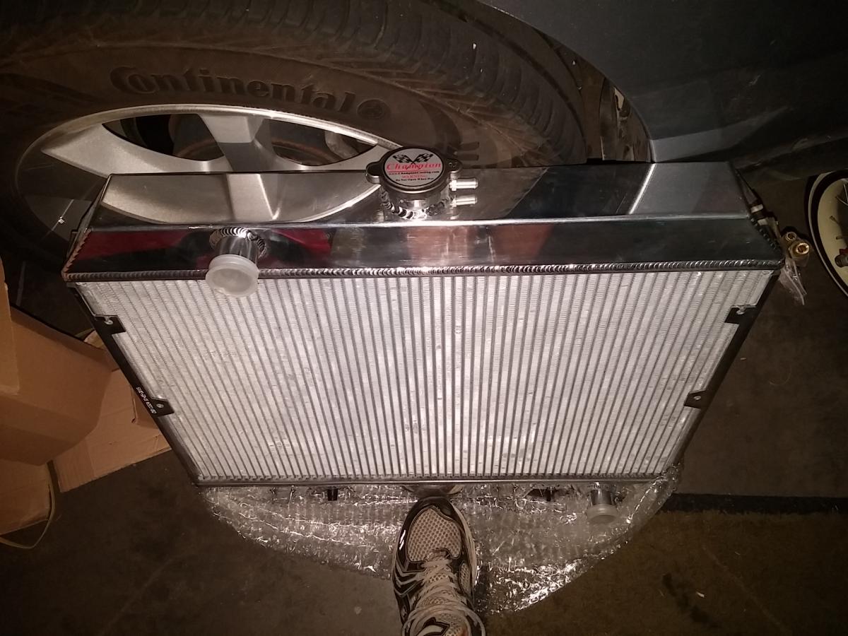

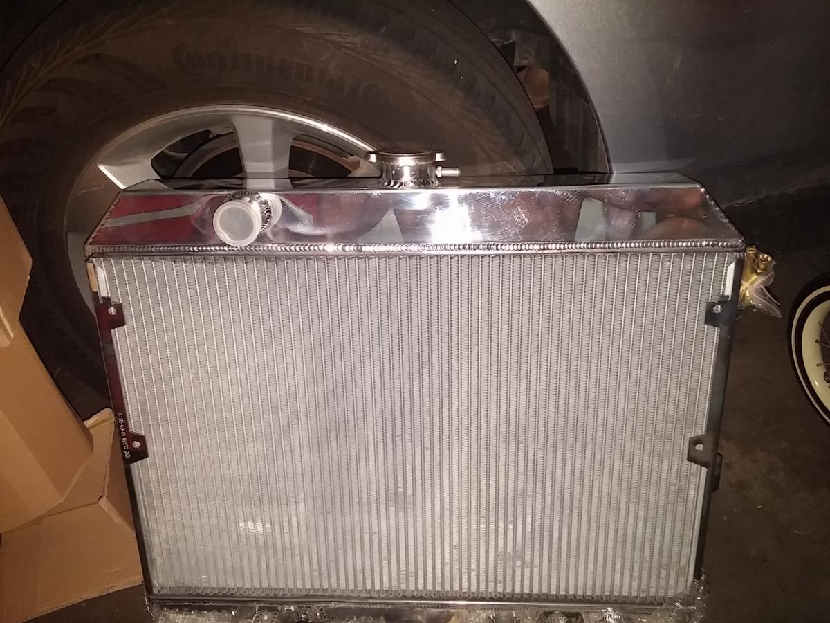

And here is the radiator:

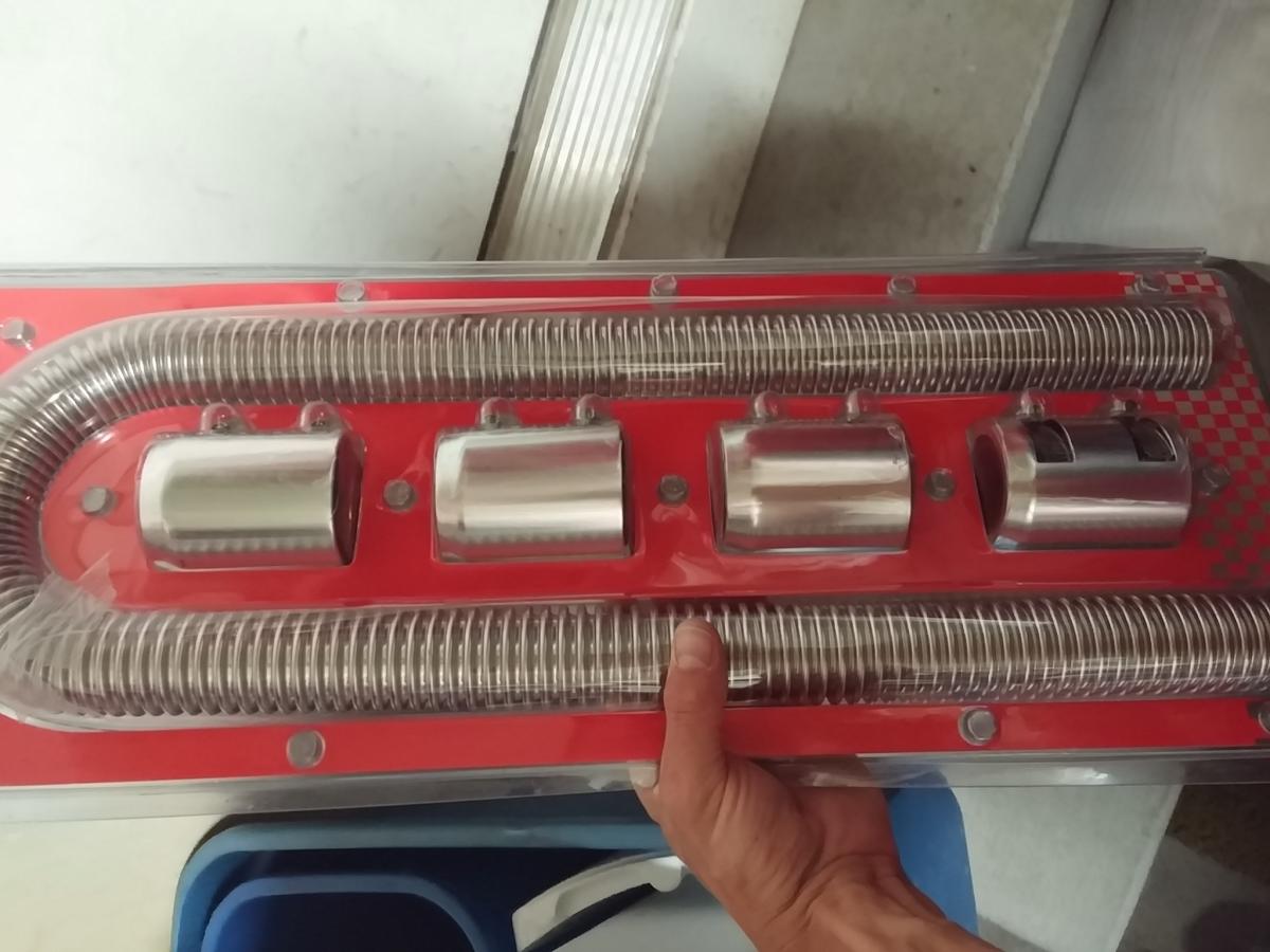

It's even polished! And it  It does have the drain plug at the bottom, which is nice. also ordered this stainless steel radiator hose set, but after seeing in person I'm not sure I'm liking it:

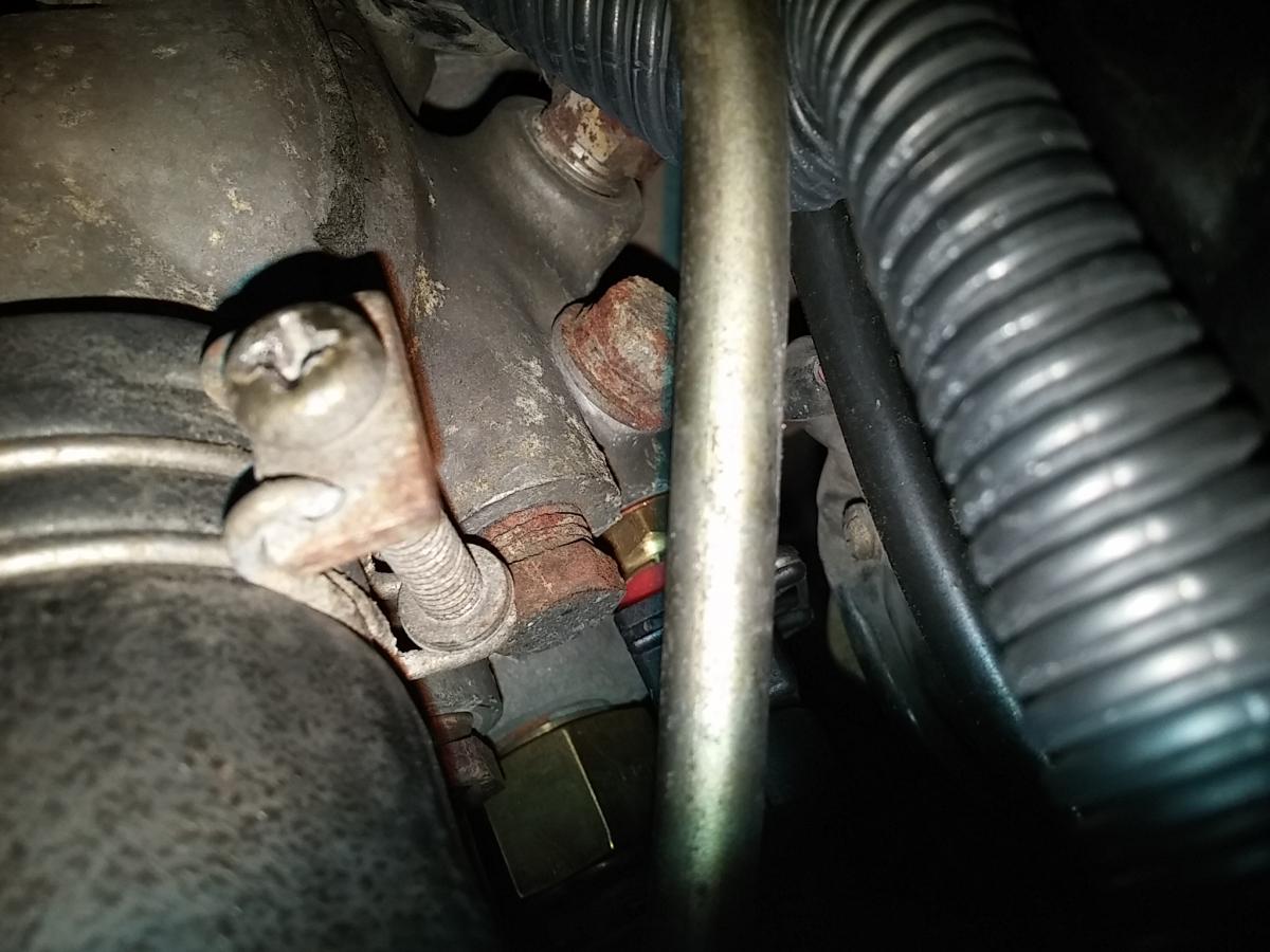

Anyway, so there. Now you know. There is a shroud and fan set for 280 if you are looking for one. I'm guessing it will look very similar to the one on Champion website for 240/260Z. They also sell thermocontorl wiring that utilized thermostat sensor and relay: http://www.championradiators.com/Thermostat_Relay_Kit_185/170. The sensor is actually the type that can be screwed in (radiator hose, thermostat housing, etc) rather than pushed through a radiator.  I did notice that I do have two openings in my thermostat housing that are plugged with a bolt now:
post-30354-0-63133800-1441850914_thumb.j
The problem with that is that I don't know what thread is in my housing and what thread is on the sensor. I have seen some posts on interwebzz where people had to re-thread their thermostat housing to make this work. Not really something I want to do...I also saw people installing special adapter in the upper radiator house that had threaded brass insert to hold a sensor. Fex-a-lite makes this adapter but it cost some $40!!

I have the 3 row Champion radiator in my car.  I've used it for city driving and seems to be doing the job while looking pretty.
