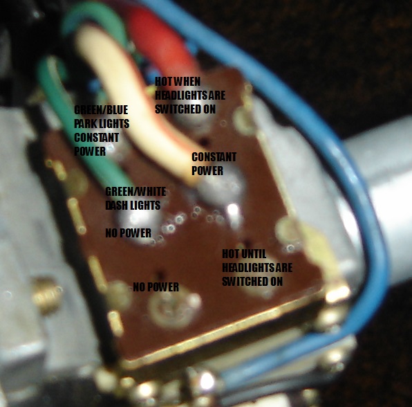

Thanks again for all the advice. I hope to find time this week and next to actually tackle (and learn) the electrical system.
On a side note, the car was still stuttering from time to time and it was not heat related. So, I installed a fuel filter between the tank and the fuel pump. I drove the Z hard today and had no issues, either on the highway or in the city. The filter seems to be helping.
Some small progress on the electrical side of things.
I rechecked the fuses and two of them were no good. One was for the hazard. Now my hazards work (both on the dash and outside on the car) as do all of my gauges on the dash (voltage, etc.). However, the actual dash lights do not work nor do the turn signals (neither on the dash nor outside on the car). So, the only non-working things are all my dash lights and my turn signals (internally and externally). All other dash components appear to be working properly.
Edited by SilverSurfer
Maybe the dimmer switch needs some work.  Squirt some electrical cleaner in it and turn it a few times.  Or you may have to get inside the combo switch and put 12 volts straight to solder spot and see if they light up.
post-23570-0-55103200-1432551339_thumb.j
There's some write ups on the turn signal mechanism, you'll have to search around.  Mine have always worked.
Edited by siteunseen
Good news! Internal and external turn signals are working! Bad news is I am not sure why, actually. After having the front end aligned, and the steering wheel adjusted (it was a custom wheel the previous owner had installed and was all crooked), the turn signals just started working again. The mechanic who had worked on the car previously (the one that did all the engine work) had also done something in that area because the horn had not been working. I am wondering if something, like a connector, had been lose (and maybe still is) and when they adjusted the steering wheel it knocked it back into place?
Dash lights still are not working, but I have not had sufficient time to work through the harnesses, etc.
