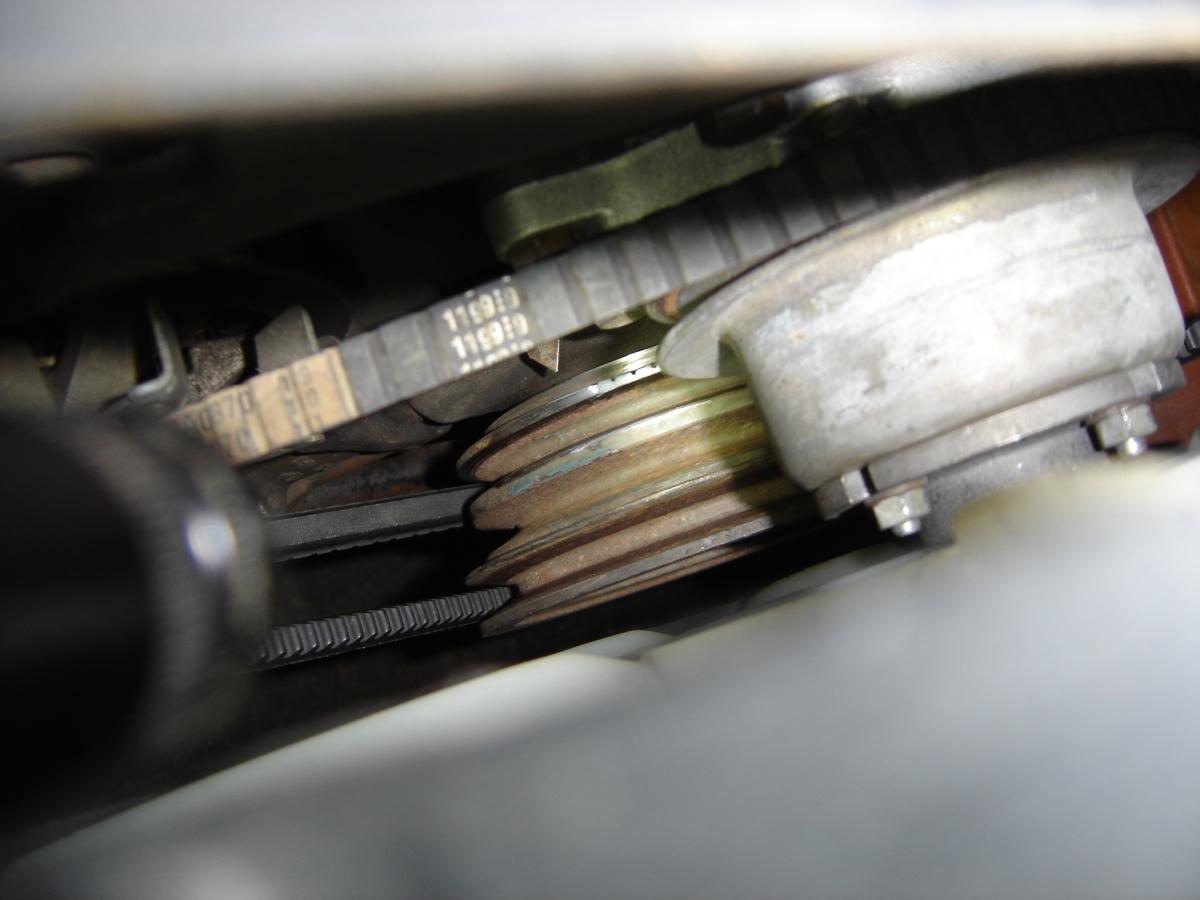

The biggest notch at the far left is 0 on the 240 damper, then 5 degrees for each smaller notch moving up clockwise.  It looks about right compared to mine but like Zed said there is a "perfect spot" for TDC.  I'm thinking with the keyway on the crank it would put any damper at the same position, a 240 or a 280 damper.
The white spot in this picture is past TDC, my timing chain was advanced a tooth or two from the previous owner.  Caused me a big ole headache, never could get the timing adjusted right.  Now I'm rebuilding it.
