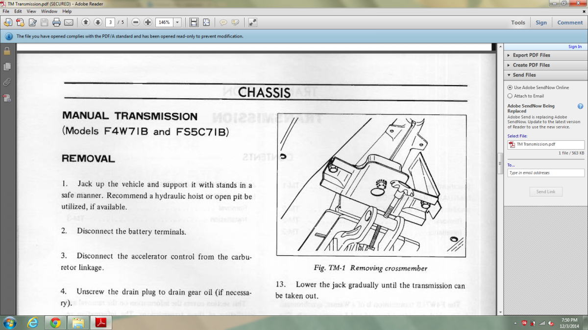

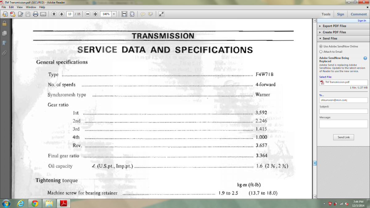

Thanks, siteunseen!
I own Haynes book, but it only refers FS5C71A and FS5W71B. They are different.
And 72 FSM say nothing about how to check FS5C71B transmission. That's why I need specialize literature about FS5C71B transmission.
But thanks again for quick answer! :)
