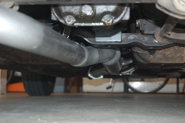

Arne Posted April 14, 2013 Share #2 Posted April 14, 2013 When I built my custom exhaust using a Magnaflow dual outlet at the rear, it was way too loud. I had the muffler shop add a 24" glasspack in the tunnel and that quieted it to a reasonable level. Link to comment Share on other sites More sharing options...
Walter Moore Posted April 14, 2013 Share #3 Posted April 14, 2013 I have the MSA exhaust system that you referenced, except that I also have a header. I never got a ticket for a noise violation, but it was too loud for me. Like Arne, I added a glass pack in the long straight section that fits inside the transmission tunnel. Link to comment Share on other sites More sharing options...
Mikes Z car Posted April 14, 2013 Share #4 Posted April 14, 2013 I had an old GT6 triumph in the 70s that I ran for a while with just the resonator. Even with the small 2 liter engine that was too loud for me, couldn't hear the radio. Did get pulled over once but just got a fix it in a week and there is no cost kind of thing. Before that pull over another cop got my attention as he cruised next to me and pointed to the muffler and mouthed the words "too loud". Link to comment Share on other sites More sharing options...
pbarcher Posted April 14, 2013 Share #5 Posted April 14, 2013 I have the MSA exhaust system too. Much too loud by itself, so I installed a 12" stainless resonator in the transmission tunnel. Much quieter and the drone is (almost) gone.Peter Link to comment Share on other sites More sharing options...

Arne Posted April 15, 2013 Share #11 Posted April 15, 2013 I think that should work pretty well. But bear in mind that - at least in my car - the center pipe ran very close to the left side of the tunnel. I had to have a couple of S pipes added to move the glasspack to the middle for clearance. I'd recommend fitting it as-is first, both to check for loudness, and to know what will need to be done if you need the glasspack. Link to comment Share on other sites More sharing options...
