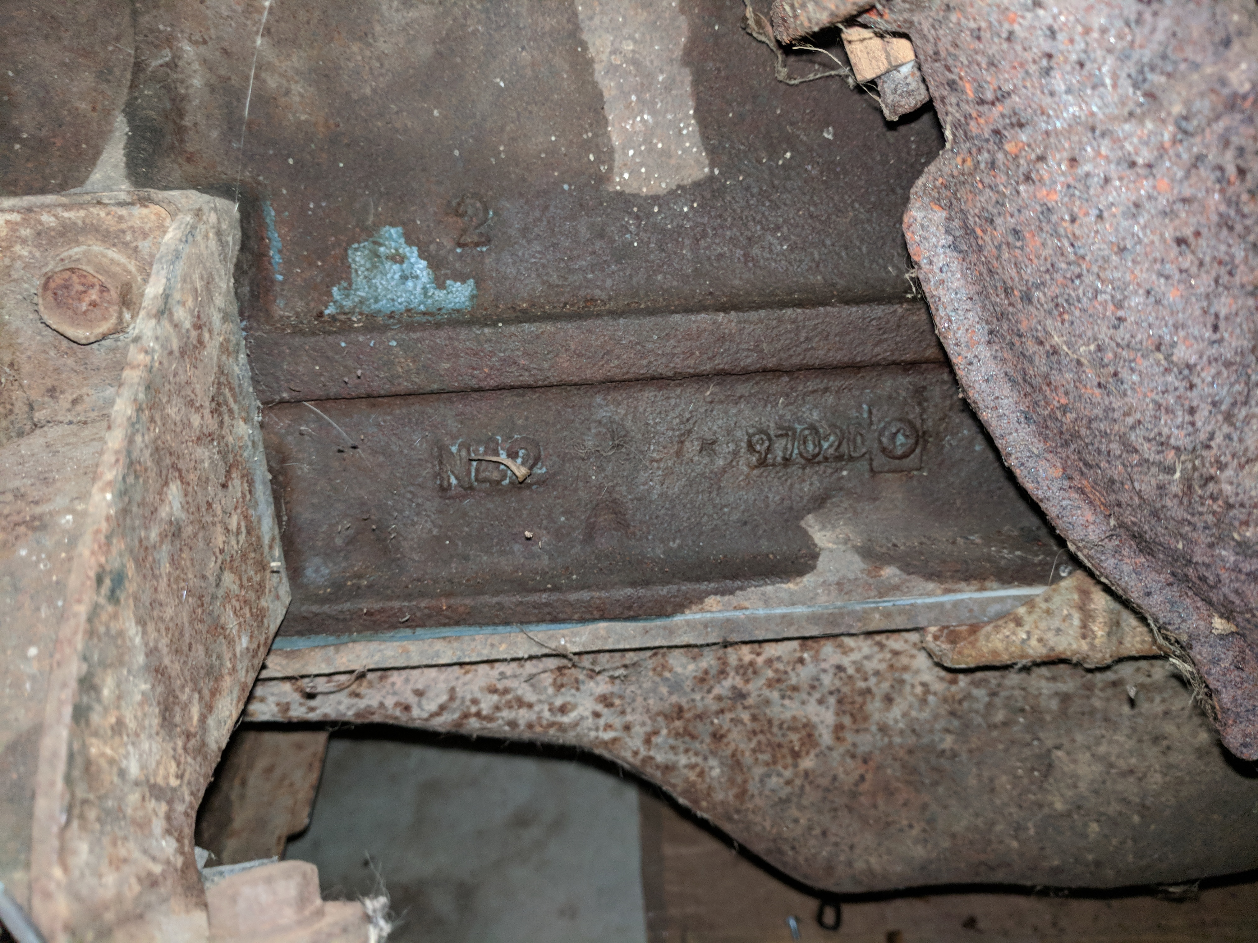

N42 it is

So if I understand this all correctly, that temp sensor + the N47 marking means the head is the (smaller chamber) Maxima head.. and would make this particular setup higher compression than the standard N47 head+N42 block?
Yes.  On an N42 block with the normal dished pistons it raises the CR to about where a ZX engine would be.  But with smaller valves, so not the same power level as a ZX engine.  People use them with flat top pistons to get an even higher CR.  Your engine is probably in fine shape, just not achieving its potential.

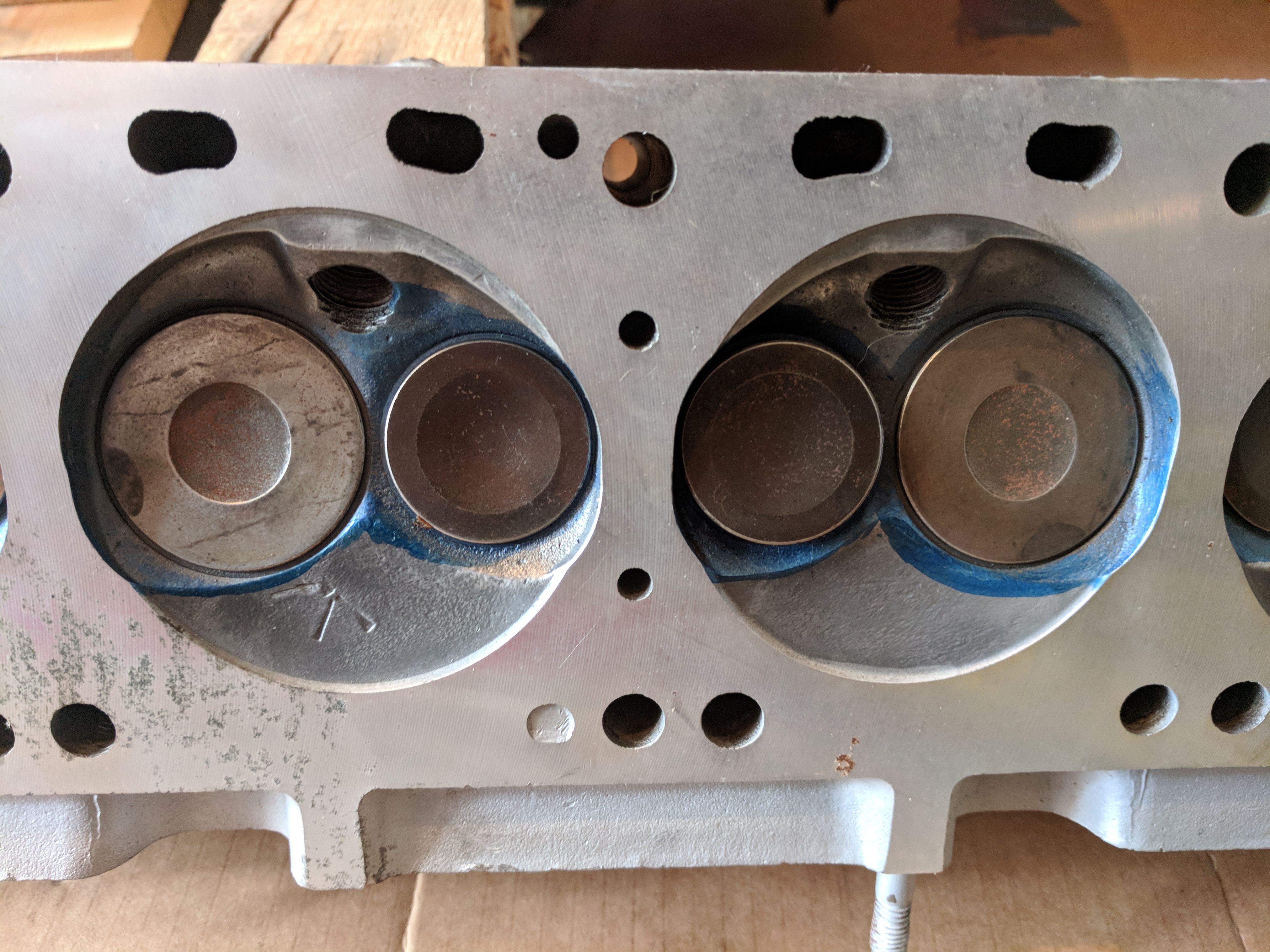

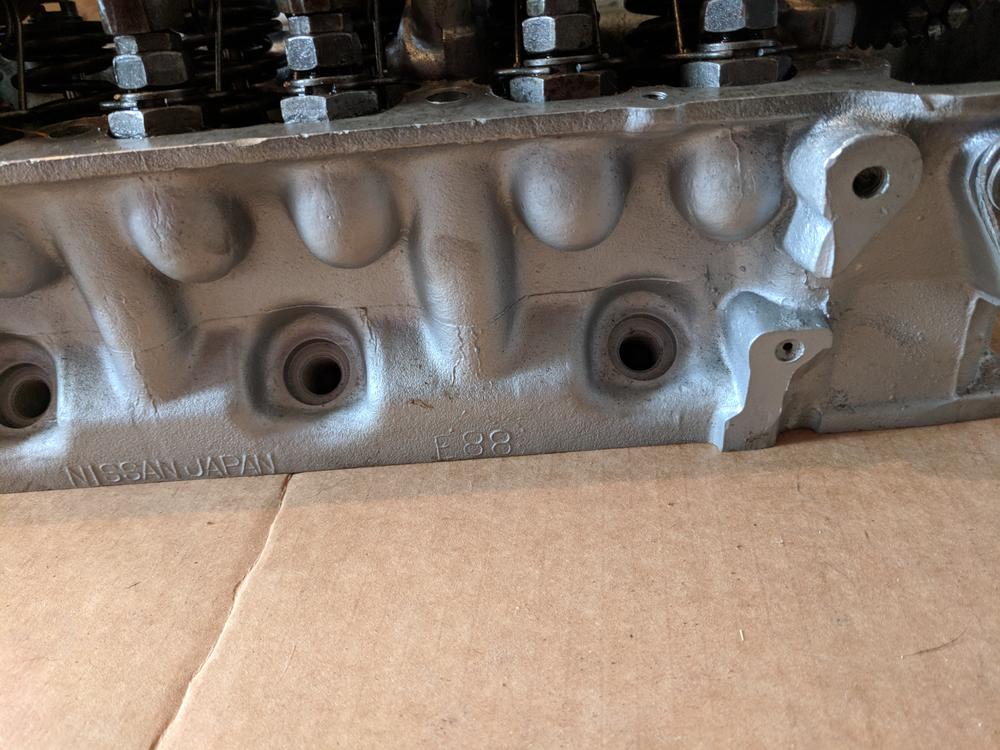

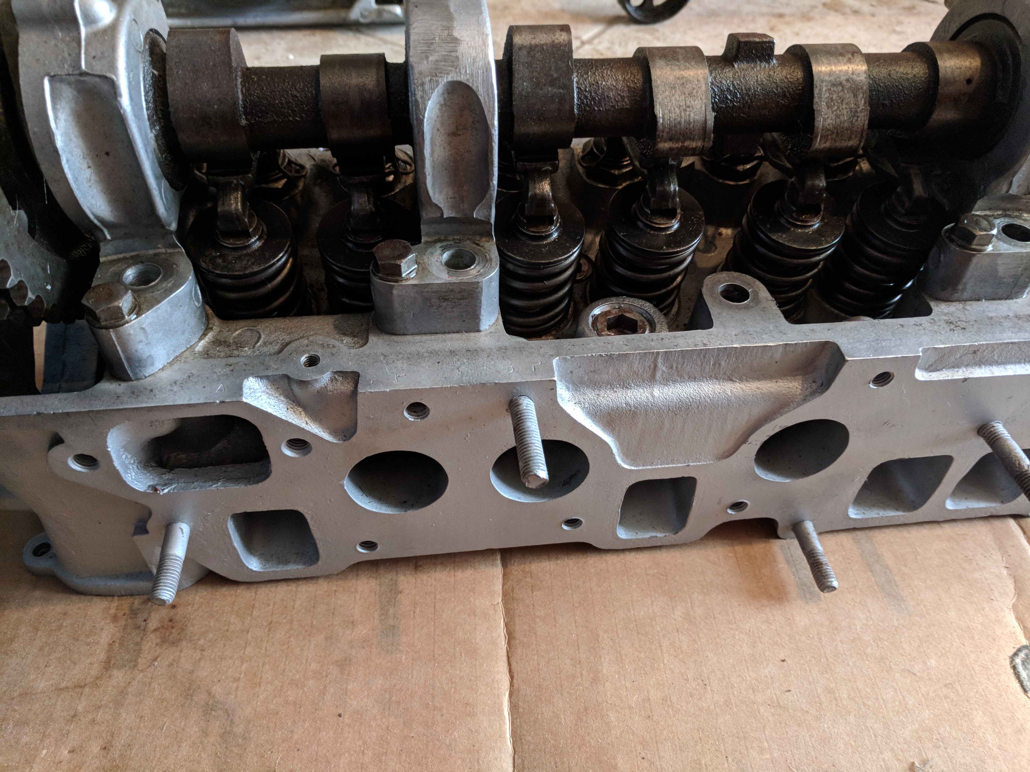

Interestingly, I have another head.  It was supposedly rebuilt by a previous owner, not sure on where/when, but it does look like someone went through it.  Stamped E88, pictures below.  Would yall keep the N47 on there, or swap over for the E88?

Measure the valves on your E88.  It's fairly common for people to put the L28 valves in those heads.  I think that one of them is already at L28 size.  The MN47 valve info is out there somewhere.

1.74 on the intake valves, 1.375 on the exhaust
Edit - apparently it is valve head diameter that you measure.  It's not what I would want to know but it's what is done, apparently.  So your valves are close to L28 size.
Actually, it's hard to tell from the out edge measurements, which overlap the seat.  I think that the number is actually the seat diameter.  Where the flow happens.
1.74 and 1.375 are 44.196 and 34.925, so more likely 42 and 33, stock E88.  A guess.  Not large enough to be L28 though.  I could be wrong.  I forgot about the injector cutouts, so that's a consideration.  I'd just get what's in there running well, drive the crap out of it and see if needs more of anything.
Edited by Zed Head
The E88 onthe noth american L26 had 35mm exhaust valves. I think they increased the size for the tougher californian emmision laws. It also has different chambrs for better emmision, less power. It's often called the emision head when people talk about the E88 head. I think you have basically 3 types of E88 head, one virtually identical to the E31, the "normal" E88 and the E88 on the L26.
Going by your mwasurements, looks like someone already enlarged the inlet valve (1.73), thats if it was of a L26. If it is one of the early ones, they have enlarged both valves.
There is a thread here somewhere with photo's of the different E88 chambers. That could help you work out which head it was.

The E88 also looks like it might have been cut. The casting numbers are pretty close to the edge. Some measurements would be in order there too. Also are the cam towers shimmed on that head?
No shims on the towers on the E88 head.  Whats a good way to measure the head to see if it had been cut?  Or would the lack of shims make that not a possibility
16 hours ago, siteunseen said:
E88 is for carburetors and doesn't have the notch out for fuel injectors.

Is that something that could be machined in there?  Maybe farther down the road I'll have someone work on that head and swap it out.
I think for now I'm going to roll with what I've got and focus energies/monies on getting this sucker on the road.  Still have a looonnngg way to go
By the time you have the notches cut out, bigger valves and seats done to the E88 I don't think it'll be worth the time and money???
I would find and N42 like the '75s came with.  That's a good cylinder head.
